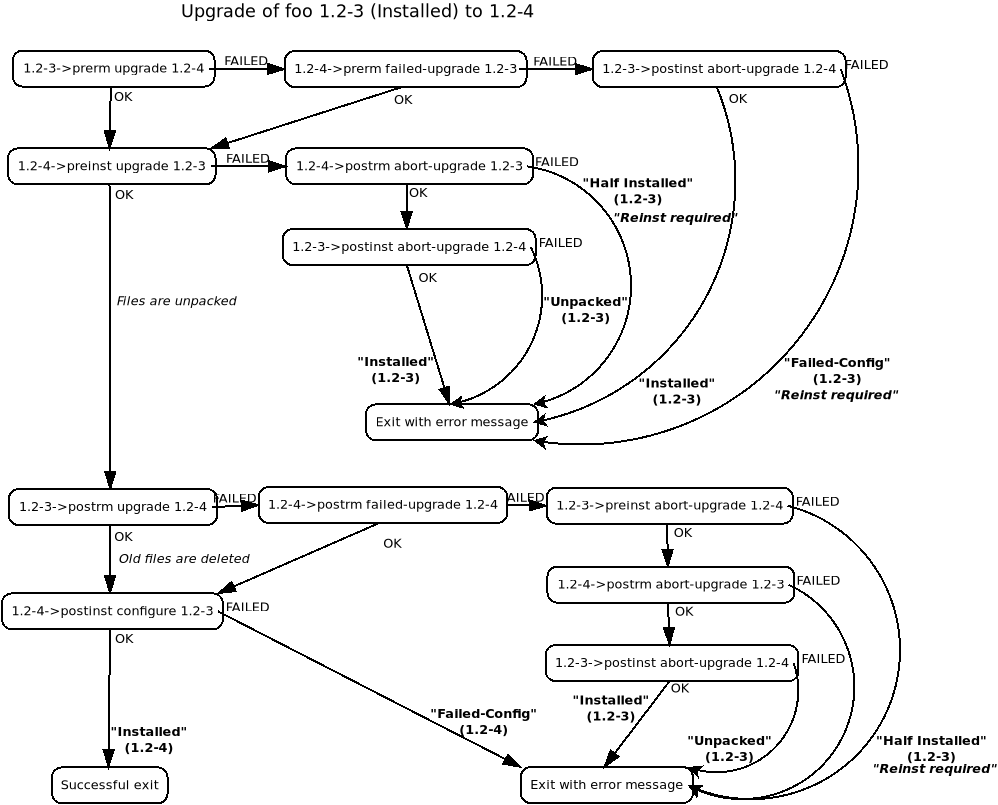

I can tell you more about what happened here and if you keep asking questions I will answer. Just please consider that if you are a beginner, this is not the most friendly topic to start nor is it the most useful because situations like this will hopefully never happen again. To give you an idea of how complex this topic can become consider this graphic:
You started at the upper left at “1.2-3->prerm upgrade 1.2-4” because you are upgrading a package (the kernel). The prerm script was OK so you go to “1.2.4->preinst upgrade 1.2-3” and because of a bug in linux-base, that step FAILED so you go to “1.2-4->postrm abort-upgrade 1.2-3” which also FAILED so you are getting an error and the package is left in the state “Half Installed (1.2-3) Reinst required”.
