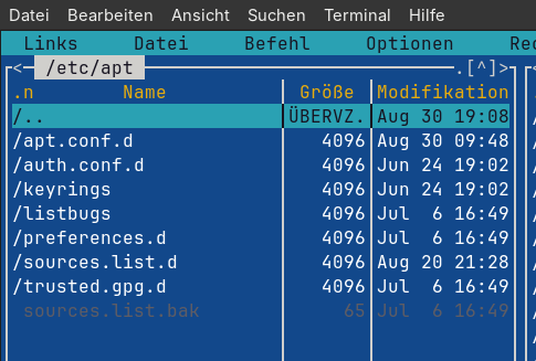

Do you maybe have installing recommends by default turned off? Maybe you have the logs from when you installed cups in your /etc/apt/history.log* and can figure out what exactly got installed at the time when you installed it?
It seems that this file does not exist. At least, I did not find it in /etc/apt.
Indeed, I missed that detail. It must be a CUPS config issue, I’m less versed in troubleshooting this so I will defer to others. It should just work over the network if CUPS is configured correctly and there is no unusual network setup.
Shoot, sorry, I mistyped. I meant /var/log/apt/history.log*. Finger memory must’ve made me type /etc/apt/... XD
