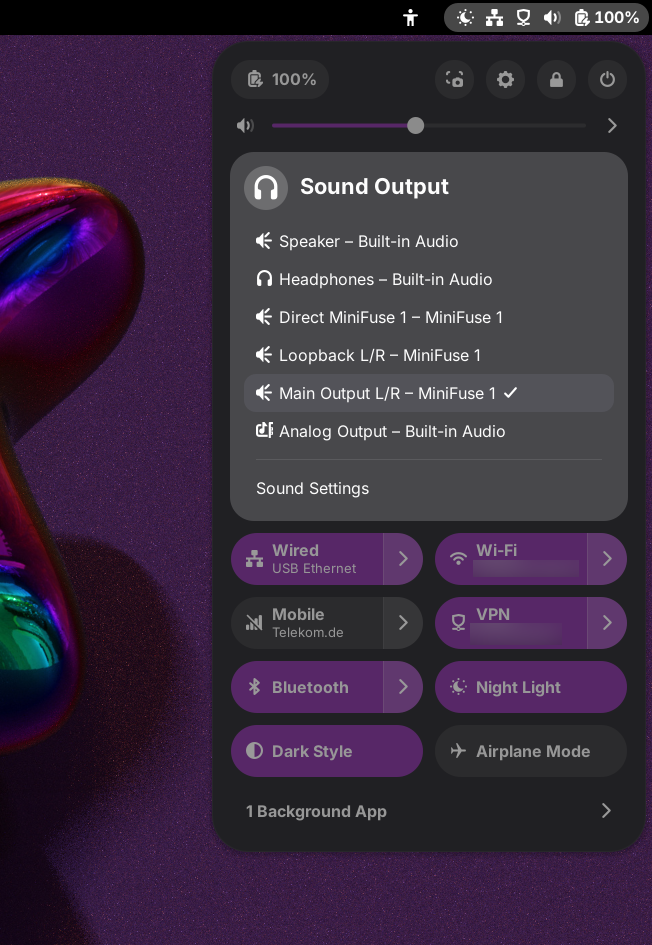

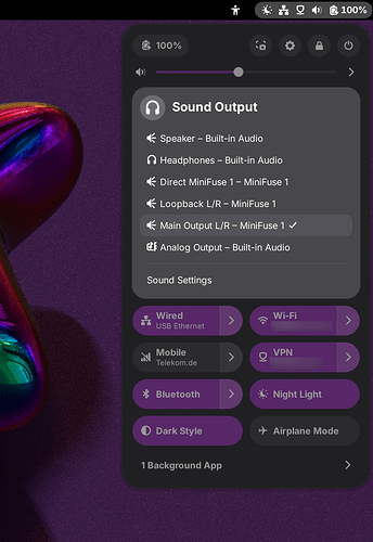

Thank you! I brought up your script today in IRC and minute showed me that this can be seen as a “sway issue” because Gnome apparently has buttons to switch between headphones and speakers:

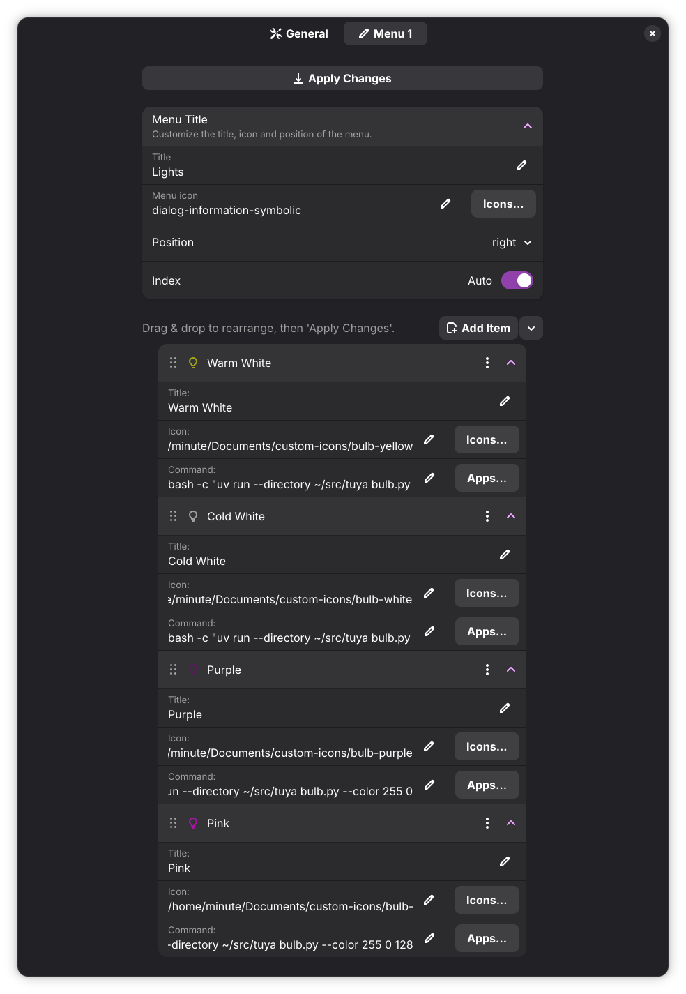

And then I thought that as a sway user I guess what I wanted was your script but as buttons in waybar. It turns out gnome has “custom buttons and dropdowns” as well:
I tried to get custom buttons to work in waybar via the “custom” widget a while ago (I wanted a Lock button to trigger swaylock) but couldn’t quite figure it out.
Having that option to run custom commands from a widget button or customizable popup menu would be awesome.
