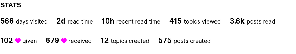

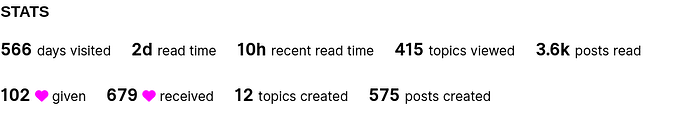

trust level 3… me neither
So according to the above, I might just be missing the “given 30 likes in the past 100 days” requirement for trust level 3. That requirement seems quite arbitrary. For small communities, 30 likes is a lot. I’ll not go around and like every new post just because i want to raise my “trust”…
I’ve now marked your post as a wiki post. Have fun! :slight_smile:
