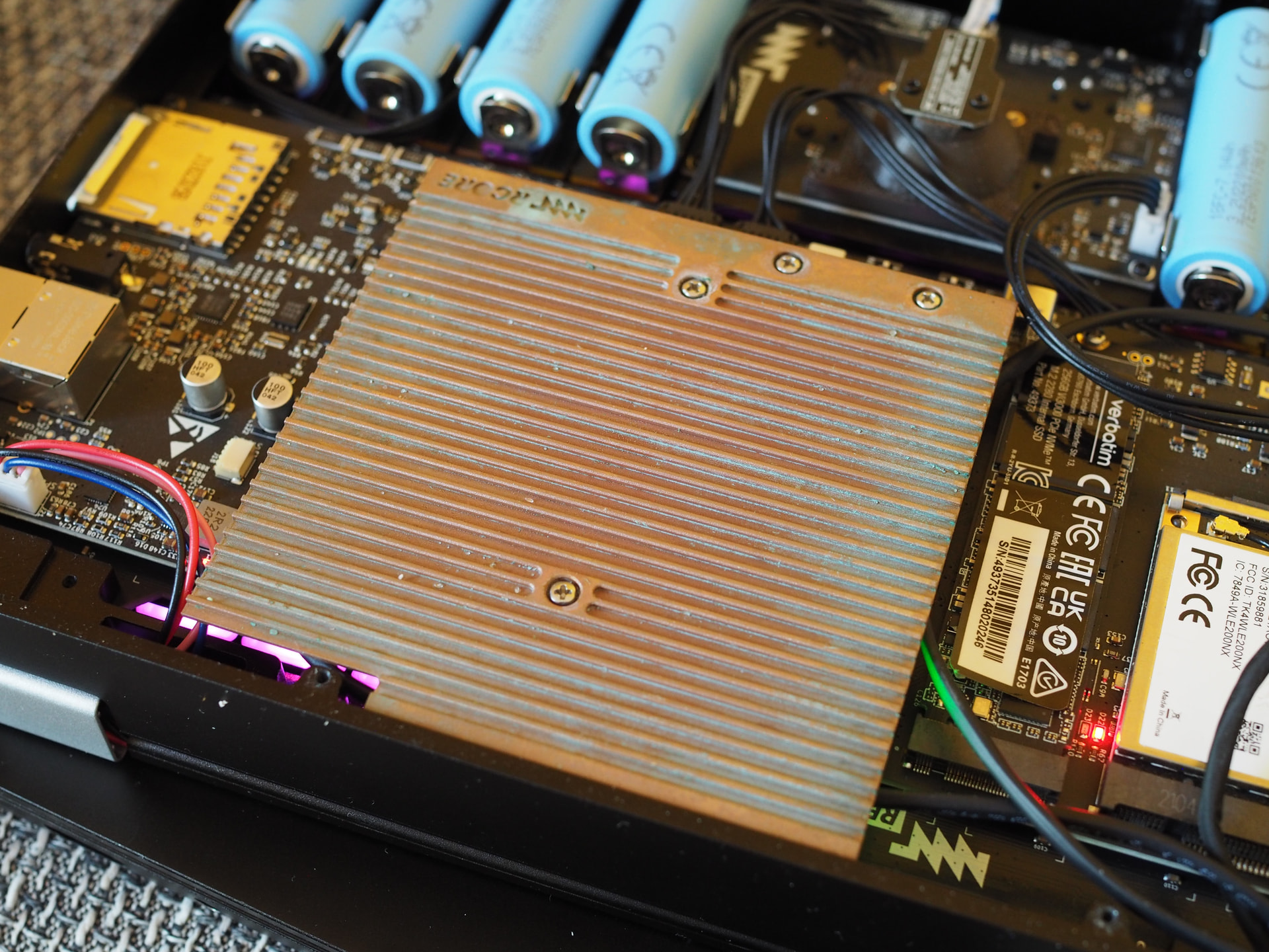

That’s great, thanks. just was a bit confused by the heatsink being completely flat, I’ve never seen one without fins or at minimum, ridges.
For those who are curious, this is how the copper heat sink can end up looking after some while:
that’s the sort of heatsink I was expecting, with ridges to increase surface area (since there’s no space for actual fins). That’s why I didn’t make the connection between the metal plate and a heatsink (though the mention of copper was further confusing) and asked for clarification. A completely flat piece of metal doesn’t make me think ‘heatsink’ straight awa,y because I’ve never seen one like that. I can understand that it will work to a point, since the intent is to absorb heat, and the surface area is simply to aid radiating it to the surroundings.
