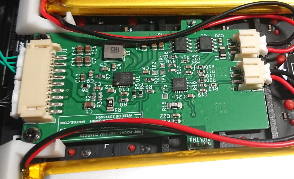

I’m sorry to report that I’ve experienced this issue again: plugged in my Pocket Reform to (a brand new) Anker A2343, smelled a sudden faint smell of burning, and the system controller became totally unresponsive. On inspecting the charging board under the rear case I can see a bubble in one of the ICs. I’ve already reached out to MNT support, but I’m reporting this here because I have a suspicion that it’s related to the specific interactions between the Pocket Recorm and the charger, and I would recommend avoiding the Anker A2343 it for now. I ordered a UGREEN charger instead.

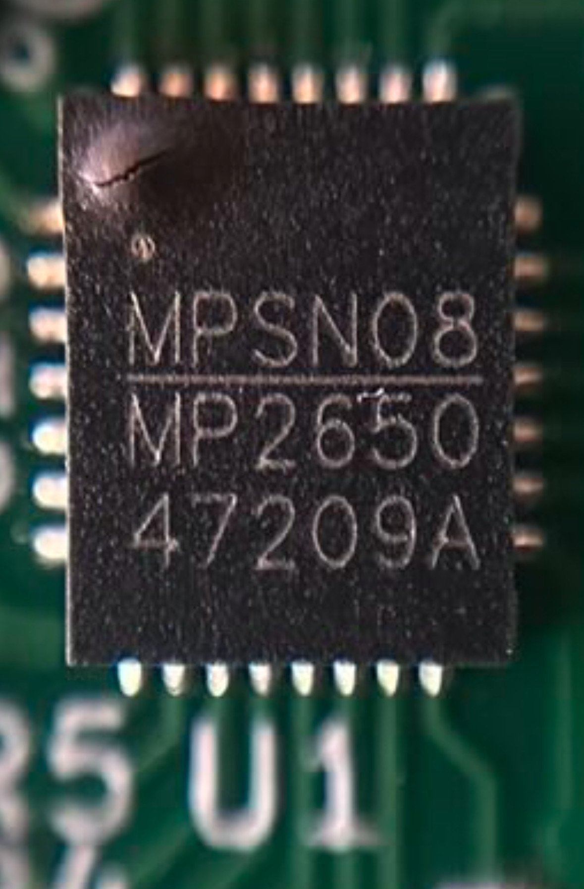

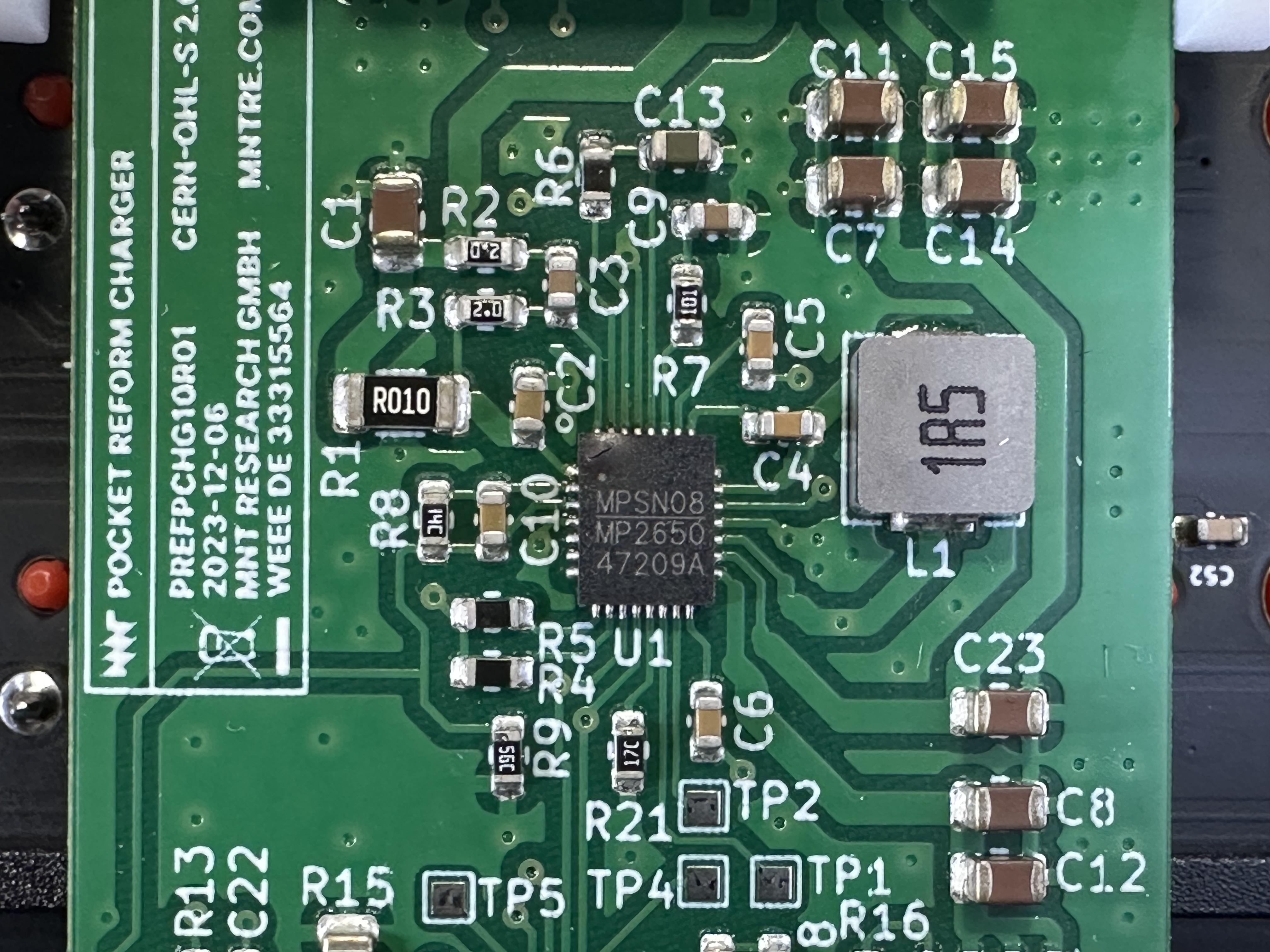

I would recommend inspecting your charging board to see if it seems to be the same issue as mine. Both times for me the MP2650 (U1) was visibly deformed. If this is the case your best bet would be a warranty replacement of this board.
Good advice, although the boot problem also occurs without the charger board connected (USB-PD powered only), but I inspected the charger board and in particular the U1/MP2650 chip more closely.

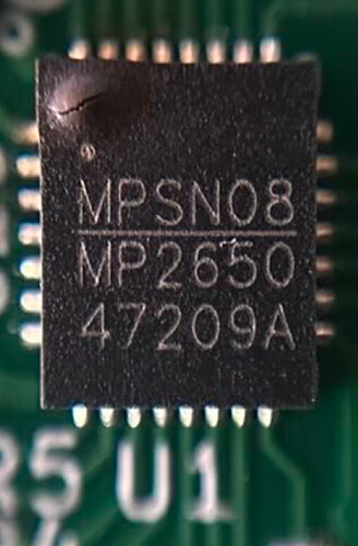

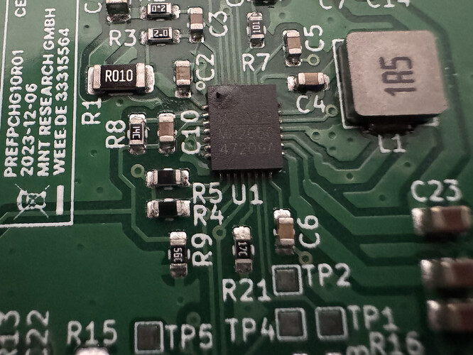

I would say the pictures show that the chip is not running to specification, right? The one in the photo, top left of the chip looks like a cracked bubble.
Yes, that’s almost exactly how mine looked, down to the placement of the little bubble. Contact MNT support for a replacement. Out of caution I might recommend using a different charger, too.
