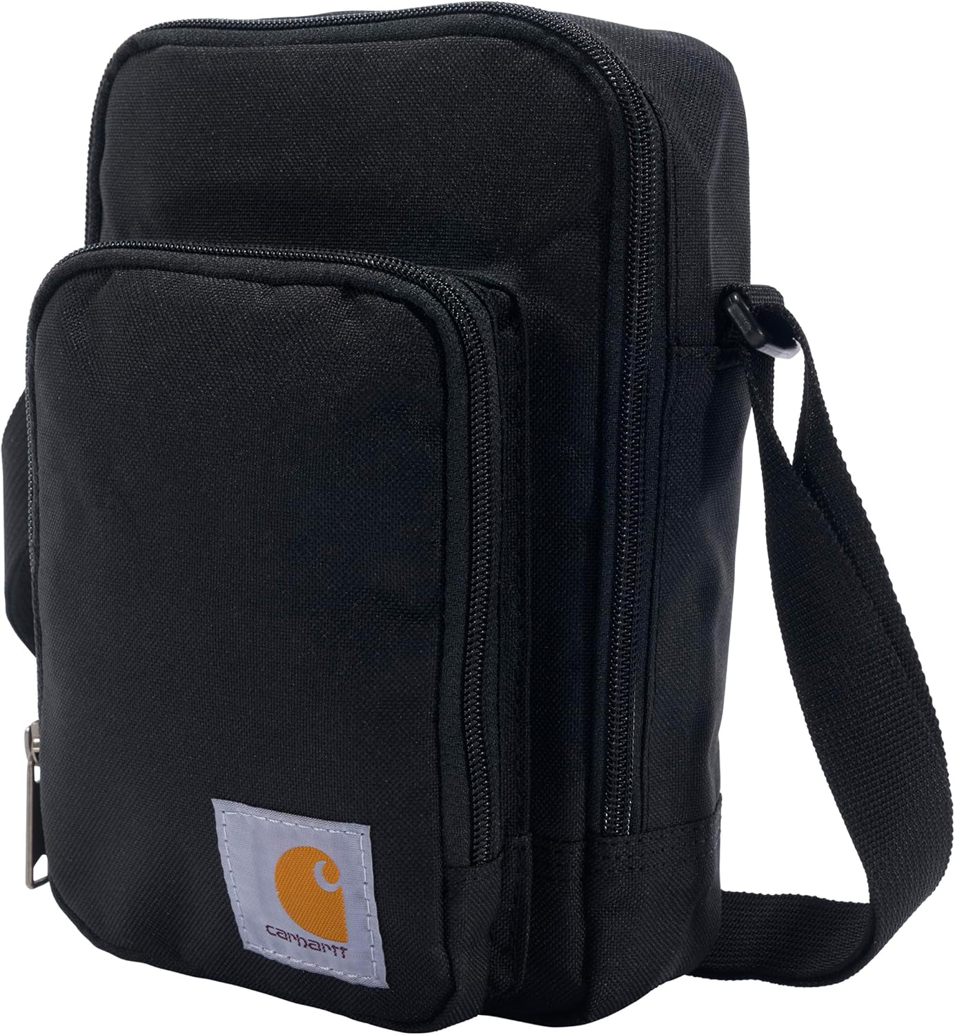

I’ve found a couple more things:
Carhartt CB0511 Crossbody Zip Bag
Fits like a glove! And can hold a charger in the outside pouch.
