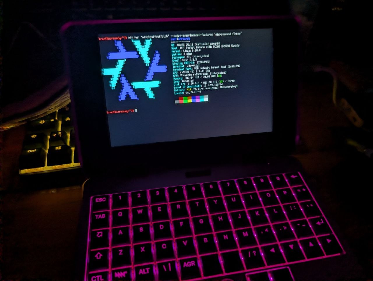

Yay, I got it working! :cat:
Will post the needed hardware configuration soon :slight_smile:
oh wow this is amazing! I would definitely be interested to try an install if someone is working on releasing a build of this!

Lets fucking goooooooo, I typed this post on my NixOS Pocket Reform. I love this device so much already <3
I know what I’m doing tonight!!
update: It worked! I haven’t done much other than boot into NixOS after installing, but the instructions were mostly clear enough. There are a couple duplicate kernel modules listed, though :slight_smile: . I’ll update again when I attempt to stitch my existing nixos config into this install.
update 2: started porting my existing config over piece by piece. got my sway config working and had no issues whatsoever!

Hi @MartiniMoe , @jevans, @leif – I’m having some trouble building and flashing the nixos-hardware image. I’m on a pocket trying to flash this and it builds… but everytime I try to boot from this image it fails to boot (I just get a black screen for >1h). I’ve tried this with both dd && sync as well as etcher. Would you have any suggestions for this, or could you lay out precise steps for this part of the instructions?
Currently, I’m having trouble just building the flake stated in the README, so I had to pin everything to 25.11, which got past this error. Maybe you could send along a flake/flake.lock/result? Here’s the flake I’m working with
  inputs.nixpkgs.url = "github:nixos/nixpkgs/nixos-25.11";
  inputs.nixos-hardware.url = "github:nixos/nixos-hardware";
  inputs.flake-utils.url = "github:numtide/flake-utils";
  outputs = { self, nixpkgs, nixos-hardware, flake-utils, ... }:
    flake-utils.lib.eachDefaultSystem (system:
      rec {
        packages.default = packages.installer;
        packages.installer = (import "${nixpkgs}/nixos" {
          configuration =
            { config, pkgs, ... }: {
              imports = [
                "${nixos-hardware}/mnt/reform/rk3588/installer.nix"
              system.stateVersion = "25.11";
          inherit system;
        }).config.system.build.image;
Then I flash with the following:
$ sudo dd bs=4M of=result/installer-image/nixos-image-25.11pre-git-aarch64-linux.img if=/dev/sda conv=fsync && sync
What is the serial output? Does HDMI work?
Thanks for the response @leif ! There’s no HDMI output. I’m also now testing this to the reform2 because I noticed the derivation pulls in the rk3588-mnt-reform2-dsi.dts, but I guess it doesn’t make a difference, given the user reports above. I’m having trouble getting any output on the serial console, though, so I’ll have to report back after I sort that out.
Hi there @sam
I just noticed, you confused if= and of= in your dd-command! Is that just switched in the forum post? You need to have the img-file for if= and your micro-sd-card for of=.
Besides that, I do not have the flake.lock anymore used to build the installer image. But I still have the installer image itself and just uploaded it to my Server. So if you want, you can try that image: https://static.martini.moe/nixos-image-26.05pre-git-aarch64-linux.img
Hope we’ll get your Pocket up and running with NixOS soon :hugs:
