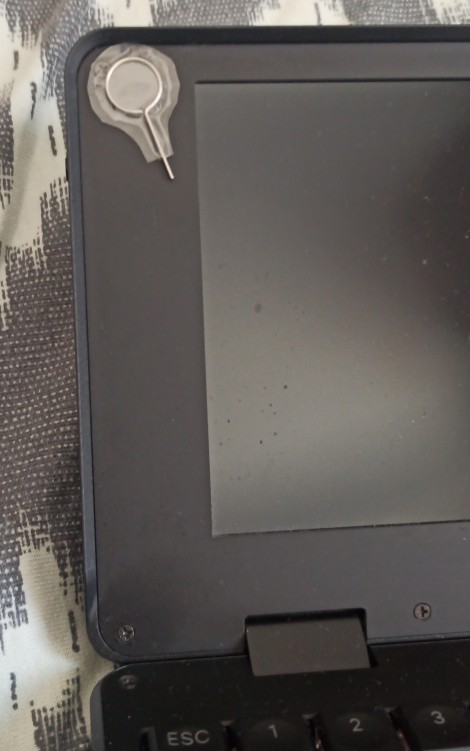

Do you flip the standby switch when you don’t use it? Like do you carry a toothpick around or what, hehe!?

I’m using a sim card tool like this, put celofan around to not scratch the Pocket. It holds with the own Pocket magnets.
