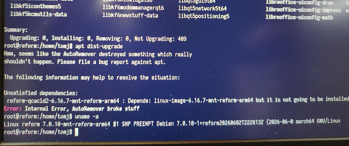

I went a couple of months without upgrading the system, successfully did apt update, upgrade, a few bug warnings that did not seem worrisome. Update completed and it reboots fine.
But a subsequent update/ugrade reveals 409 “Not upgrading”, which I think implies a new distro, or maybe sources changed?
apt dist-upgrade complains:
"Hmm, seems like the AutoRemover destroyed something which really shouldn’t happen…
"Unsatisfied dependencies:
reform-qcacld2-6.16.7-mnt-reform-arm64 Depends: linux-image-6.16.7-mnt-reform-arm64 but it is not going to be installed"
I confuse. Any hints?

Are you still booting with kernel 6.16?
Screenshot says 7.0 so it’s probably a matter of removing old kernels. I also doubt it’s imx8mp in that classic Reform, so I’d say remove reform-qcacld2 too.

EDIT: autoremove solved the problem. I guess old kernels are still installed and so apt wants to keep them updated? No matter, don’t want them.
