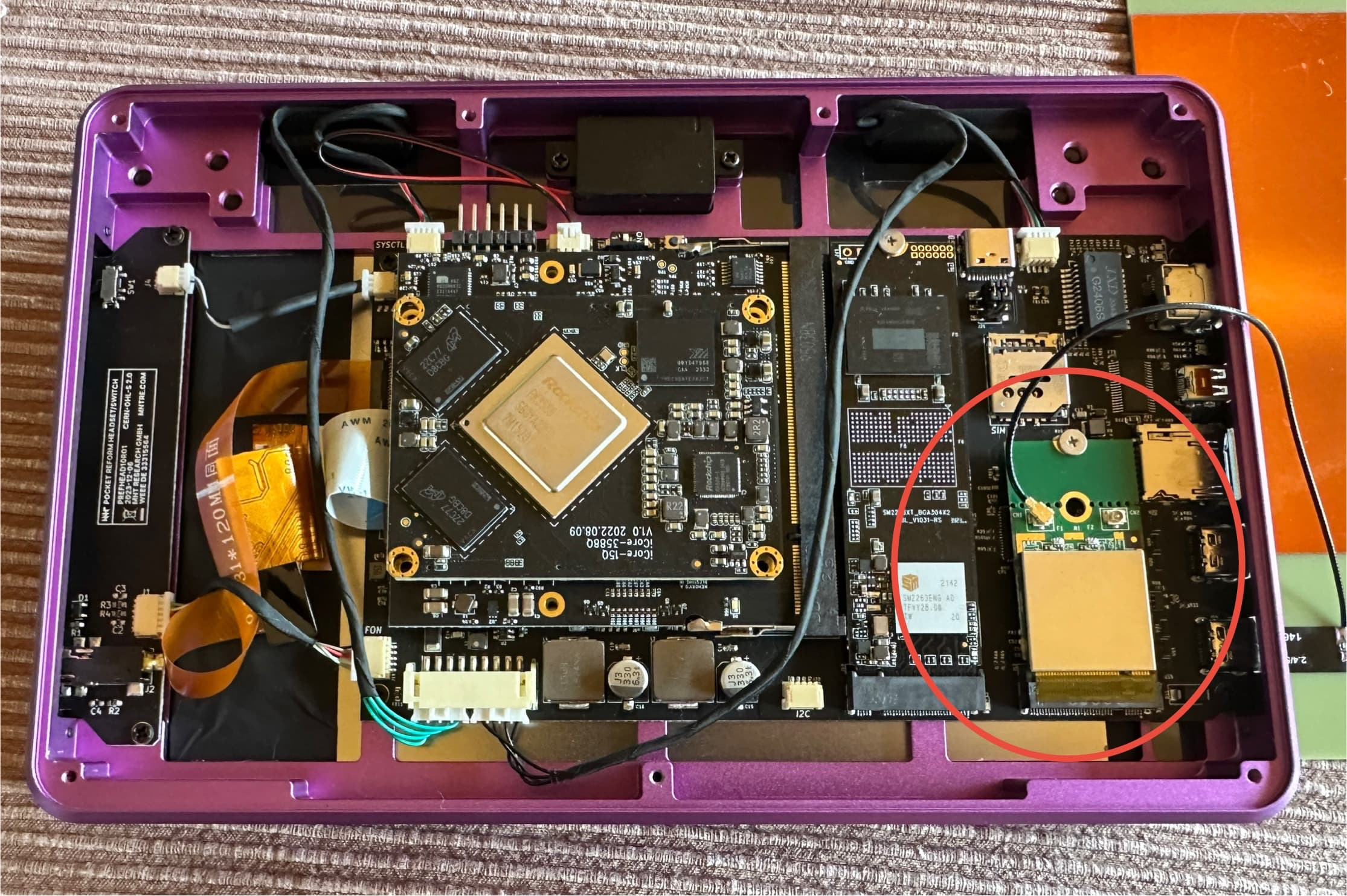

I got it fully assembled with an RK3588. I set it up using the setup wizard to use GNOME. GNOME is here, but I don’t have an option to connect to Wi-Fi. From my understanding, there is Wi-Fi included, right (the description page states “Intel AX210”)? It also shows that I have no Bluetooth which is also provided by the Intel AX210 from my understanding. So I assume the module is not activated in some form.
Running lspci I get two entries for the RK3588, and one entry for the NVMe SSD controller. I would assume that Intel AX210 should show up here. Right?

I find it strange you don’t see an entry for the intel card on the lspci. Can you open the back of it and check if its properly connected?
Thanks for the hint! From the handbook, the circled component should be the wifi card, right? It looks properly connected to me :thinking:
omg, I removed and re-added the component and now it works. Really loving the open hardware / repairability from day one :heart_eyes: I’m connected to wifi now <3 Thanks, @istar :person_bowing:
Hi, awesome you got it to work, and glad you like the machine! Your Wi-Fi card is the USB version, that’s why it shows up in lsusb, not lspci. The Intel Wi-Fi/BT card was introduced only in the middle of June 2025 and is included by default only in orders placed since then (I think June 12 but need to look it up again).

Note how the circled card is just a tiny bit off-center on its screw, the fingers at the end are rather visible, and the fingers on the right of the image have a slightly longer reveal than the fingers to the left. This card is not quite seated to the bottom of its socket, and is slightly askew. That’s probably why removing and re-seating it fixed the problem! This is an easy problem to have with M.2 cards, their tolerances are rather tight and often the sockets have a fairly specific angle at which full insertion is easy and comfortable.
Thanks for the description, @elb :+1: After re-inserting it I definitely saw a difference :slight_smile:
