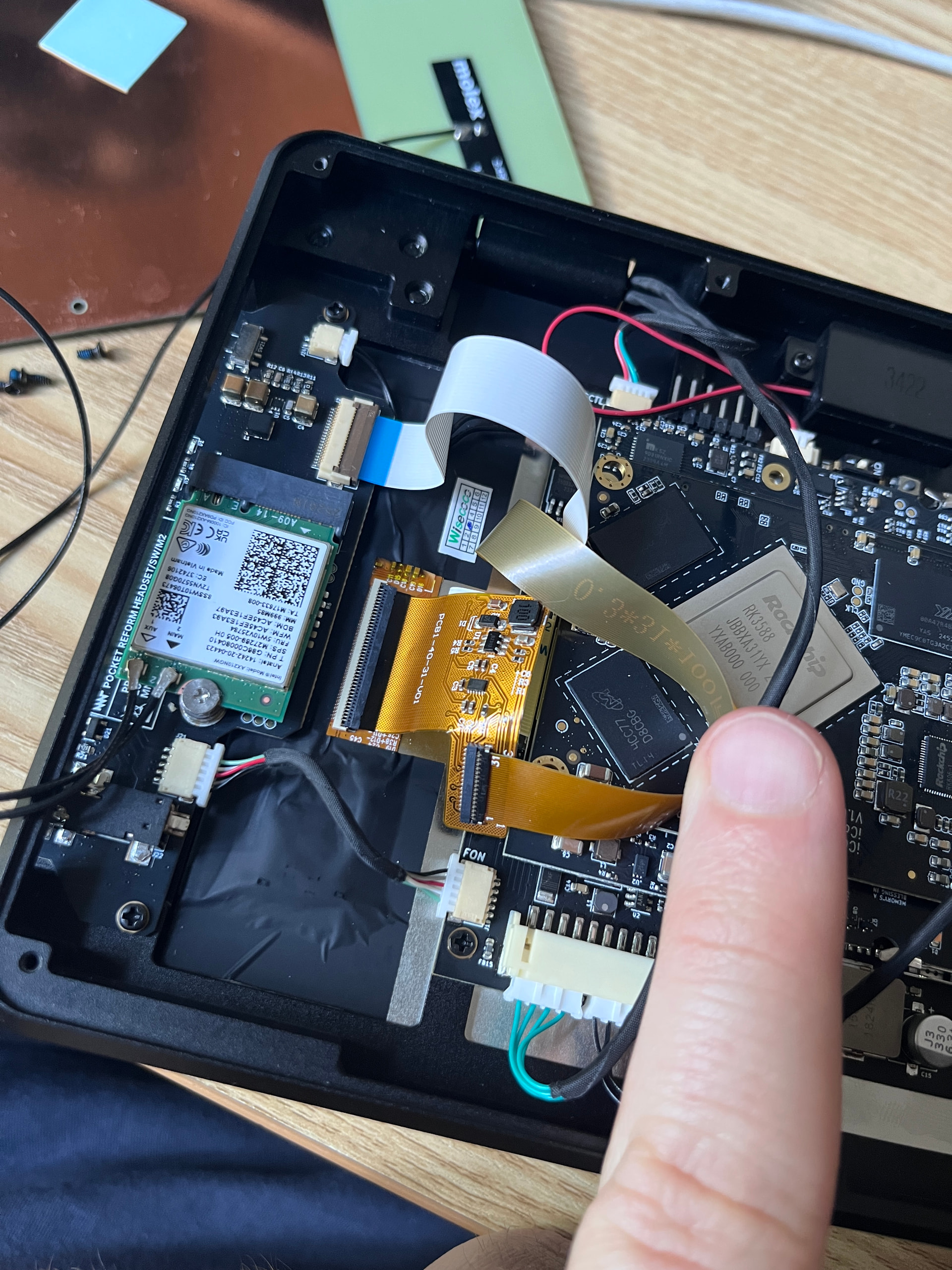

EDIT: Of course 10 minutes after posting the post I realized the small cable was upside down! Very confusing, I thought you should match 1 and 31. But now it works prefectly :smiley:
Hi!

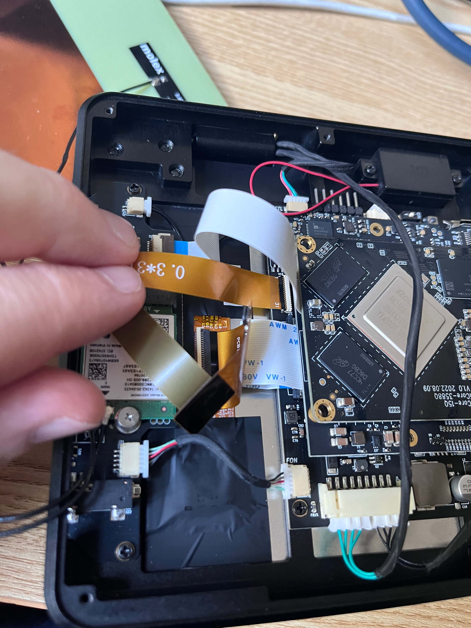

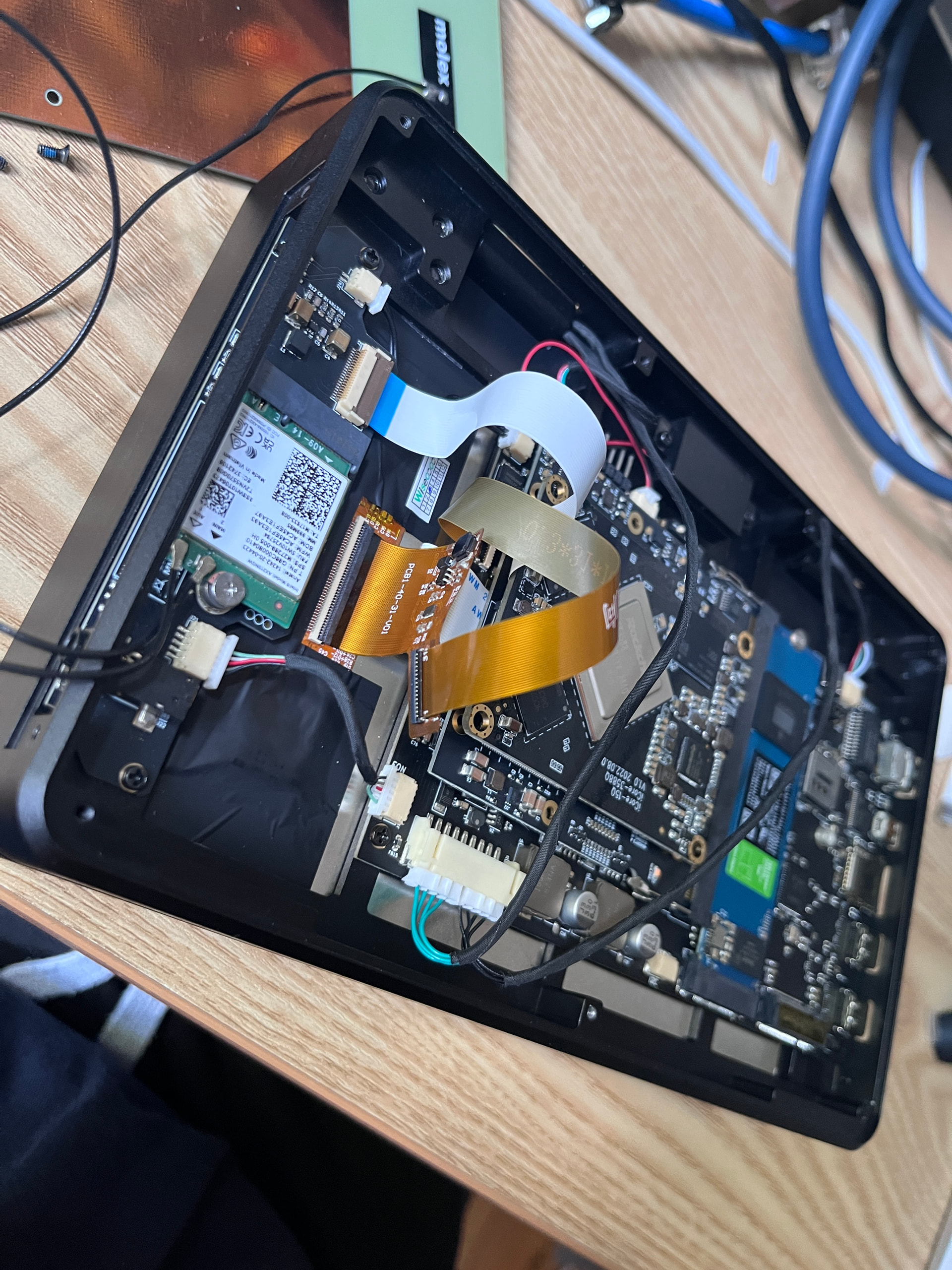

I just built my Pocket Reform kit but I can not get the screen to work. It boots, and if I boot it with hdmi plugged in i see the text, then the image for the extended desktop.
But the internal screen is dead. I tried reseating the cable a few times, but still nothing. I THINK I had the display cable (either the pcb or the 31 pin cable, can’t remember) upside down at one point. But everything looks oriented correctly now.
Do you think I broke something if it was upside down? The little pcb could also have a broken connection I guess, but it looks fine? What should I do to try to get the screen to work?
