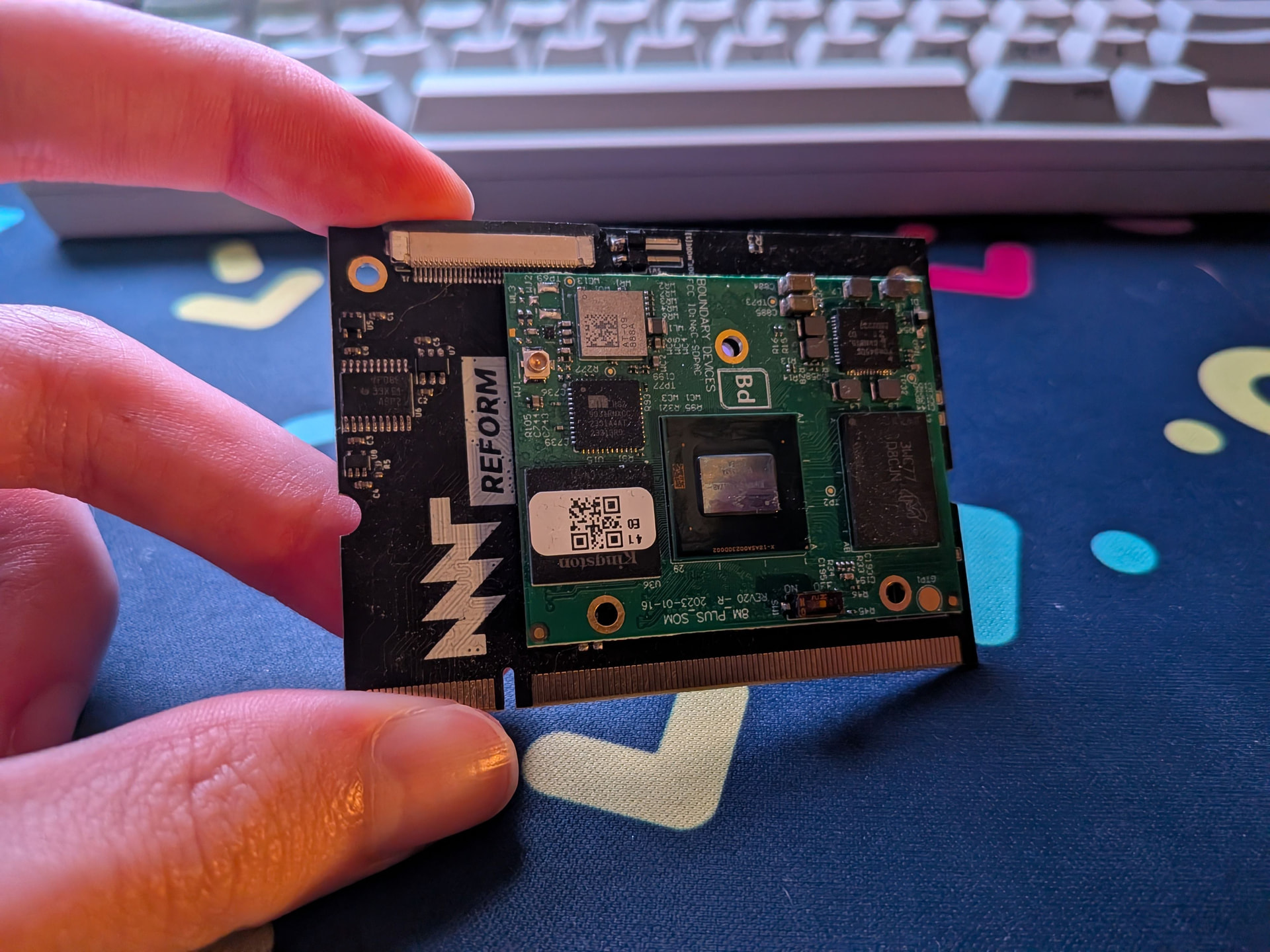

I have the i.MX8M Plus module that came with my Pocket Reform, assuming it’s what you’re looking for I’d be happy to sell it.
That’s it! I’ll DM you

The iMX8mplus arrived today! Let it be known that shebang is a trustworthy individual. Will do some image and device tree hackery to get it working on the mnt classic. I’ll post updates when it’s working.
I tried the imx8m+ in my classic Reform yesterday and it booted just fine but display didn’t come on. This used to work and maybe it just broke with some kernel release and needs a bit of bisecting to find out what broke it.
