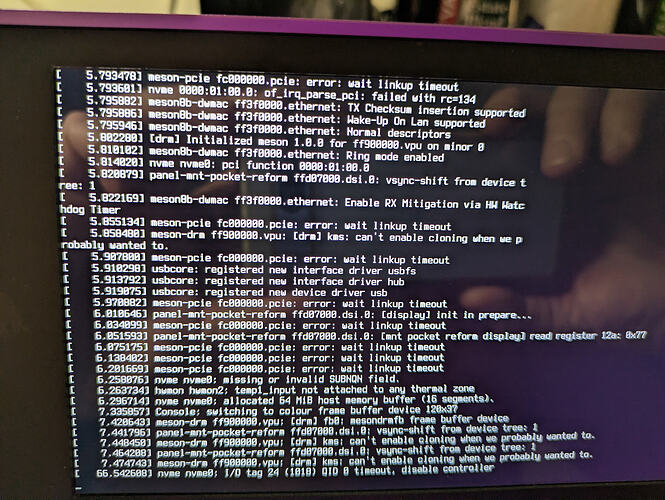

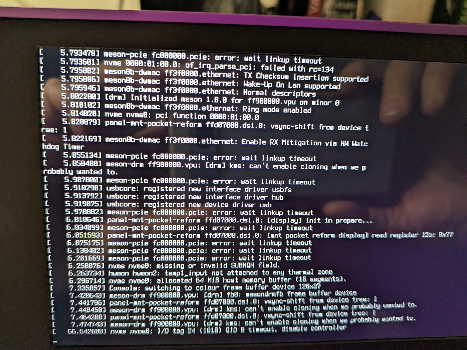

Notice the irq error at the top. I think it is related. 6.18.5

journal shows:
Jan 25 21:26:14 rescuemnky kernel: nvme 0000:01:00.0: of_irq_parse_pci: failed with rc=134
Jan 25 21:26:14 rescuemnky kernel: nvme nvme0: pci function 0000:01:00.0
Jan 25 21:26:14 rescuemnky kernel: nvme 0000:01:00.0: Refused to change power state from D3hot to D0
Jan 25 21:26:14 rescuemnky kernel: nvme 0000:01:00.0: probe with driver nvme failed with error -22
The drive does show in lspci

Would “meson-pcie fc000000.pcie:error: wait linkup timeout” be a possible direction to investigate?
With that and the IRQ error rc=134 i am leaning toward a device tree error. (something that I will need to learn more about)
