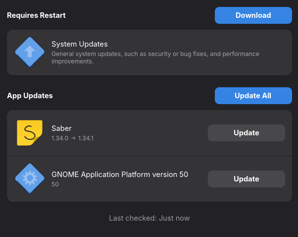

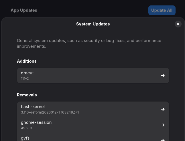

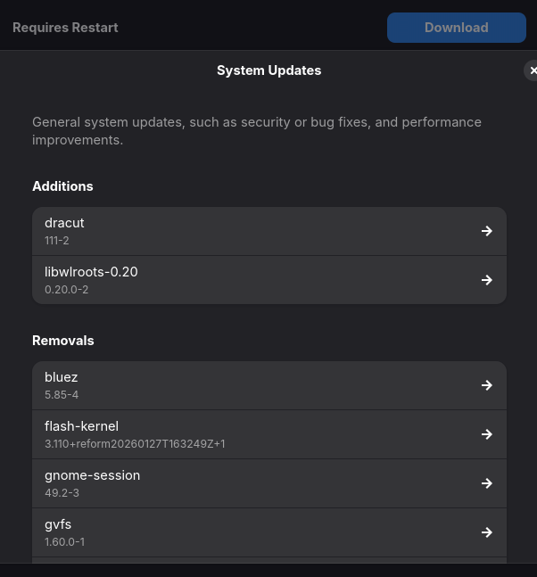

Anybody else having issues with a failed boot? [working now! -- gnome software forced dracut to install]
After the upgrade to kernel 7.0.9 this morning, my MNT Reform is now failing to boot with the installed OS.
I can boot off a rescue image on SD card I keep around (kernel 6.19.x, IIRC), so it’s not strictly a hardware thing. I’ve got serial console output saved off and haven’t dug through it, but I can report that blind-entering the nvme encrypted partition password does not fix things, and the NVME encrypted partition is just fine from the recover SD. As near as I can tell, uboot is loading the initramfs, but doesn’t go anywhere from there. FWIW, I have the v2.5 motherboard.
I did notice that initramfs tools got uninstalled and dracut got loaded in, so it’s possible it’s something to do with that (or with boot.scr).

The missing flash-kernel is maybe important?

Looking at /var/log/apt/history.log, I found:
Start-Date: 2026-05-24  13:04:52
Commandline: packagekit role='update-packages'
Install: dracut:arm64 (111-2), dracut-core:arm64 (111-2)
Upgrade: libnss-systemd:arm64 (260.1-1, 261~rc1-1)
Remove: xserver-xorg-video-nouveau:arm64 (1:1.0.18-1+b1), initramfs-tools-core:arm64 (0.151), sane-utils:arm64 (1.4.0-1+b1), fbset:arm64 (2.1-35), systemd-userdbd:arm64 (260.1-1), xserver-xorg-video-amdgpu:arm64 (25.0.0-1), xserver-xorg-core:arm64 (2:21.1.22-1), solaar:arm64 (1.1.19-2), blueman:arm64 (2.4.4-1+b1), i2c-tools:arm64 (4.4-3), xserver-xorg-input-all:arm64 (1:7.7+26), reform-desktop-minimal:arm64 (1.86-1+reform20260513T115431Z+1), gnome:arm64 (1:49+11), xserver-xorg:arm64 (1:7.7+26), reform-desktop-full:arm64 (1.86-1+reform20260513T115431Z+1), flash-kernel:arm64 (3.110+reform20260127T163249Z+1), xserver-xorg-video-radeon:arm64 (1:22.0.0-1+b3), gnome-disk-utility:arm64 (46.1-2+b2), xserver-xorg-input-libinput:arm64 (1.5.0-1+b1), gnome-bluetooth-sendto:arm64 (47.2-1), xserver-xorg-input-wacom:arm64 (1.2.4-1), simple-scan:arm64 (46.0-2+b2), initramfs-tools:arm64 (0.151), gnome-core:arm64 (1:49+11), bluez:arm64 (5.85-4), xserver-xorg-video-all:arm64 (1:7.7+26), xserver-xorg-video-ati:arm64 (1:22.0.0-1+b3), xserver-xorg-video-fbdev:arm64 (1:0.5.0-2+b3)
End-Date: 2026-05-24  13:05:44
Now, I had run the gnome software tool and gotten a “System Updates” prompt.
And I think that packagekit command line suggests it’s from there to me.
There’s also a smattering of stuff in /var/log/apt/term.log, but this seems like the crucial bit:
grep -B10 -A95 'Removing flash-kernel' term.log >> /root/apt-term-detail.log

Now that things are fixed, and I’m booted back in without dracut but with initramfs-tools and flash-kernel gnome’s software tool is once again prompting me for System Updates… I am not doing that… :stuck_out_tongue:
Aaaand, confirmation:
Now, why it wants to install dracut, I have no idea.
But, generally speaking:
packagekit not only removed flash-kernel, it also casually removed packages like gnome and its dependencies o0
To try and figure out why the gnome updater wants to install dracut, can you try running the following (but hit ctrl+c after it showed you what it would do) on the terminal:

gnome-software has these updates for me:
And that “system updates” detail:
So gnome software definitely still wants to install dracut
This output is interesting. Why would “apt full-upgrade” not upgrade these?
