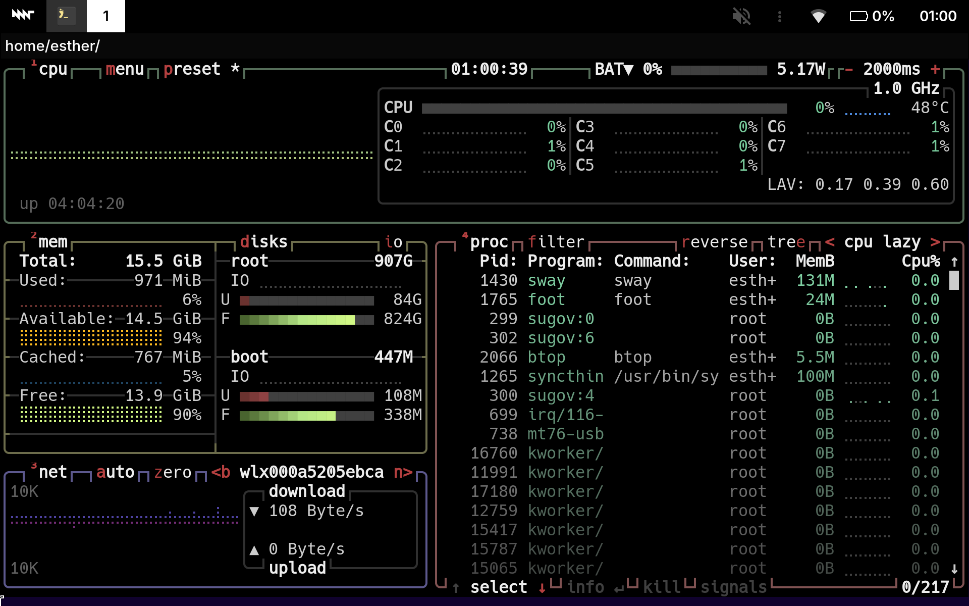

I ran a first battery test tonight after installing the RK3588 module with the device just idling and running btop (and background stuff like syncthing but with no meaningful activity). Just booted with a fully charged battery, launched btop and let it sit. Taking screenshots every once in a while.
Uptime was 4:04h.
Power usage was oscillating between 3.7 and 7.5W the whole time, mostly staying at around 4.3W
Temperature was pretty stable at 45-50°C. Much cooler than the i.MX8M+ which was usually at 75°C the whole time.
Shortly after this one the Pocket rebooted and went into a weird loop of trying to mount the SSD and failing at that so I plugged it in again (it was fine after that).
Tomorrow I’ll see how it performs in real-world use at university. And when I find time I’ll also do one test of just letting a long youtube video play.

How’d you measure the power usage? Is there a btop option for it, or…?
Btop displays that on the top right next to the battery percentage bar
Thanks for sharing. I had similar results (just had irssi instead of btop), maybe closer to 5 hours, with scaling governor set to powersave. What was the screen brightness in your tests?
Screen brightness was around 30% as I did this indoors at night.
I did not set any particular power saving though.

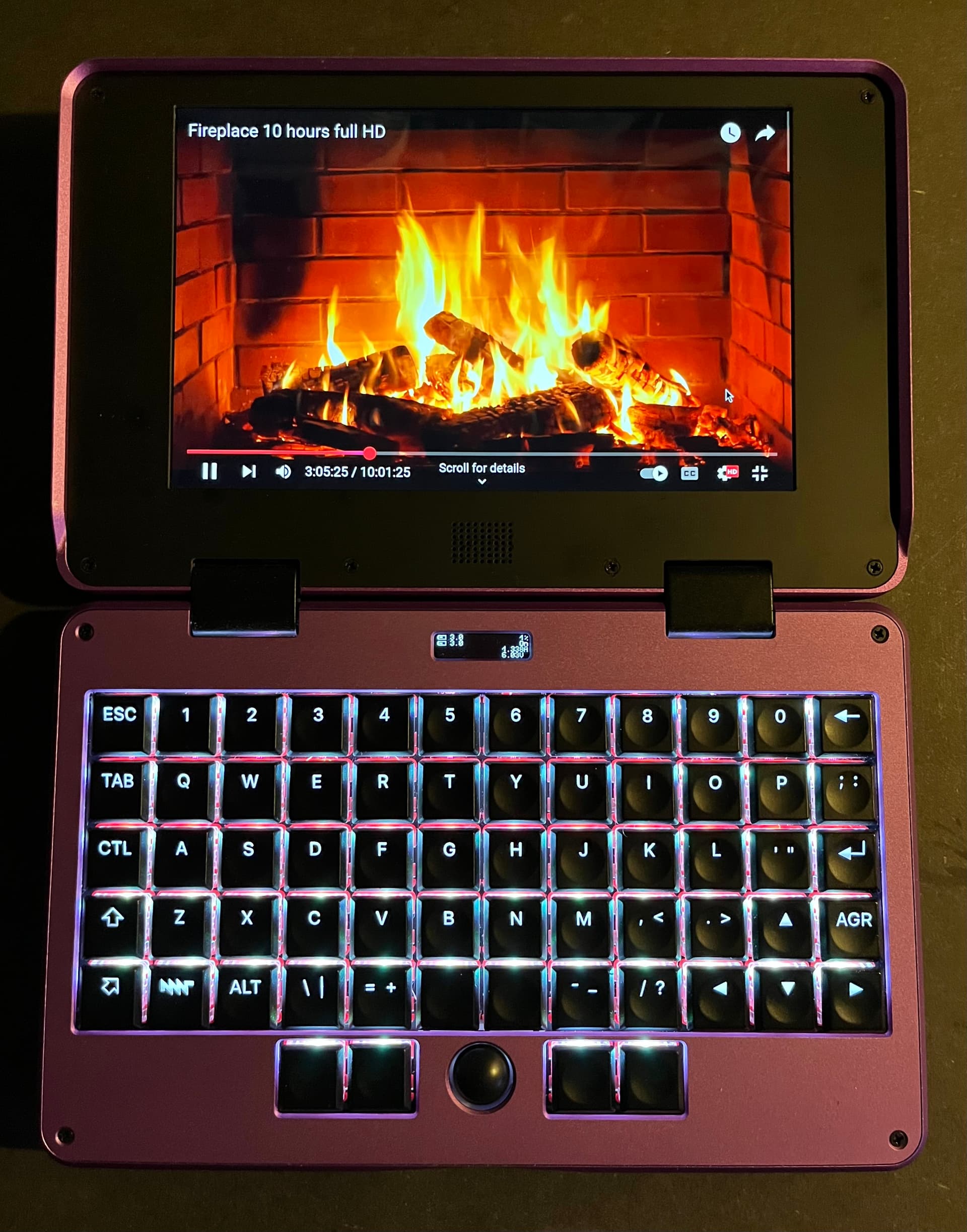

Today I tested battery life on RK3588 while playing a 1080p fullscreen video on Youtube in Firefox, connected to a close-by access point with strong signal.
CPU governor was set to powersave, screen brightness was at around 30%. Audio was turned off (muted) system-wide.
The device rebooted with 0% battery on the OLED display after 3h07m25s.

I played this fireplace video which is the same video that Jeff Geerling used in his review of the classic reform and tried to do the same test: play the video in fullscreen in firefox while connected to the internet via wifi. According to the YouTube interface, the video was displayed in 720p@30. It lasts less long than Esther’s probably because I had my display on full brightness. Runtime: 02:26 h
