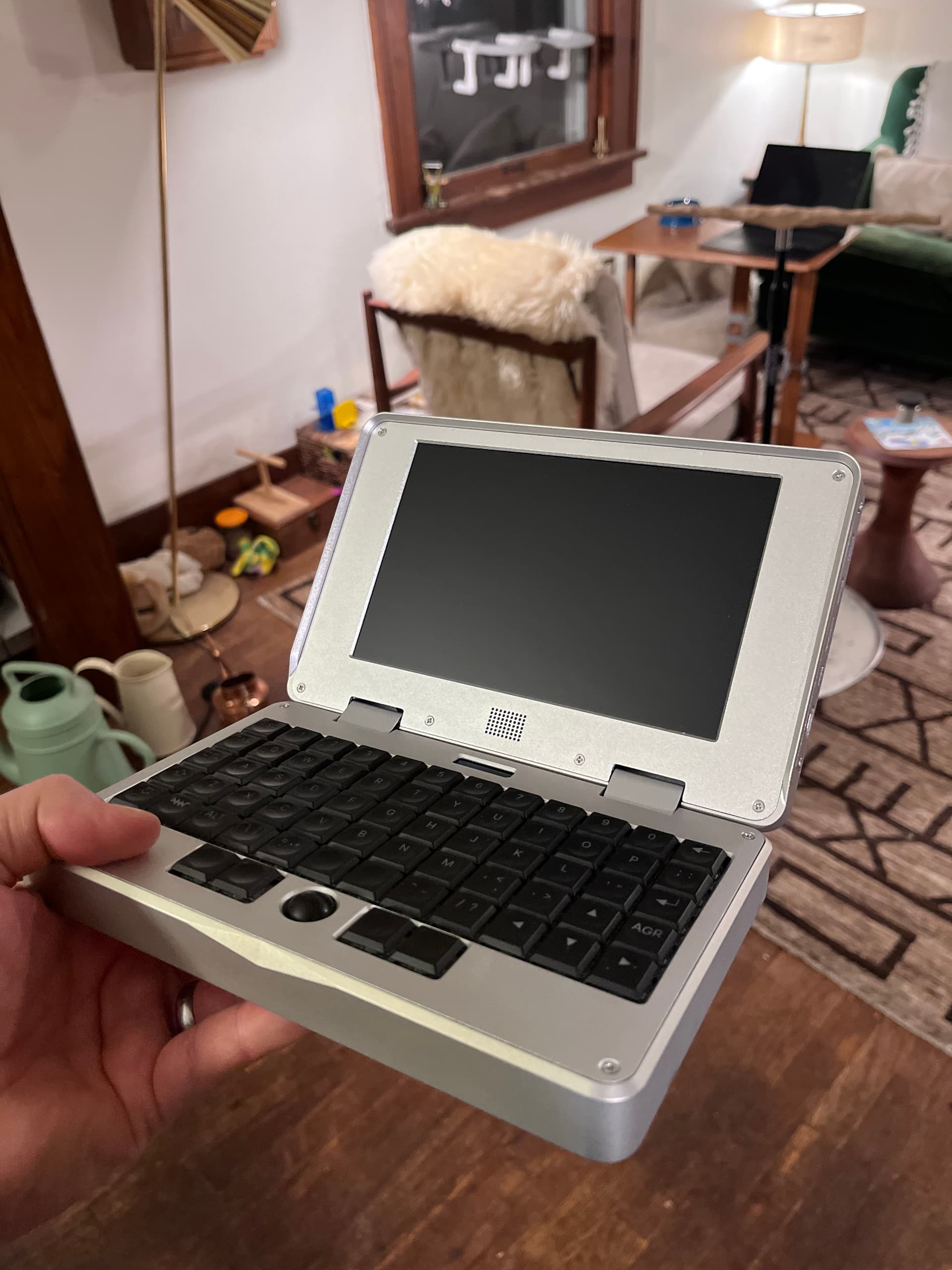

At any rate, here is my device’s spiffy new appearance.
Very pretty machine! :heart_eyes_cat:
