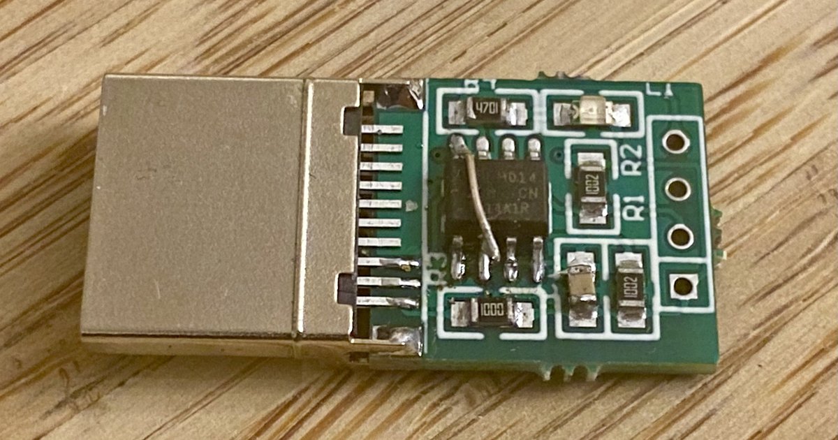

Concerning the eMMC-boot in the A311D, what hardware is needed to reflash a broken uboot? I might be tempted to give that a shot at some point…
Yes, suspend (well, actually the resume part) did not always work. There was a period where it worked more and where it worked less reliably but we didn’t change anything related to suspend in the reform-specific bits but suspect that this is just something that varies with the kernel version. For example @2disbetter for a long time stayed with the 5.12 kernel as that was very reliable. Things then got worse somewhere between 6.1 and 6.5 and I hear from @disbetter that things are better again these days with 6.6 and 6.8? But it is unclear which bits made it worse or better. It is a bit of a roulette which is unfortunate…
One way to unbrick it would be via the CM4 IO board. A cheaper way would be by using one of these:
Which also seems to be sold for 5 bugs here:
Essentially this is a modified HDMI Display Emulator dongle with the A1 pin (pin 2 of the AT24 EEPROM) connected to VCC (pin 8 of the AT24 EEPROM). The dongle is available for 3 bucks on aliexpress:
