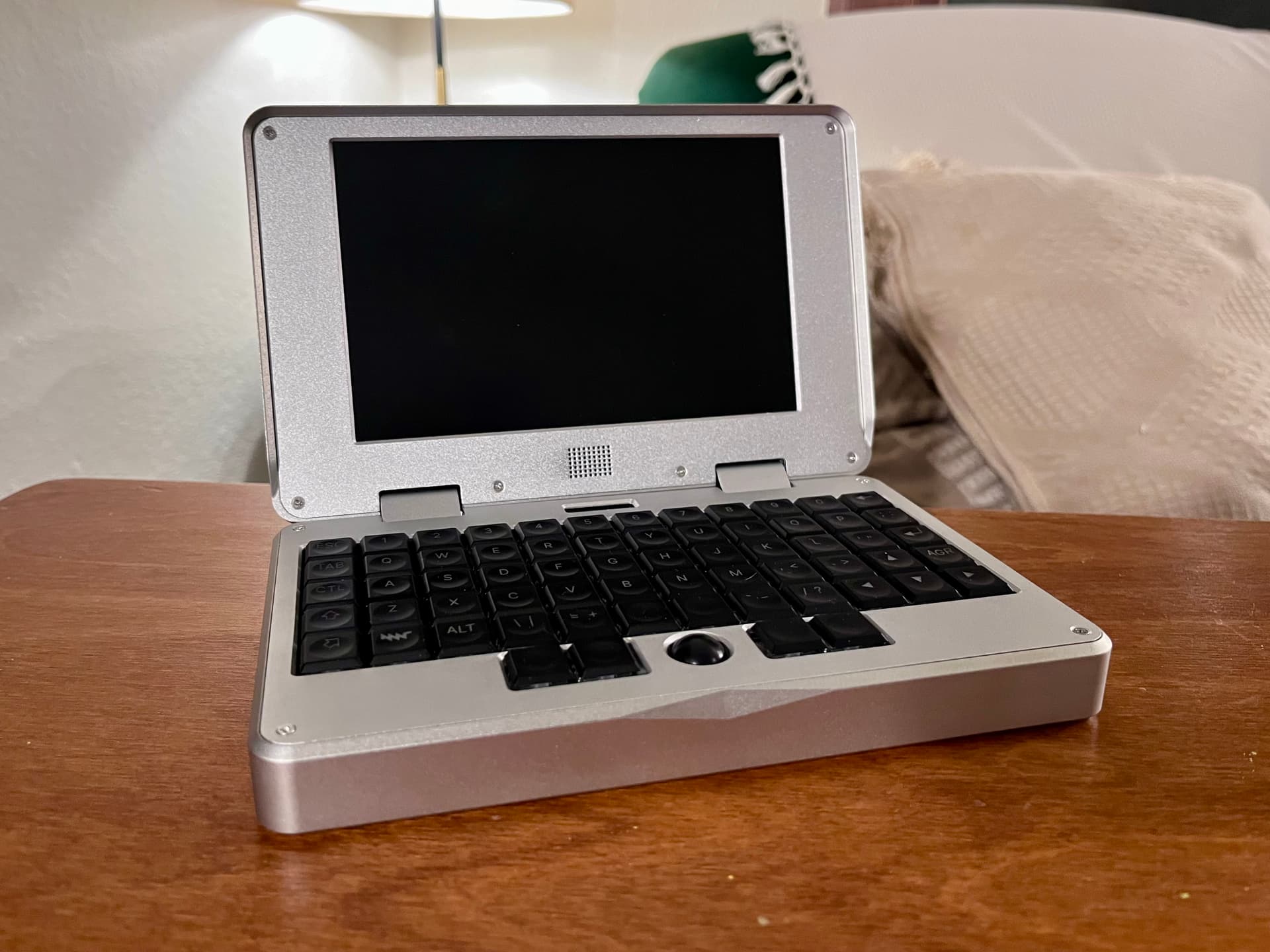

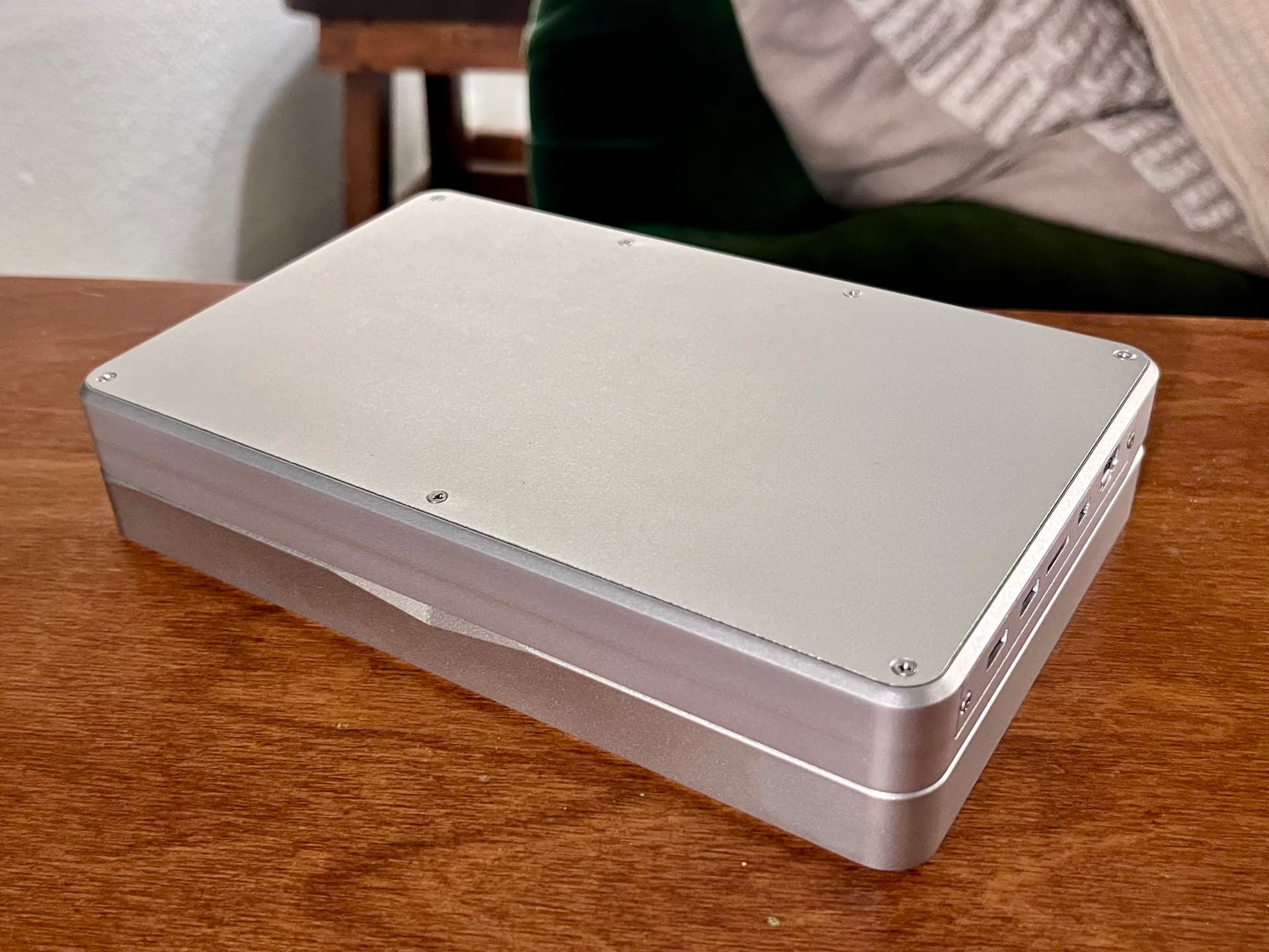

Welp, here’s my device as of this evening. I have:

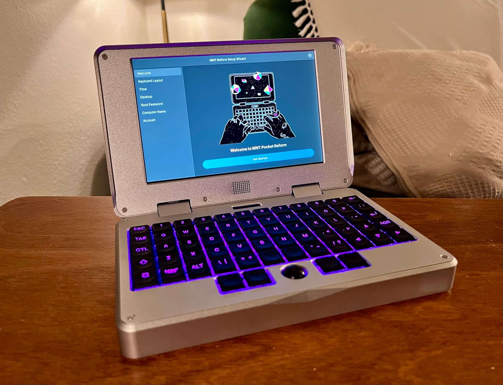

1.) Replaced all case parts with natural aluminum and silver-toned screws and hinges
2.) Successfully reset the IMX8MP module to factory defaults while I await my RK3588 board and new wireless card (Thanks again, @josch)
3.) Applied a matte trim-to-fit film to a new screen module
I sure am pleased with the aesthetics and I’m looking forward to actually, y’know, using it again. For the time being, though, I’m gonna put it away and not look at it for a while!
