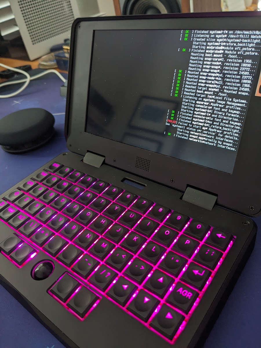

Last night I tried using a usb-c to HDMI adapter to connect my Pocket to a TV (it did not work, I believe because I did not use wlr-randr or sway output to set it up, but maybe because of the adapter)
Since doing this, two issues have emerged.
  1. Display Issue
  • A second monitor is active at boot
  • Only the rightmost portion of the display is used during boot [pictured]
  • After starting sway, a second monitor is active (a workspace is there and I can move windows to and from it). This is fixed by disabling the output in sway or wlr-randr, but all other issues persist.

I cannot help but notice that your display looks like the one in the photo by @ewolff posted here: Problems with display and clock
Since you are the second person with that issue, let me ping @minute for input. Maybe they can help!
  1. I believe display output through the usb-c port is not supported by hardware, isn’t it?
  2. Those display problems are caused by the 6.14 kernel.
    After upgrading to 6.14, /sys/class/drm/card1-HDMI-A-1/status indicates connected even though I have no external displays connected.
Ah, that makes sense. Thanks for pointing it out!
Sorry, this is a bug that I introduced when cleaning up the patches and DTS files for the new kernel. I didn’t notice it during (extensive) testing because my Pocket Reform was connected to HDMI during testing, and the problem manifests when HDMI is not connected. I forgot to port over the correct pinctrl for the hotplug pin (HPD). This should be fixed once this is through CI and merged:
This fixed the issue for me!
