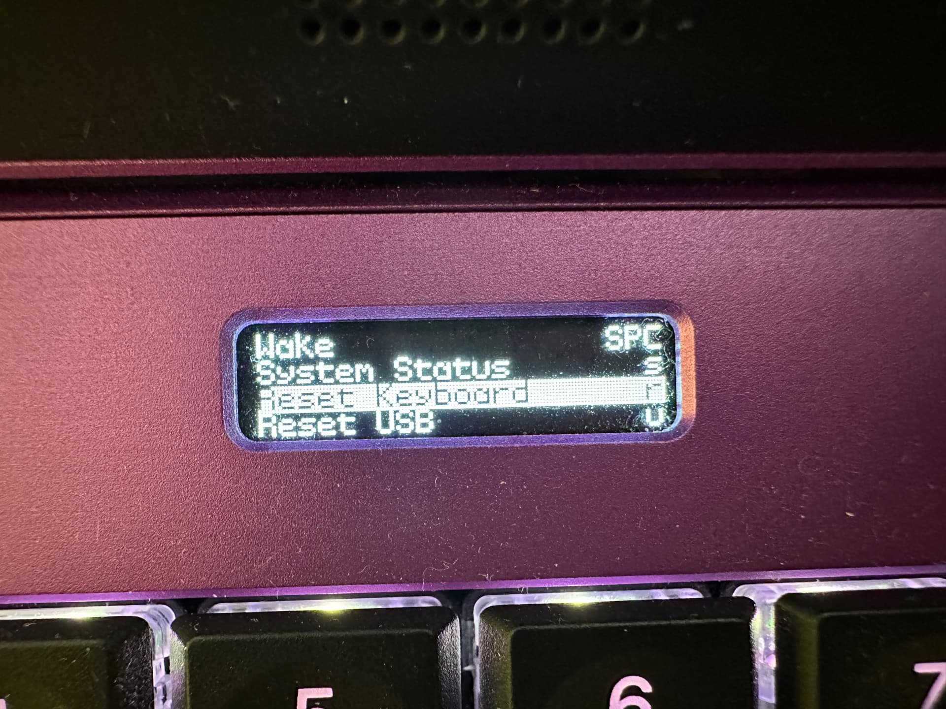

Surely there is some way to put it into some sort of power save mode besides completely shutting it down? There is a “Wake” option in the keyboard menu, which must do something.

My RK3588 Pocket Reform also has a “Wake” option in the oled keyboard menu, at it appeared after upgrading to RK3588, I am quite sure it didn’t have it when I was using the i.mx8m :slightly_smiling_face:

My Pocket Reform is with i.MX8MP, but has “Wake” option, I think it is due to the firmware update.

Thanks for the hint, now thinking about it, mine also appeared after the firmware update! :slight_smile:
