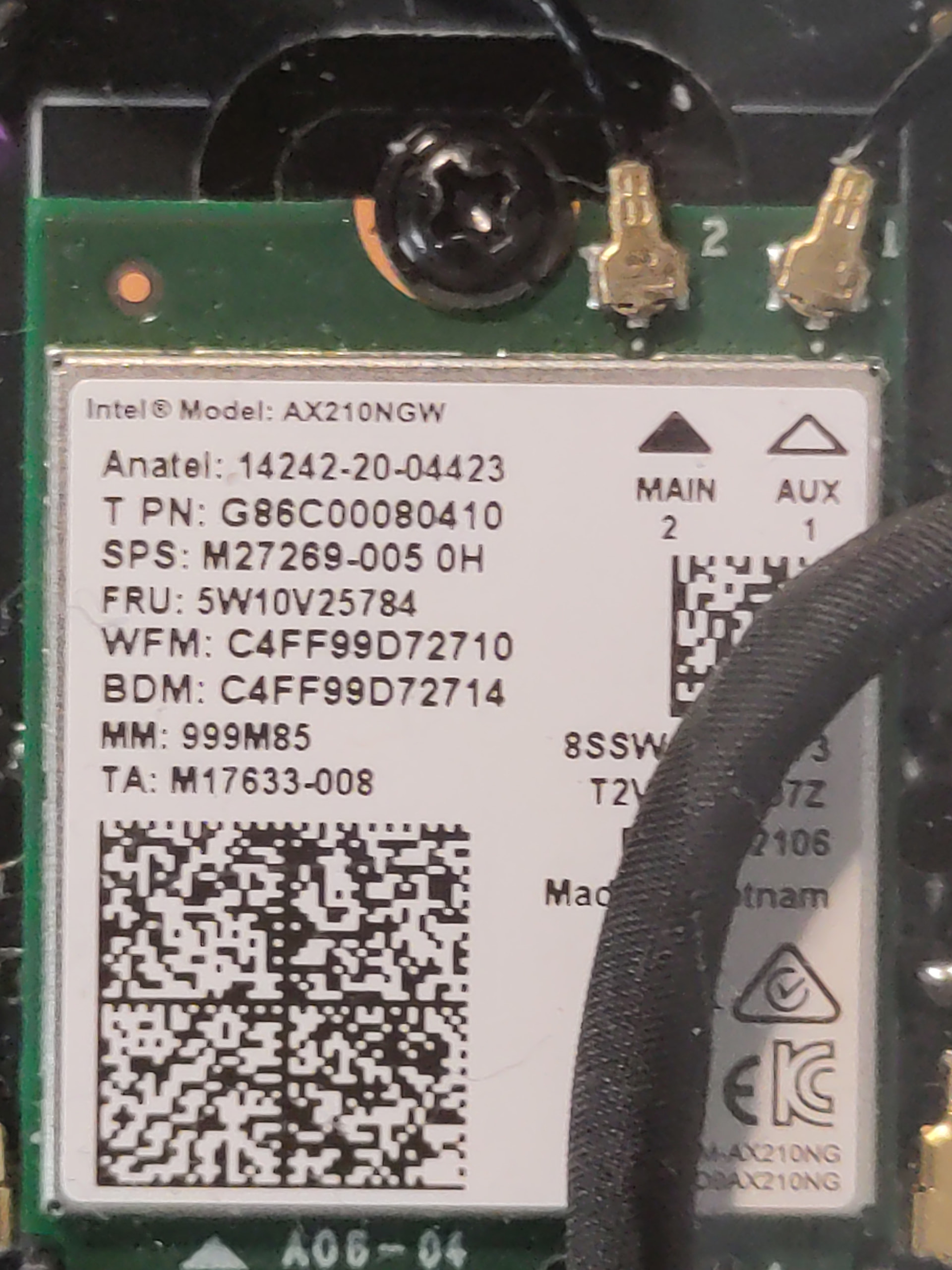

You probably have intel ax201 wifi?
Hello Josch,
This is beyond my eyesight, but I think I recognized Intel. I’ll be buying a magnifying glass soon.

I often use the macro lens of my digital camera to read these kind of things on my hardware.

PS: Using the camera instead of a magnifying glass was a good tip. I could have thought of that myself…
