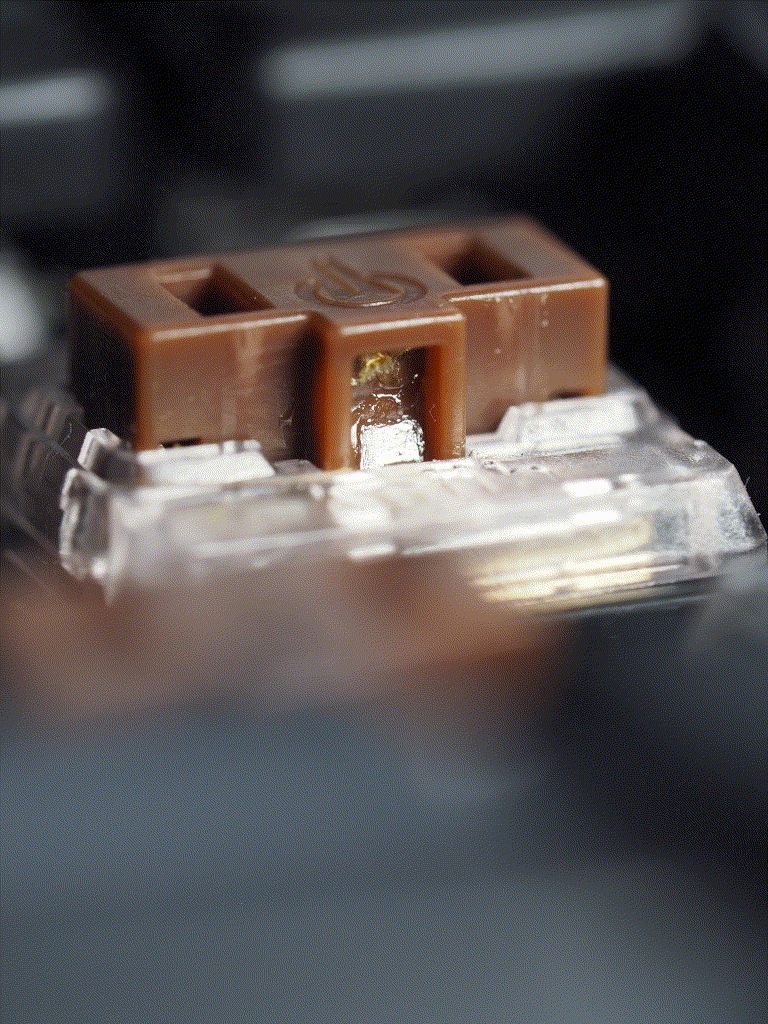

I’ve now had the problem for a third time: pressing a key would generate two keypresses instead of one. I figured out why a while ago but failed to take photos back then to share the problem and the solution with others.
The problem is, that when some dirt gets stuck at the top of the small ridge in the brown part of the switches, then a small metal pin will be de-pressed once the key gets pressed all the way down. That de-pressing will generated a second key-press event once the metal pin slides back as the switch moves up. To better illustrate it, here is how that looks like before and after cleaning.
out
You see that there is a bit of orange/yellow debris stuck at the top of the ridge. That is responsible for making a small metal needle loose contact if you press the switch all the way down. Cleaning it out fixes the problem.
Took me a while to find that this is the issue because it takes a lot of light and the right angle to spot that there is something stuck in the brown part of the switch. The last time i had this issue, i only found this after I had the switch de-soldered because reflowing the solder didn’t fix the issue.
Hope this helps somebody!

Today I was having a lot of issues with my bksp key. I did not see any debris on the switch but I took a piece of pegwood from my watchmaking kit and scrubbed the key switch slot with it, as per josch recommendation. And voila, problem solved.
