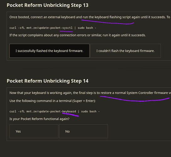

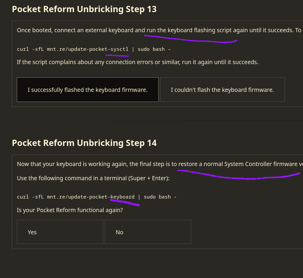

I might be wrong, but maybe the scripts should be swapped in step 13 and 14?
