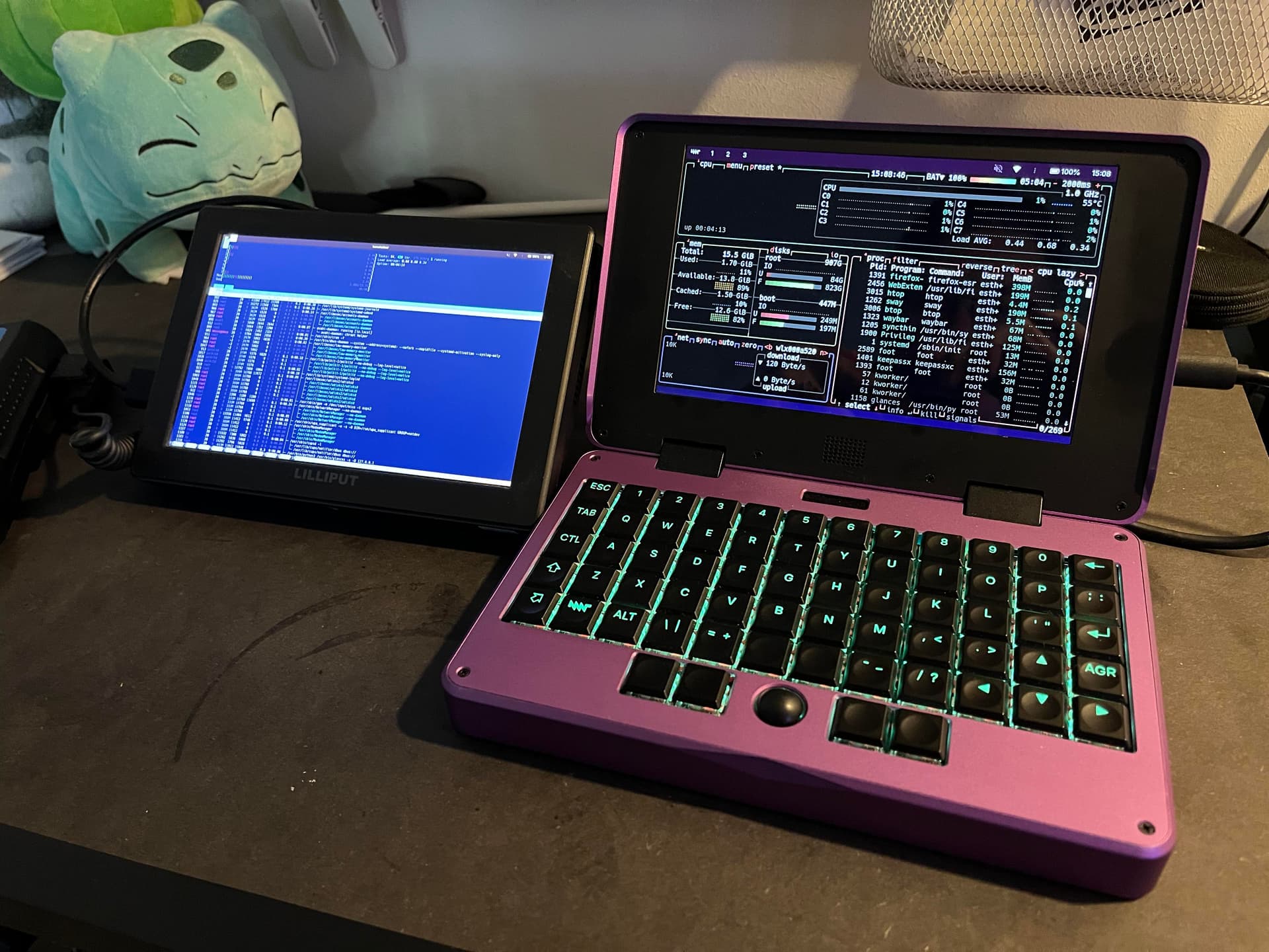

EDIT: When booting with an HDMI monitor connected, the boot messages only use half the internal display and the external screen receives no signal, even though swaymsg -t get_outputs lists both. When unplugging the HDMI cable from that state, the system also fully freezes.

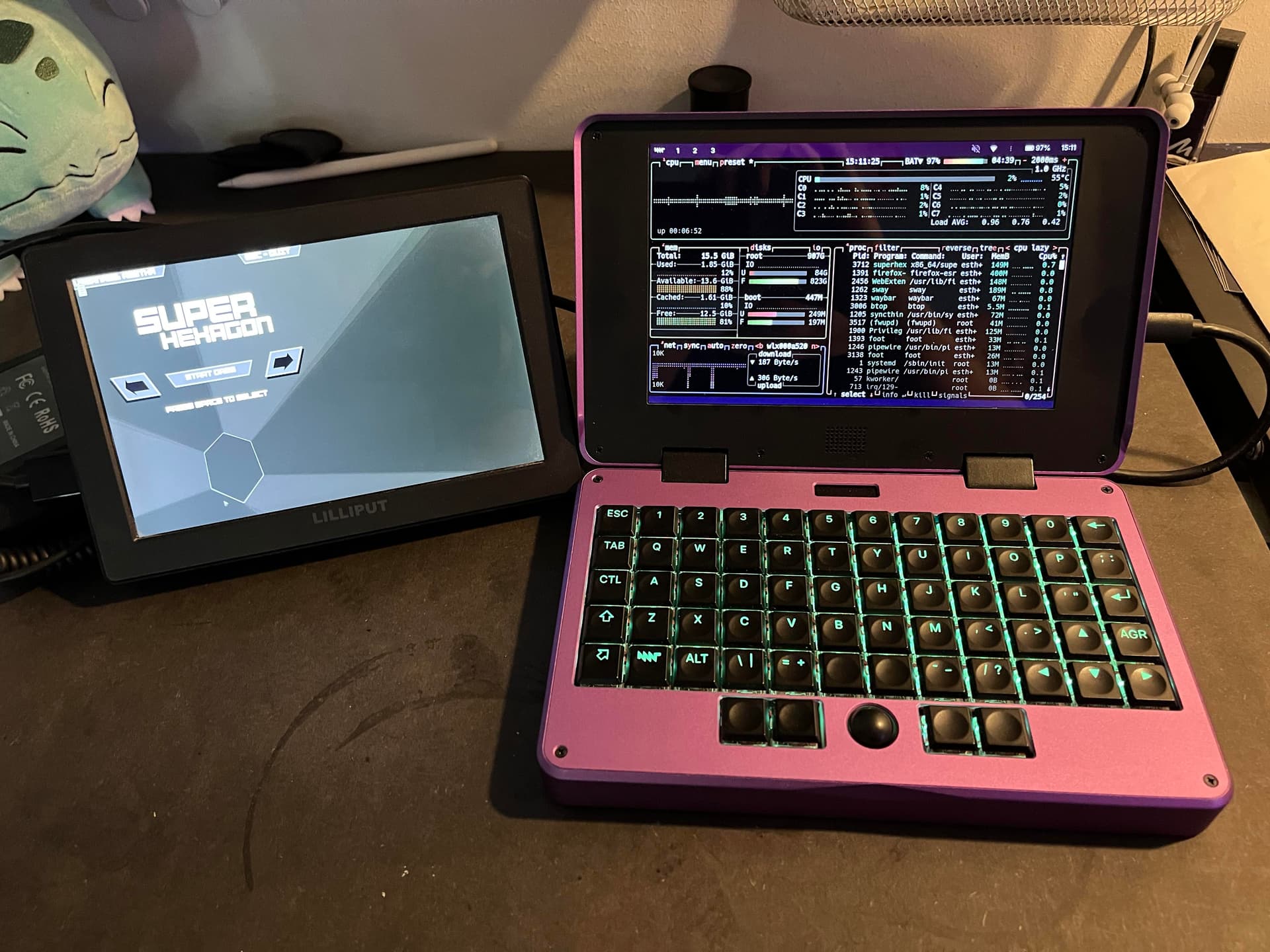

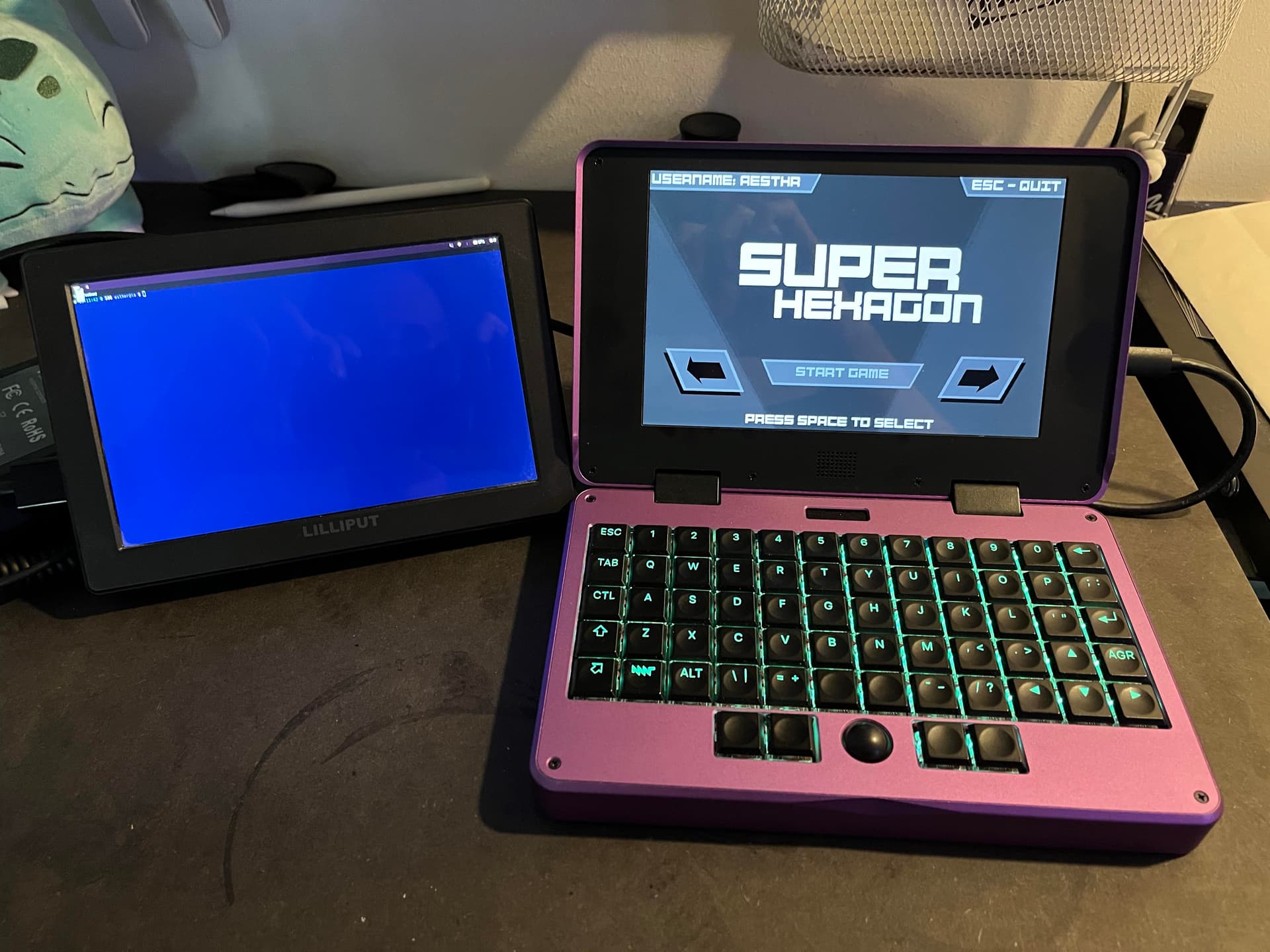

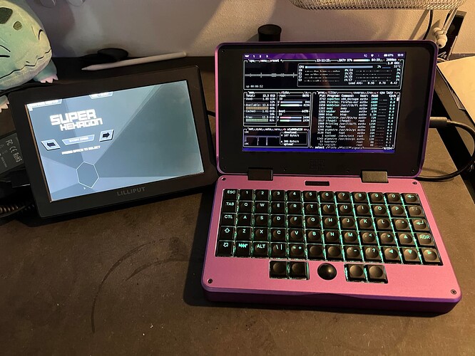

There’s some residual weirdness when playing (some?) games, for example Super Hexagon: If I launch it on the external display, the game seems to only be aware of half the screen width, but die render fullscreen somehow.
For comparison: how it looks on the external display vs the internal one
But I don’t know, if this affects other games too, and to me it’s not a priority. Just a curious little issue. Maybe someone as an idea about that?
