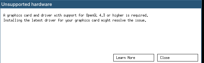

I’ve just thrown this into the MNT gitlab CI. Here is a blender.deb for you to try out:
Wow neat, thanks!
Sadly…

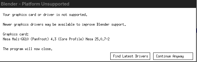

and if I try with MESA_GL_VERSION_OVERRIDE=4.3:
So, no go. But so close… :slight_smile:
Okay, but it was worth a shot. Note that minute wrote this patch against blender commit 1448b70625510f0a1a5408a8e8dbecc598fb890b while Debian unstable has blender 4.3.2. The commit minute used is not in any tagged release (yet) and it’s 5358 commits ahead of v4.3.2.
