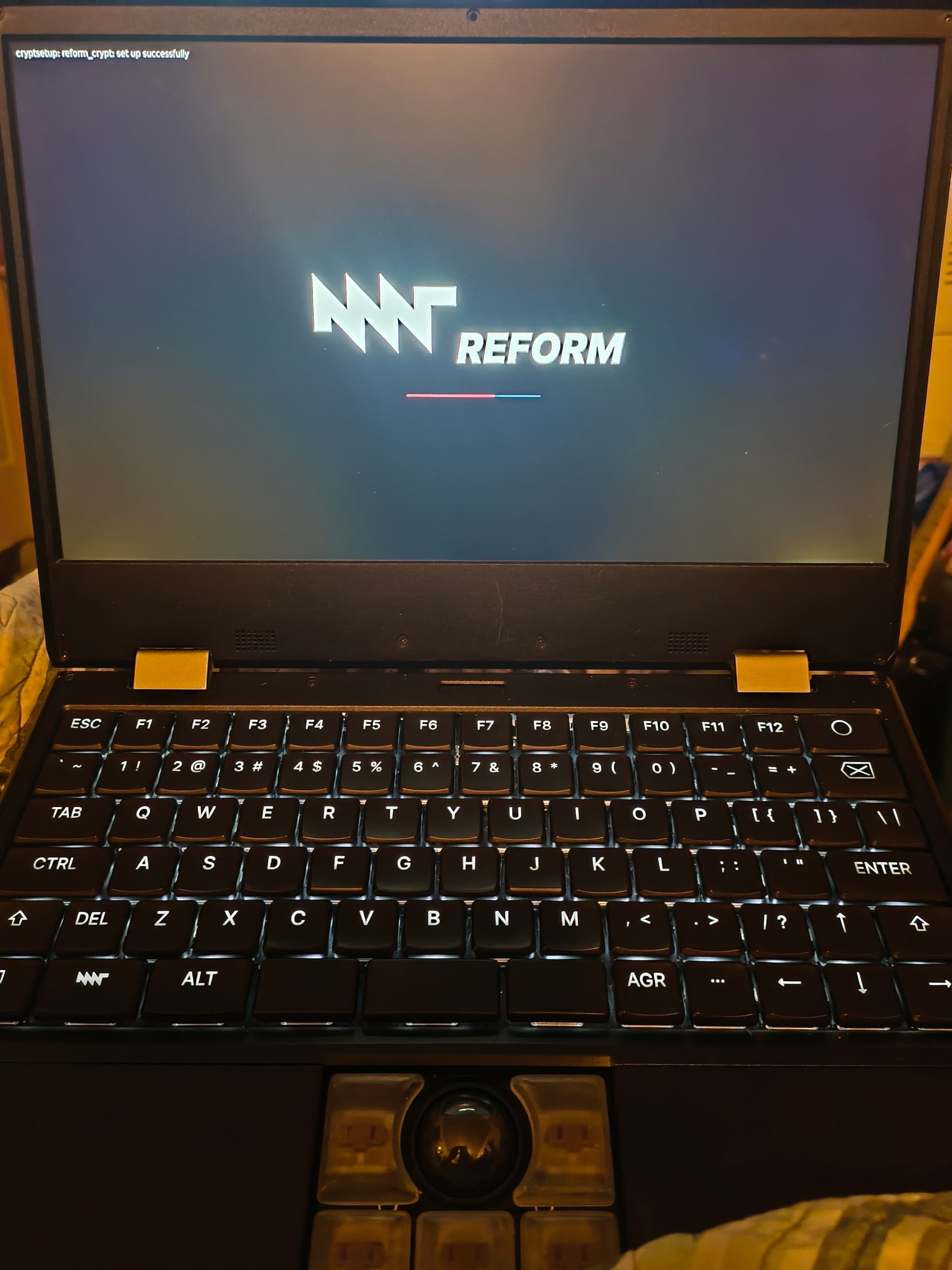

I got it to work on pocket with rk3588 module. I did sudo apt-get install plymouth plymouth-themes firmware-linux then edited /etc/default/flash-kernel with LINUX_KERNEL_CMDLINE_DEFAULTS="video=DSI-1:panel_orientation=left_side_up splash" and did sudo flash-kernel This got plymouth to rotate to the pocket display.
I used sudo plymouth-set-default-theme -l to list installed themes and sudo plymouth-set-default-theme -R <theme> to select desired theme. I settled on moonlight for now.
Edit:

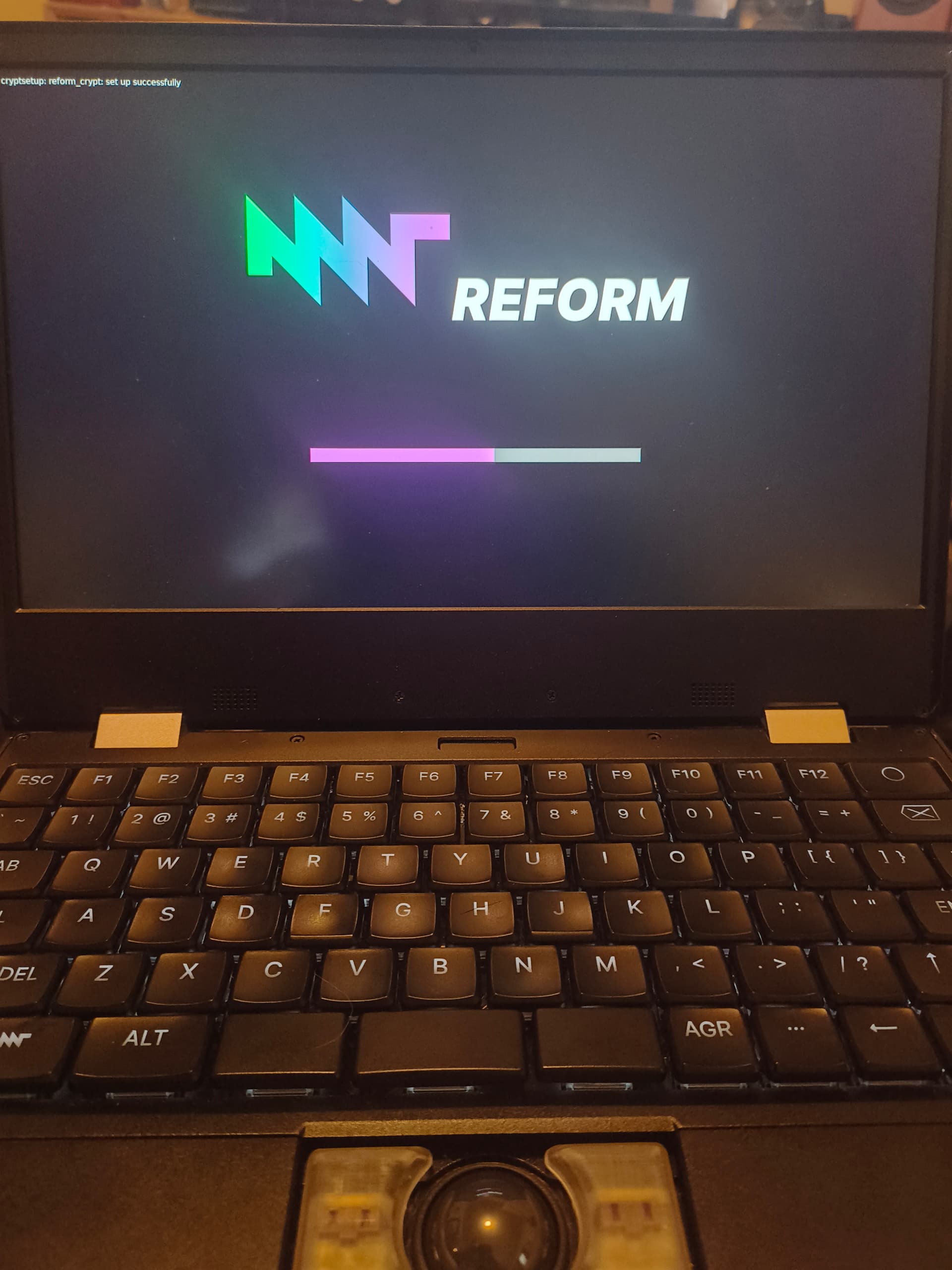

Worked on classic reform on rk3588 as well. firmware-linux can be omitted for both models. I just forgot to flash-kernel at first when setting it up on pocket reform. On classic reform you can omit the part about rotation as it is native landscape so /etc/default/flash-kernel just needs to be LINUX_KERNEL_CMDLINE_DEFAULTS="splash"
I think I’m going to try to make a custom mnt logo screen where it slowly fills up with color in homage to the amiga checkmark and classic apple logos. Will post if/when complete.
I still need to align password entry box and hide progress bar until password is entered. Maybe next weekend I’ll have it in good enough condition to share.

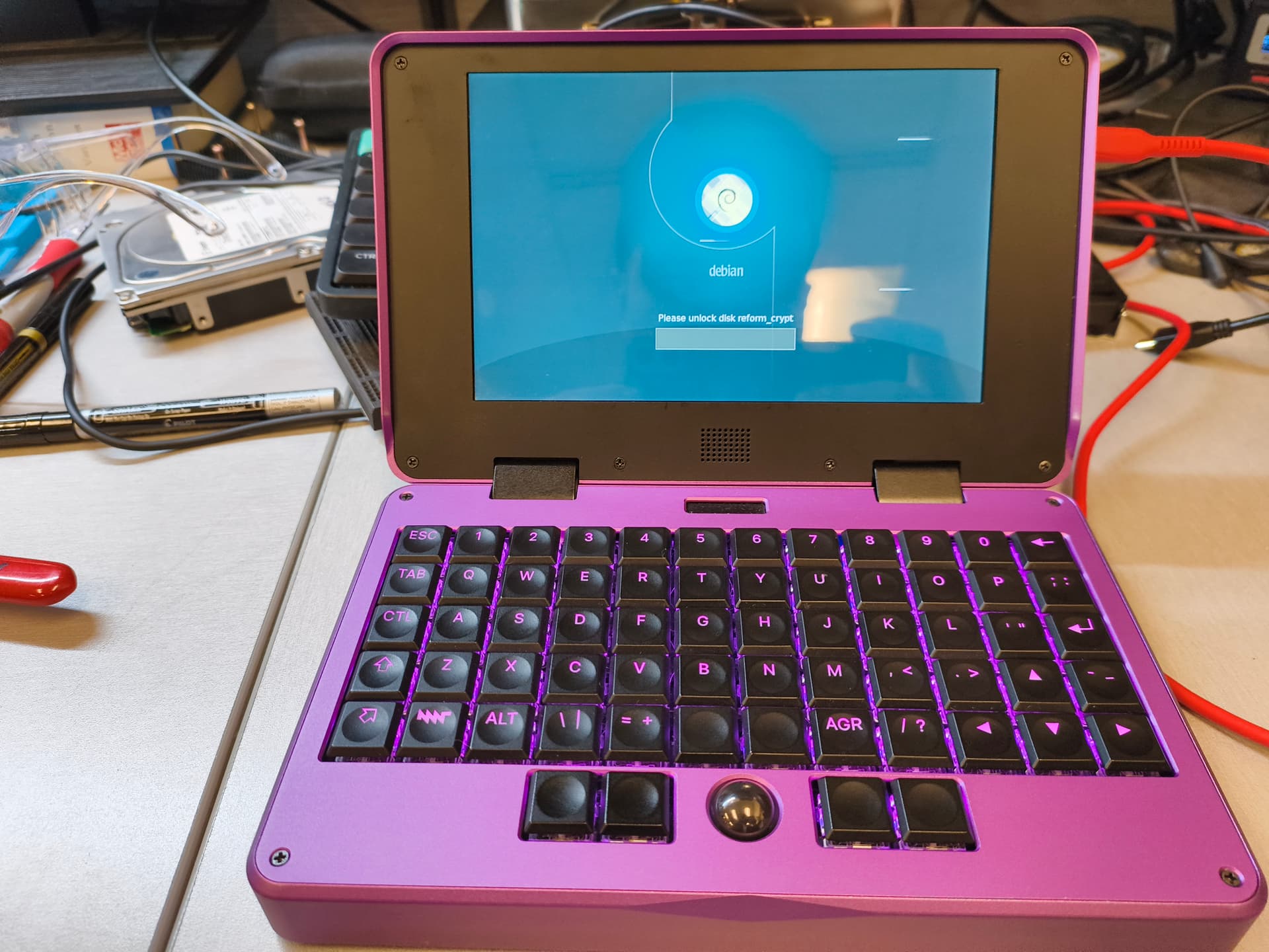

I installed plymouth again (pocket reform, a311d) and I don’t see a stacktrace in dmesg at all, I guess we’re seeing different behavior? (this is the case even with @hardcoreufo’s kernel parameters)

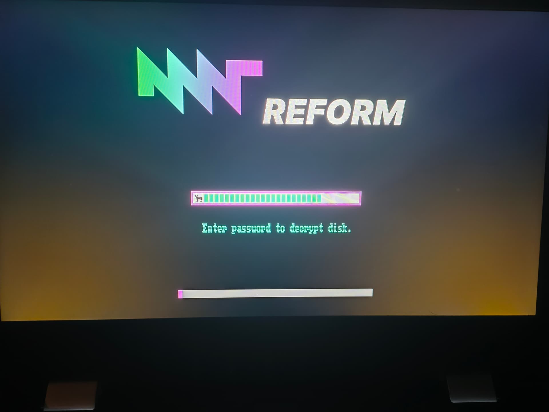

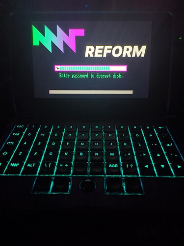

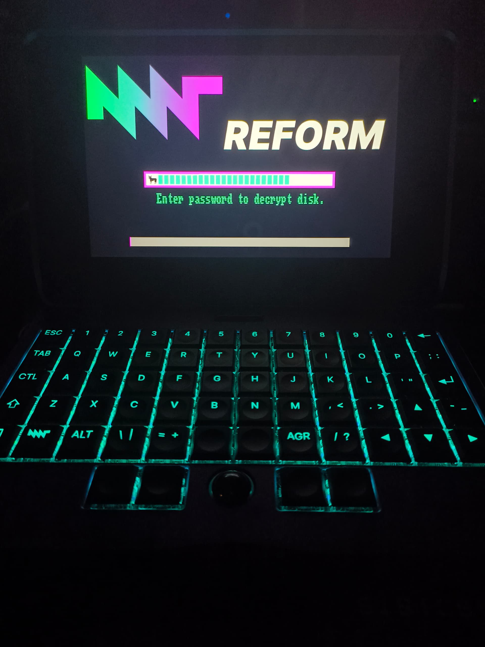

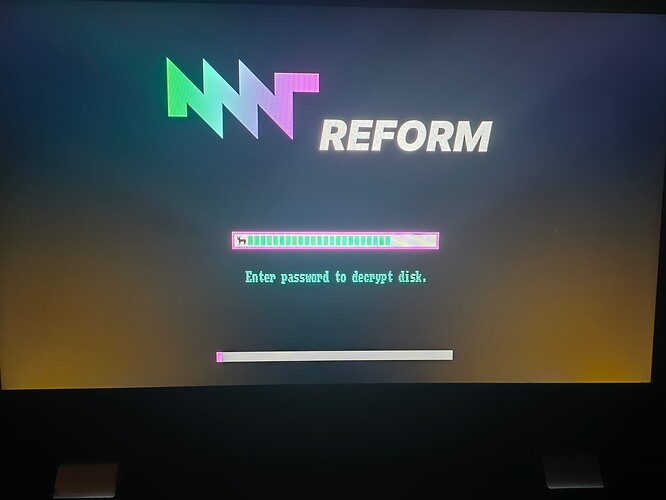

Ok version 0.9. I think its good enough to share. Still can’t figure out how to hide progress bar until password is input but it looks okay at the bottom.
I’m not a developer or much of a coder, just like to tinker and this is the first thing I’ve made to share. I put links to the githubs I borrowed from at the top of the script. I think that makes it okay to share right?
Just unzip and place the folder into /usr/share/plymouth/themes then run sudo plymouth-set-default-theme -R mnt-reform.
Edit: Works on pocket too, but everything is a little large, and the logo is huge. Should just need a few tweaks to get right.

skimmed this a while back and just revisited to check progress, i love the chonky looking logo, when you release the final version please make two versions, one with a size appropriate for the Pocket and a chonk version like this lol. awesome job, and i’m very excited for the re release : )
