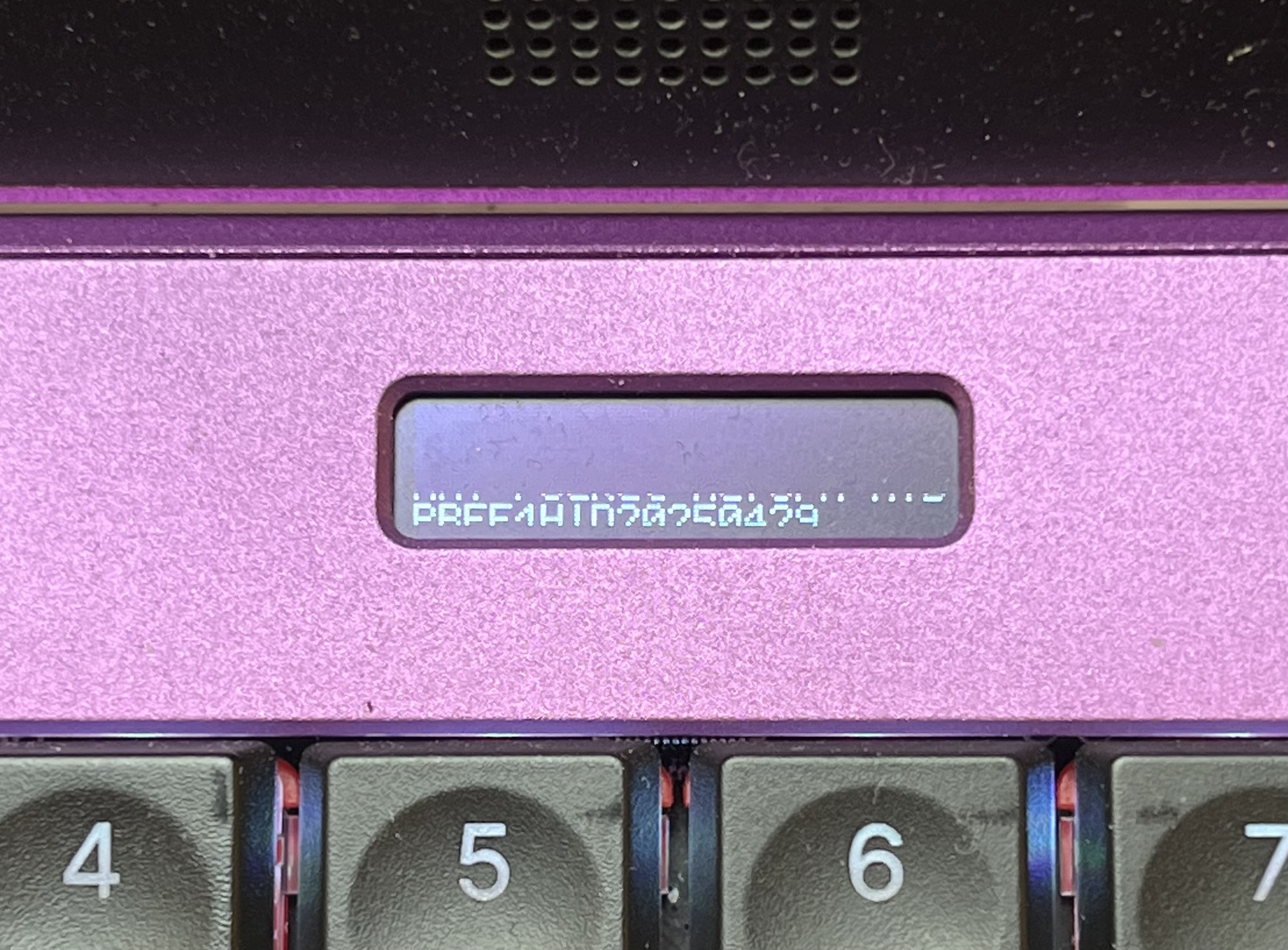

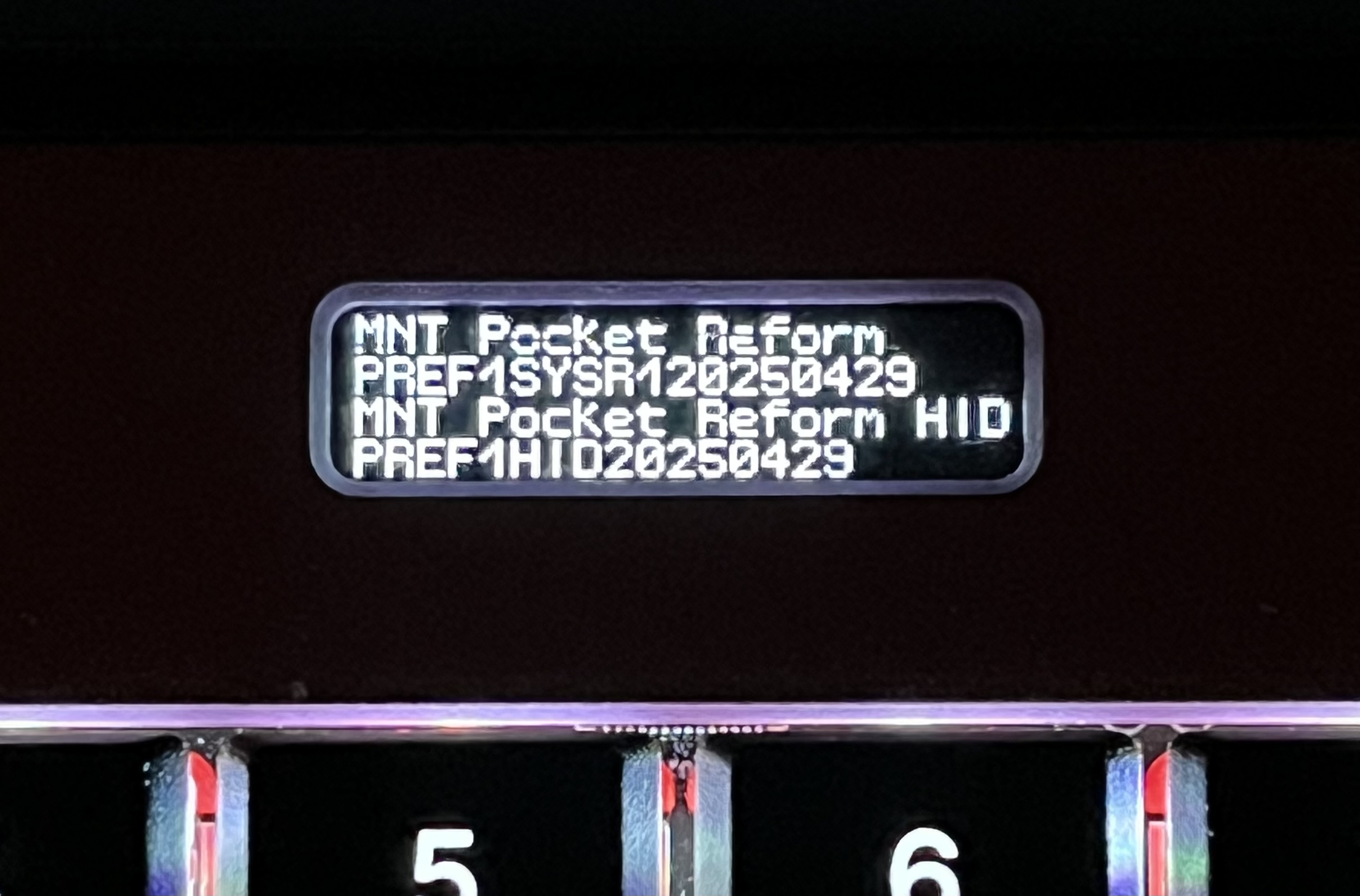

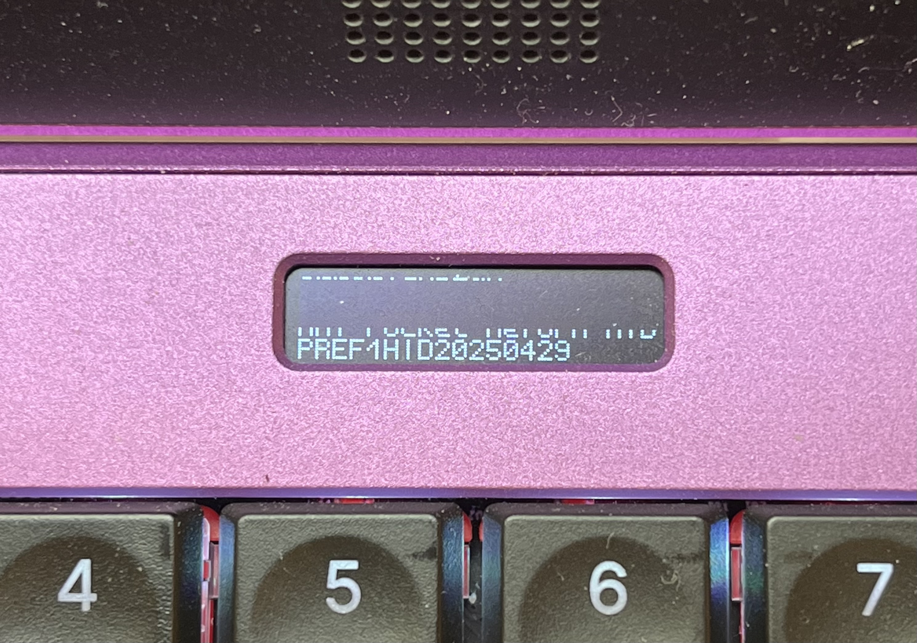

Another issue: the OLED display flickers (see photos vs video, on older firmware it always worked to shoot a readable still photo of it) and when pressing s I first get an error but when trying again it does show the expected info
Video: https://imgur.com/a/gKeUZ83
