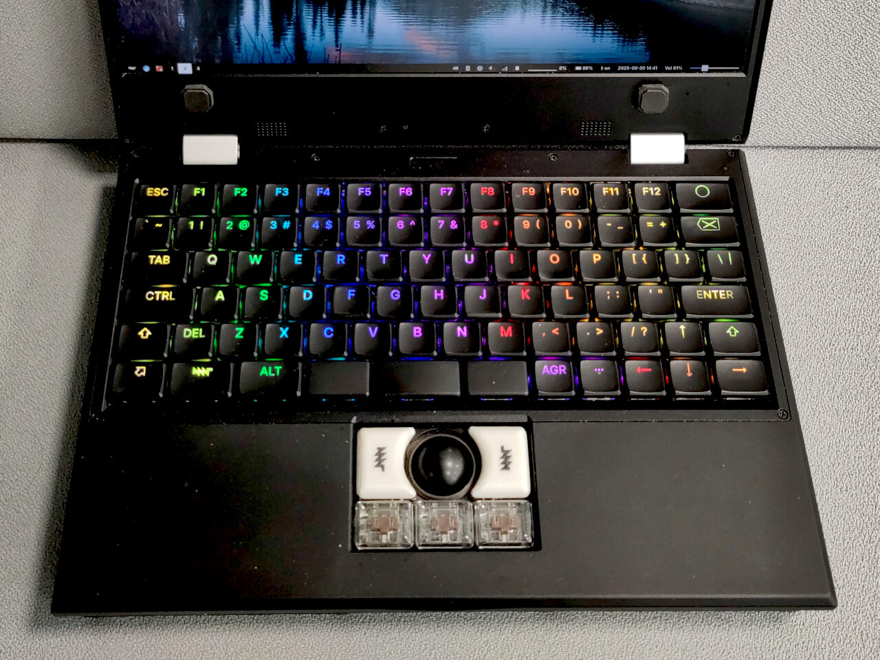

Here’s a simple utility to jazz up your Reform and make it look a bit more like the photo in the MNT Research webshop :slight_smile:
Tested on MNT Reform classic. I suppose it works with other models too.

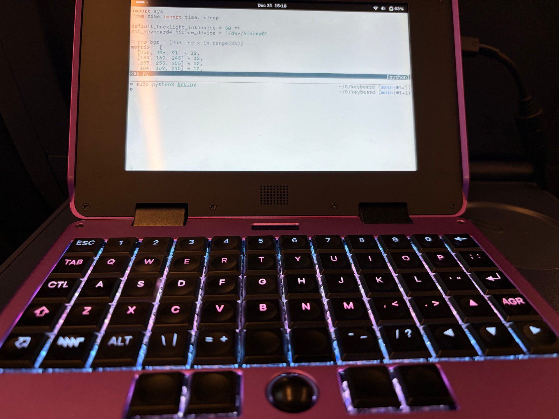

Oooh, pretty! Works on a pocket too:

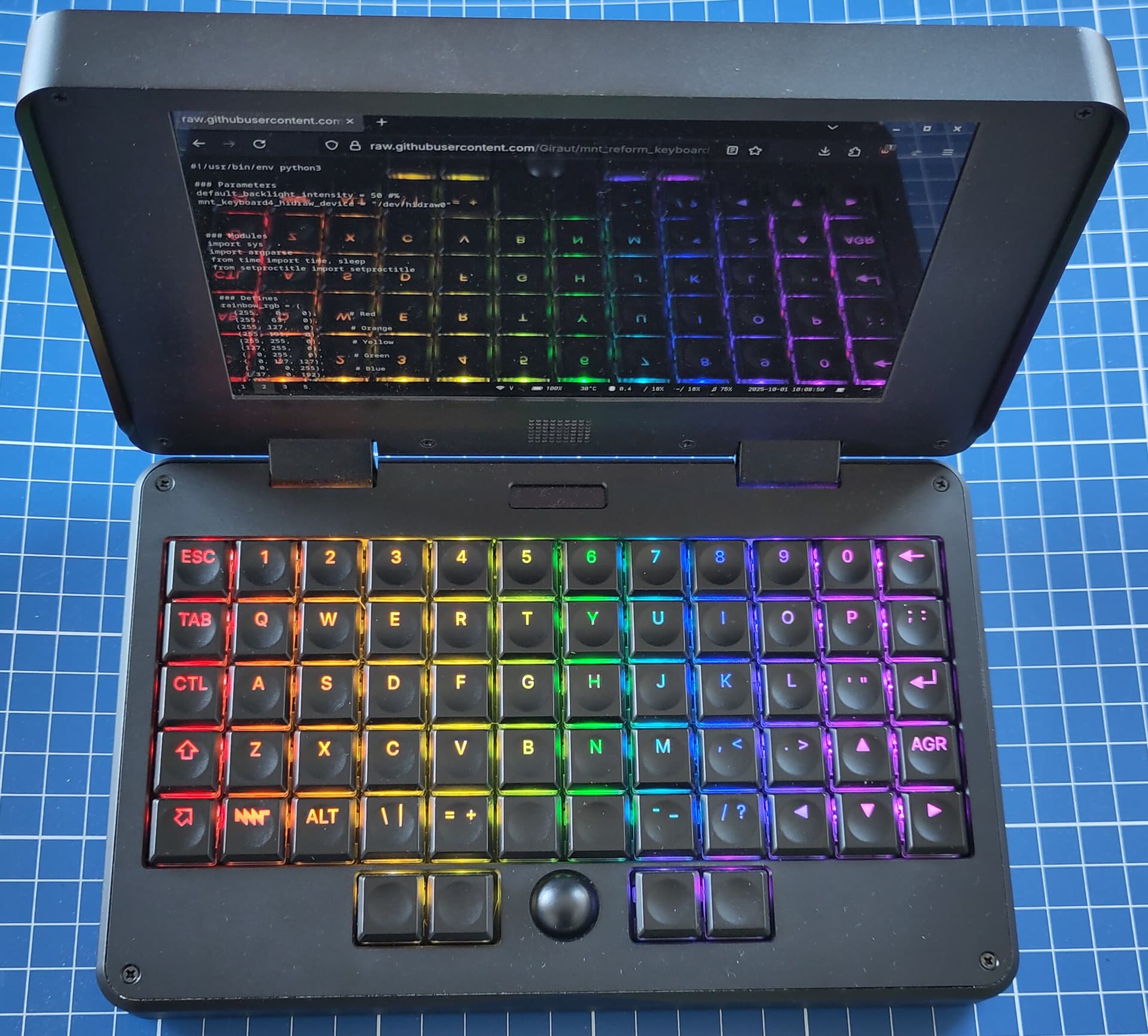

30 lines of Python for some awesome light effects on the Pocket Reform Keyboard. I love it :heart:
