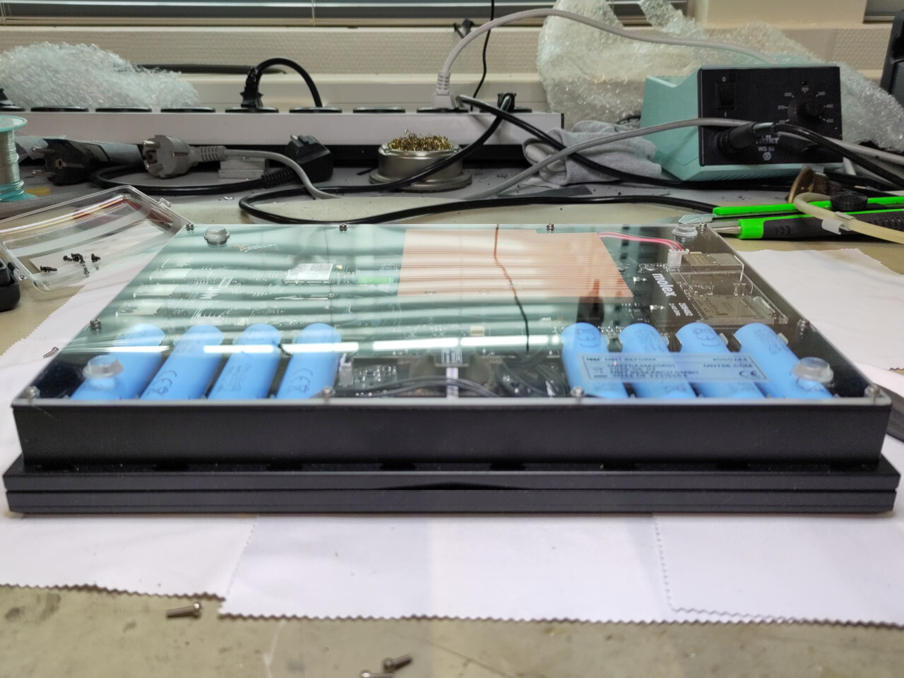

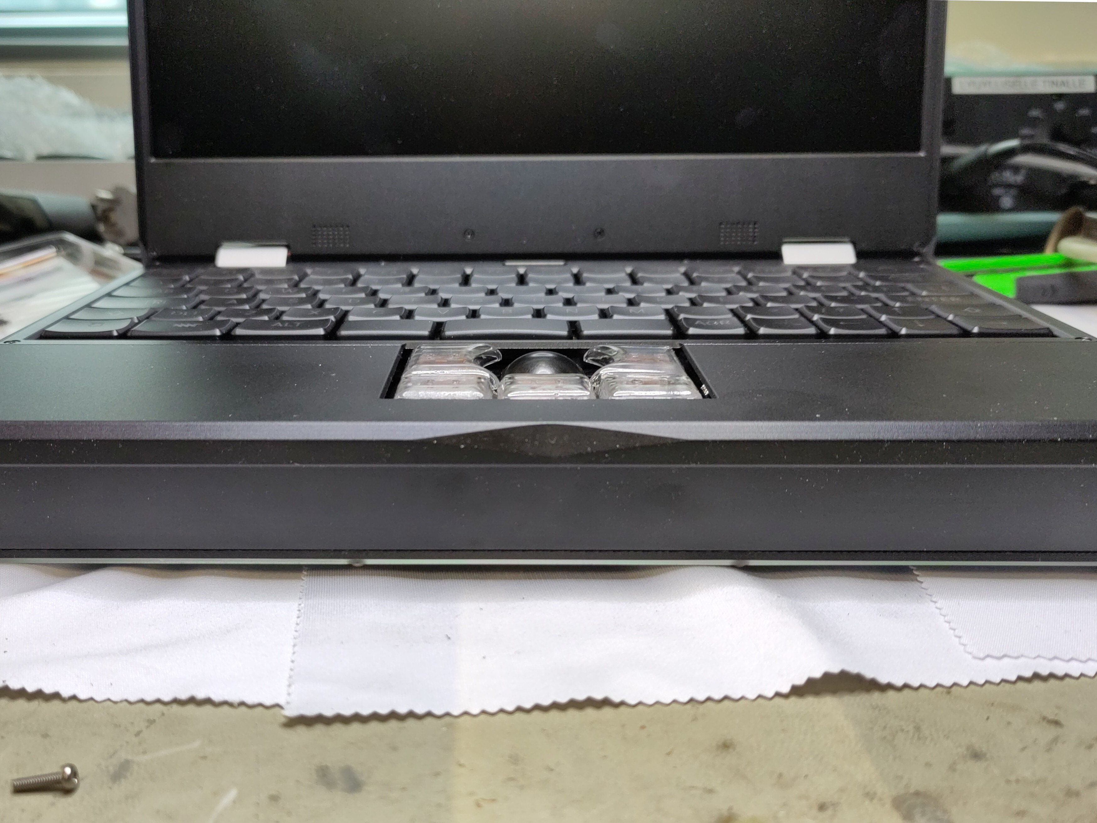

Keyboard bulges out with RK3588
Here’s something I just noticed: the heatsink of the RK3588 module sits flush with the aluminum case’s lid. As a result, when the bottom plexiglass lid is screwed closed, it pushes the entire board upward, and the keyboard with it because of the standoff under the keyboard’s PCB. So both the keyboard and the plexiglass plate bulge out.
Anything I can do, short of 3D-printing a bottom cover with extra space for the heatsink?

I modeled a 3D-printed spacer to drop the bottom 2 mm. It’s printing right now. If it works, I’ll post the model.
No more bulging :slight_smile:
Spacer available here:
