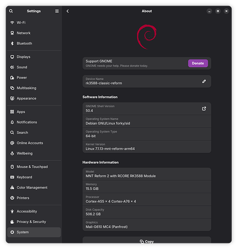

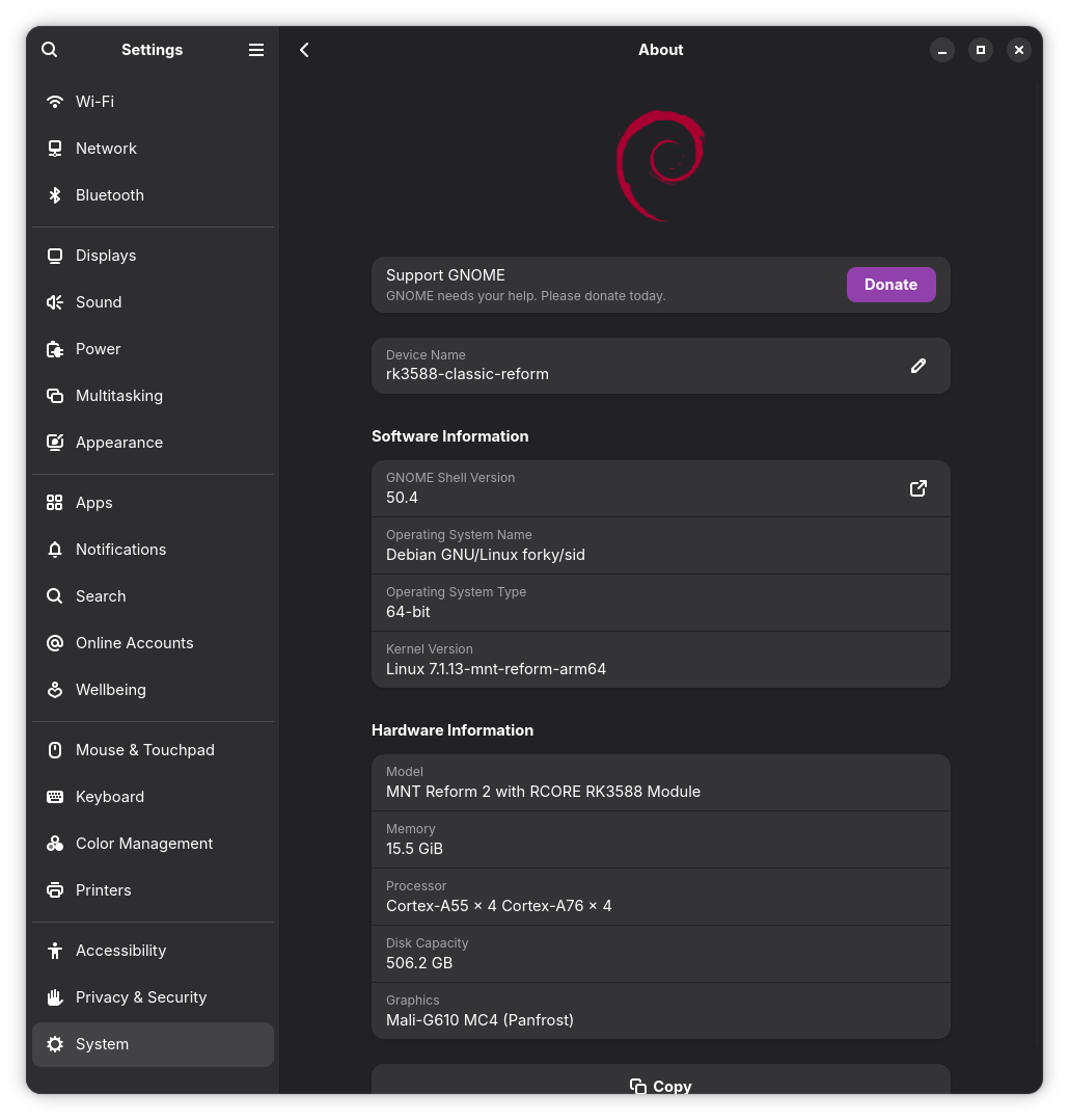

When using /etc/machine-info as a workaround, the about dialog of gnome-control-center could look like this:
