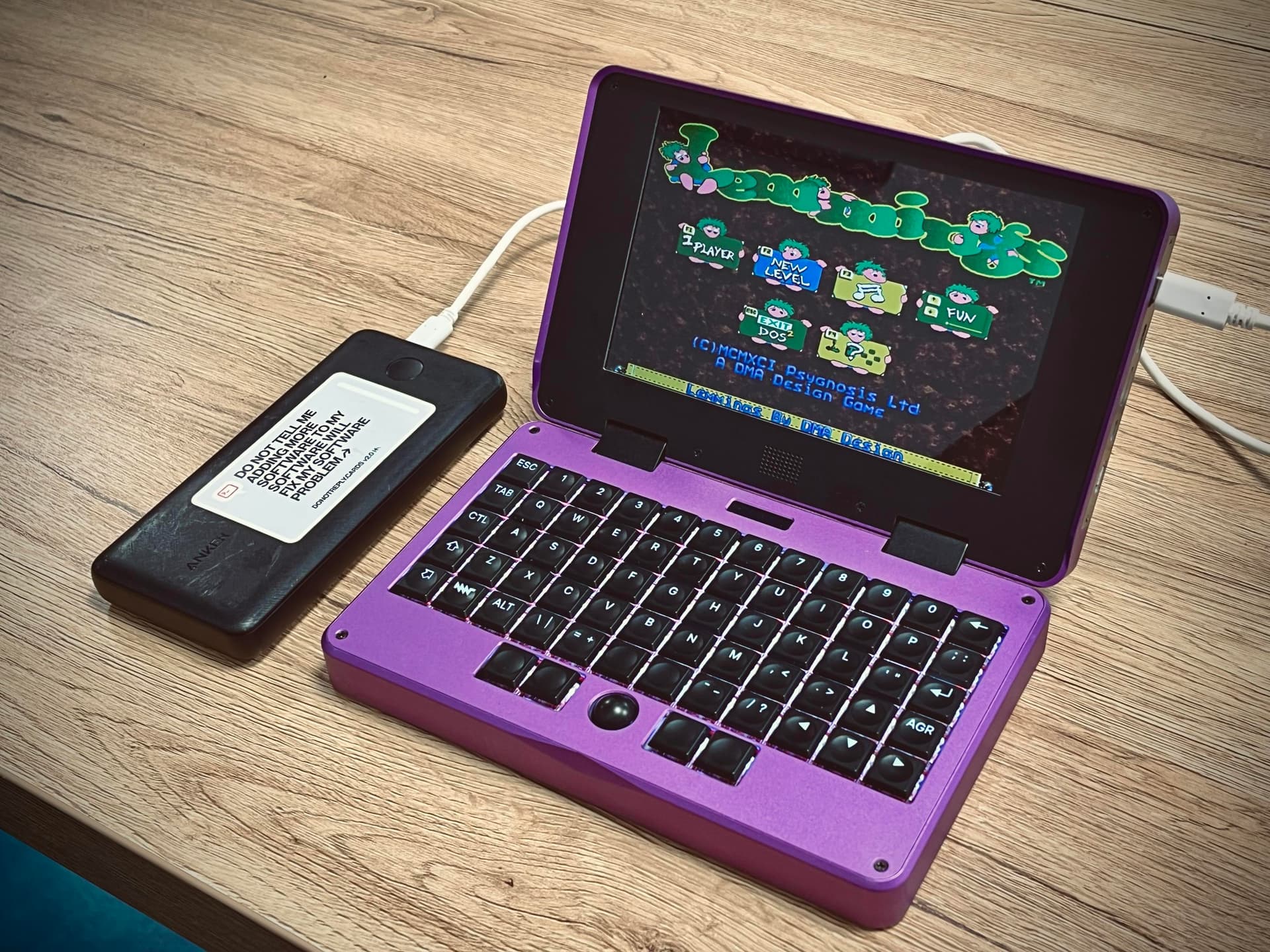

A partner mentioned last night that they loved to play Lemmings as a kid. So I finally set up dosbox in my Pocket …
I’ve installed Pingus, the Open Source Lemmings remake, and it’s running perfectly fine too.

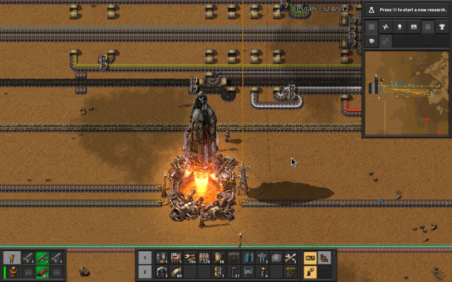

Factorio.
This was already hinted at in the MNT Reform Next Launch Trailer but I wanted to see how well it runs. Turns out, I finished a complete playthrough on RK3588 Pocket Reform. One cannot post videos here, so here is a link to my fedi post: josch: "I just finished my playthrough of vanilla Factori…" - FLOSS.social
You have to set this in your environment for Factorio to work:
MESA_GL_VERSION_OVERRIDE=4.2 MESA_GLSL_VERSION_OVERRIDE=420

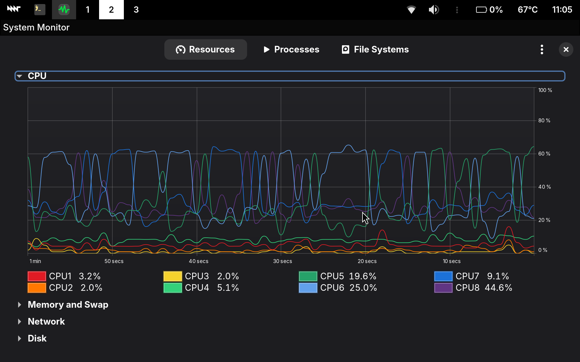

But what amazed me even more than that it’s possible to finish the game without any issues (not a single crash or glitch) was that the game does not even max out the processor. Not even close:
Under box64 it runs with 55 FPS and 60 UPS.
The factory must grow!

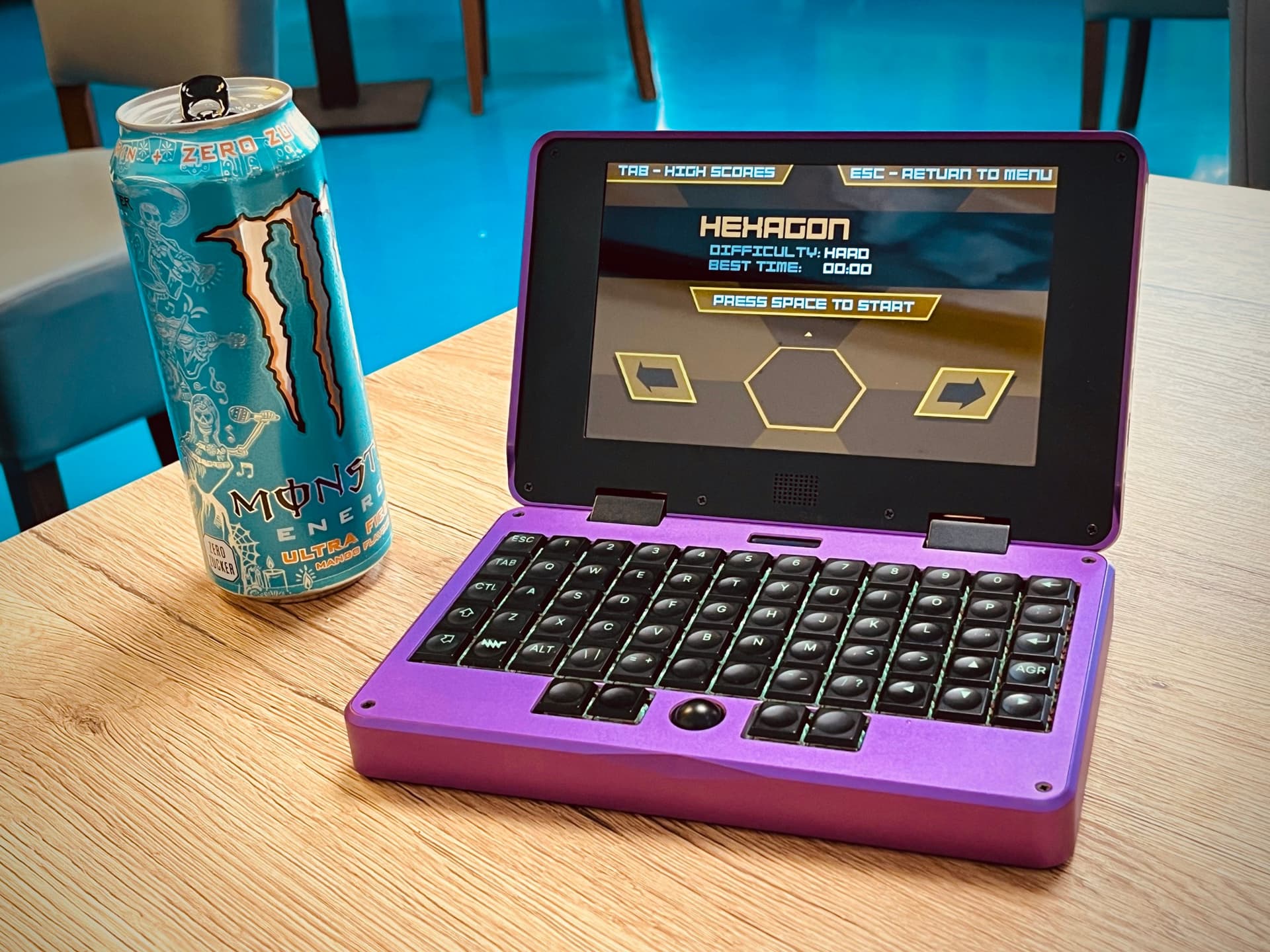

Super Hexagon (Linux Version, x86_64) runs well using box64 on an RK3588 Pocket.
