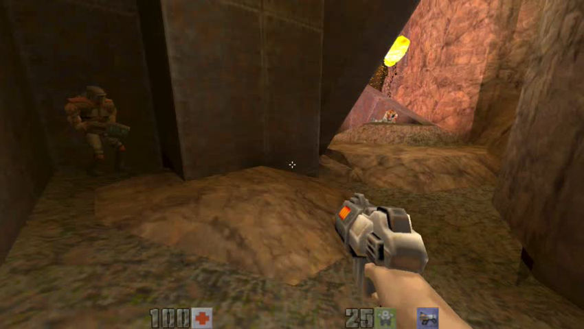

I’ll leave this here, in case other people are interested in running ancient games :slight_smile:
After much trouble getting Quake2 to render fast and correctly on the RK3588, I finally found a combo that works well. See here:
Long story short: I just needed the latest version of Yamagi Quake II and the Vulkan renderer. It was that simple :slight_smile:

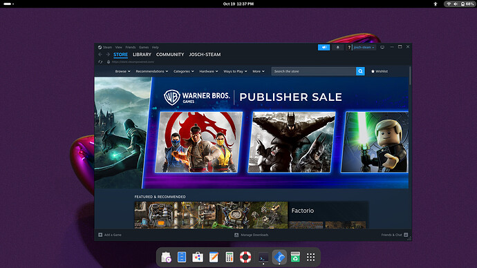

ETA: The steam client starts up and works just fine on the rk3588, but I’m finding getting some things to work challenging – Stardew Valley is fine, but for some reason I can’t get either the itch.io or the steam versions of A Short Hike to work. I can get the “old” itch.io binary to work with box64, but the shadows don’t render right and makes a weird flashing of the color rendering. The “current” one starts, but after rendering the logos it just stops, with no errors on console, but mono_crash json & mem.blob files.
I just uploaded the latest release of box64 to Debian unstable. If you have rk3588, then you can install the box64-rk3588 package instead of plain box64 which was compiled with some rk3588-specific optimizations. The package has box32 enabled, has the box32 binfmt support enabled and ships a script to install steam. With that version, installing steam is as simple as running:
sudo apt install box64
/usr/share/doc/box64/examples/install_steam.sh
You can then run steam from a terminal but maybe consider running it with PAN_MESA_DEBUG=gl3 set or otherwise some games will complain about missing opengl3 support. Kudos to @minute for pointing me to this setting. Here is the relevant thread on fedi: lucie lukas "minute" hartmann: "ok looks like things have progressed in ARM64 lan…" - Mastodon
