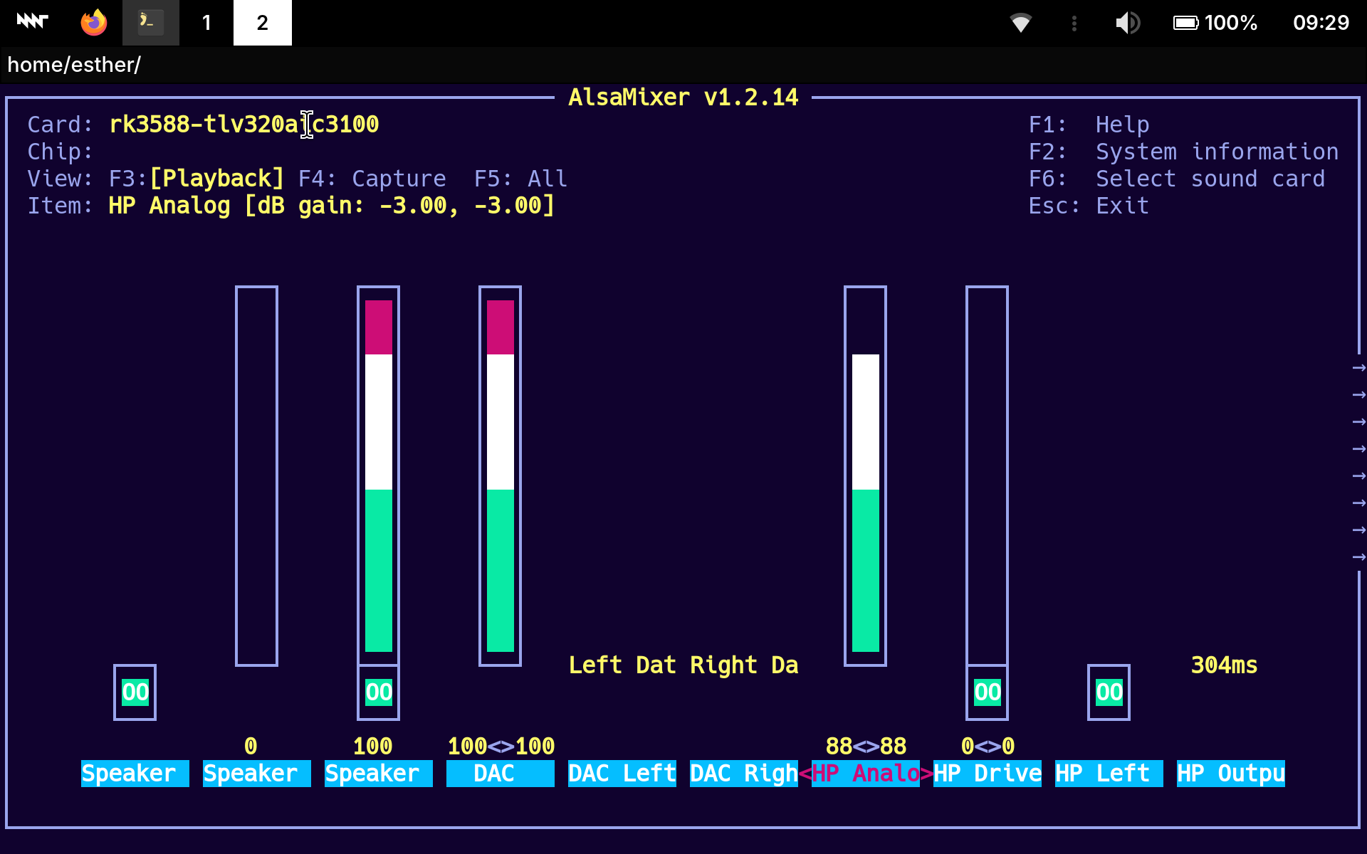

I’m having this problem here with the RK3588 board and none of the scripts or options mentioned above successfully mute the speakers separately from the headphone jack.
The ā€œMuteā€ control seems to be global for all audio, but you can set the volume to zero on the speaker while still having it turned up on the headphones (as in the screenshot).
