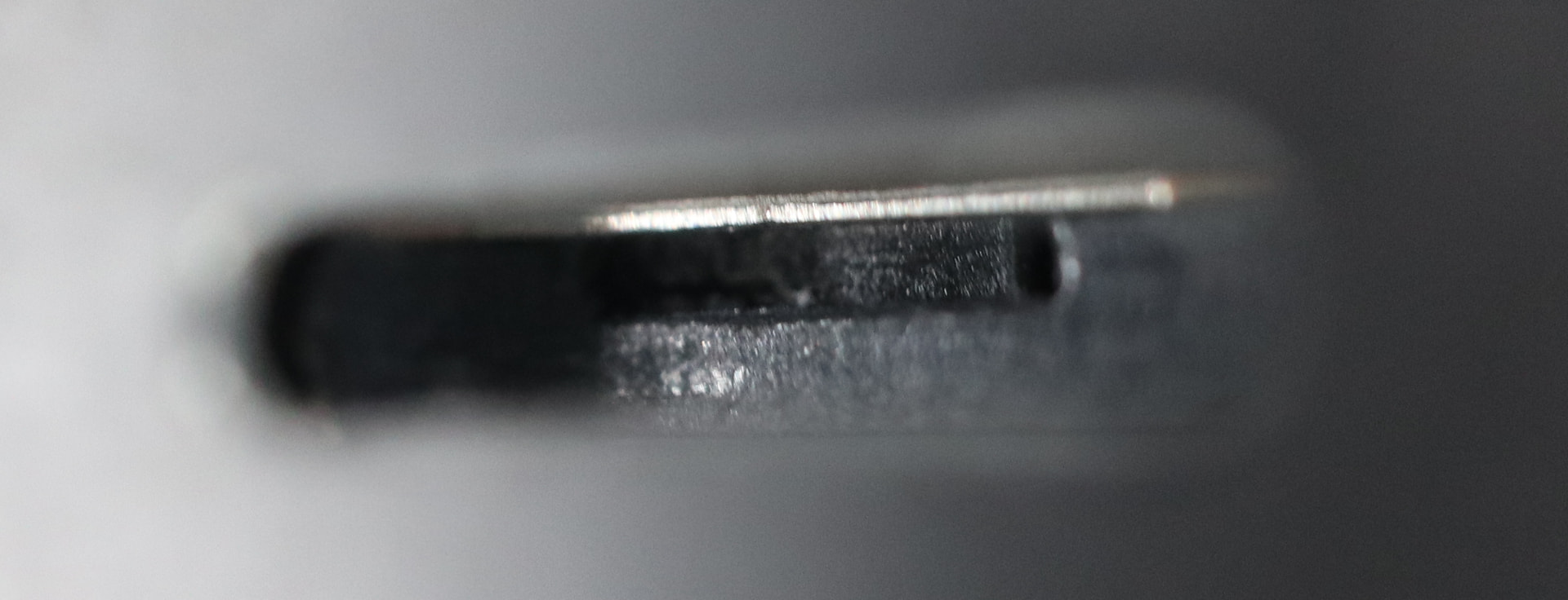

Thanks for all your suggestions. I did not try it for a while because I traveled, and I did not bring it with me. I tried today, following the instructions on the MNT Support site. There is an issue with the switch. In the attached image, I cannot see something I can move in the switch hole.

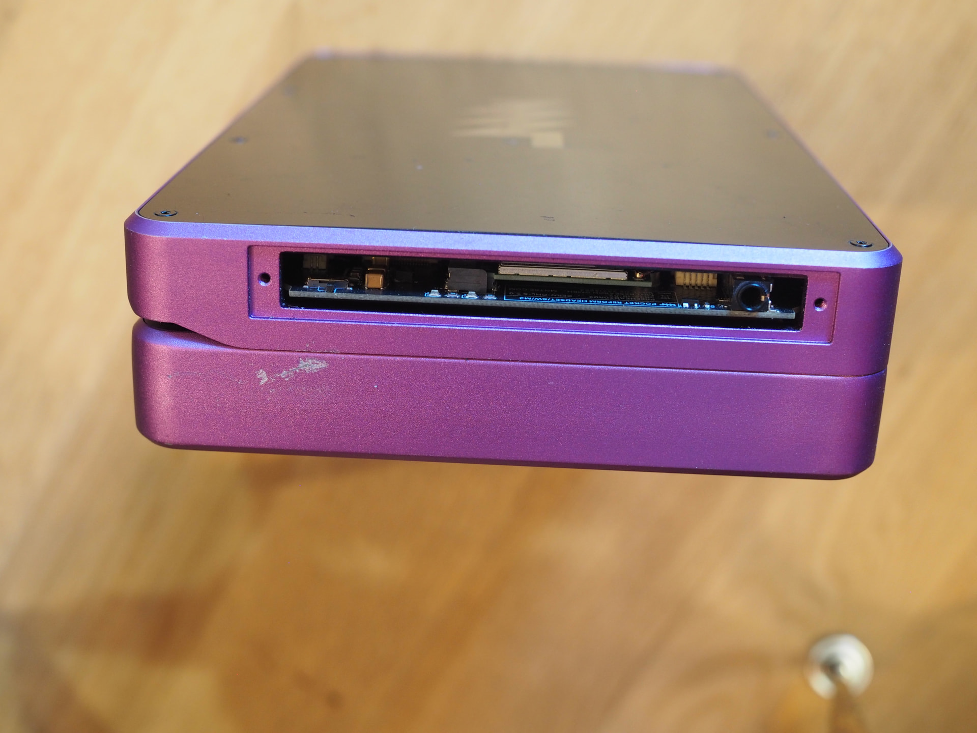

You can see things much better after opening the side up. It should look like this:
From your photo it looks like the switch is in the “ON” position (like it is for me).
As others have said, I think your options are mailing support and waiting or going to https://support.mnt.re/ and have a look yourself using the instructions there.

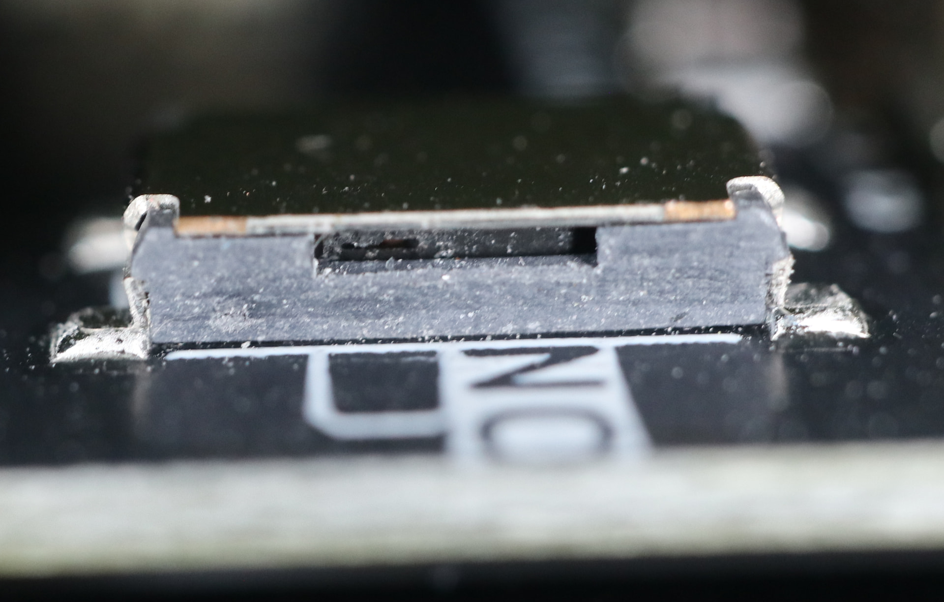

Thanks, I opened it and took the following picture:
I think that the switch is set on position off, which explains why it is not charging, and it appears that the knob is broken because I see a knob in your picture but not in mine. By the way, this is too small; I cannot see directly with my eyes, but with the camera.
