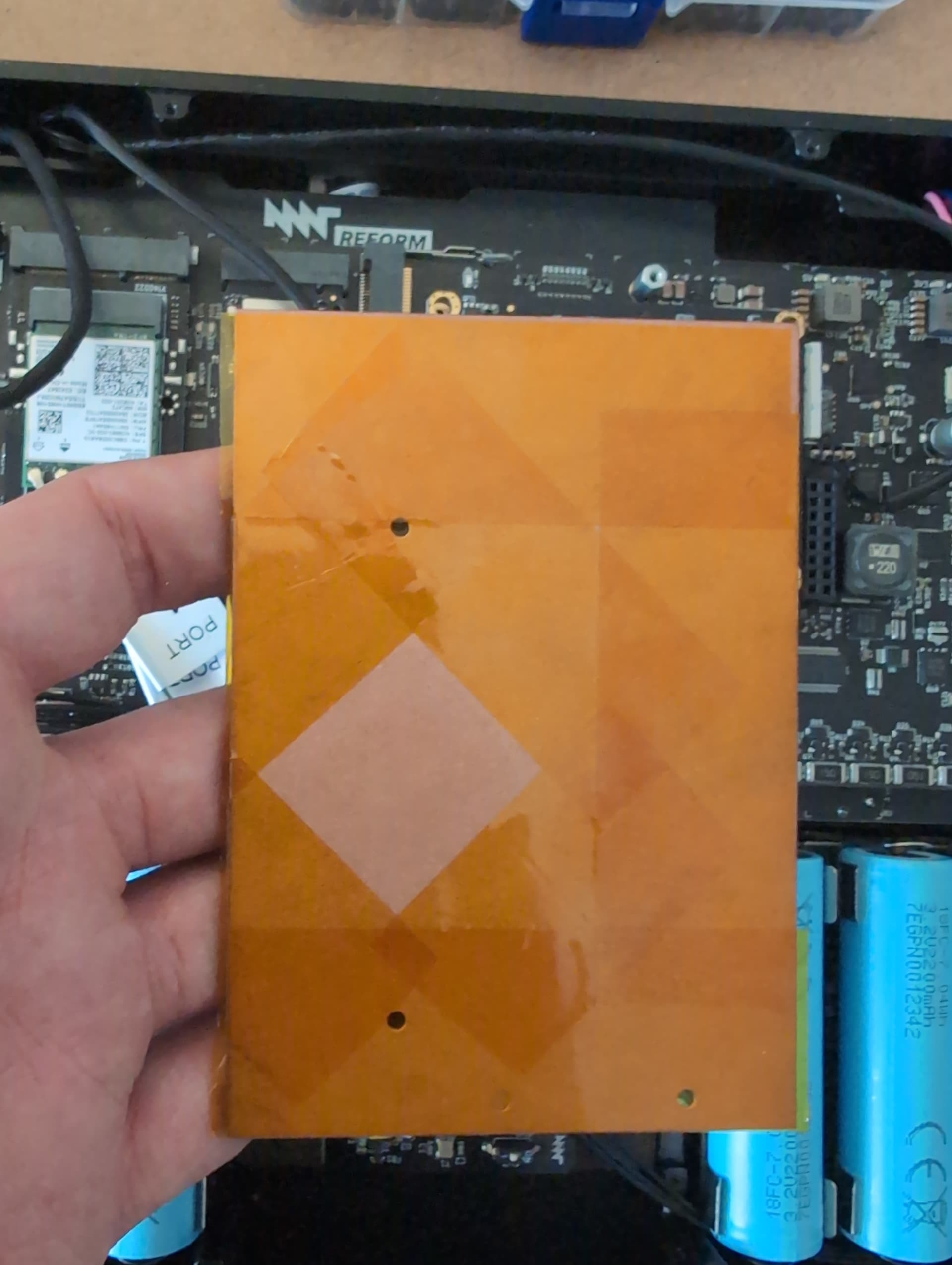

I taped the heatsink like this. But USB still does not work :frowning:.
Sorry to hear, sounds like a pressure/mechanical related issue then, where the assembly prevents good contact perhaps? If you’re in the EU, it might be a quick option to send the whole machine to us for free warranty inspection.
Well it works with the tape. I forgot that pressing enter on the LUKS promt does not do anything.
