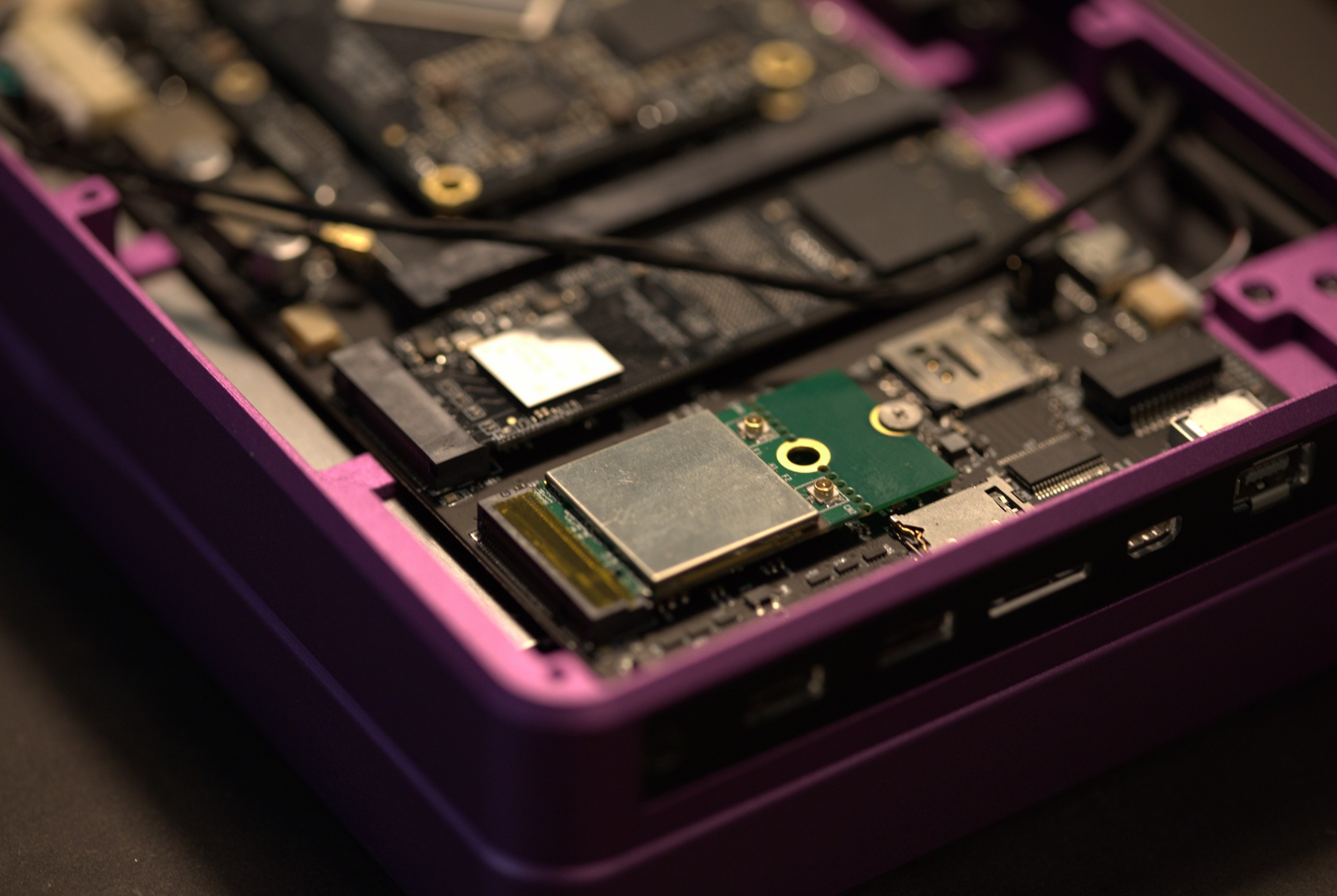

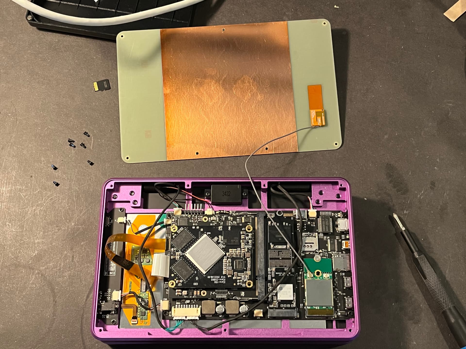

I installed the Wifi adapter according to the instructions, secured it with the included screw and used the new antenna (attached to the new backplate). I removed the old antenna.
(the antenna cable is connected, i just didn’t take a photo of that before closing the case again.

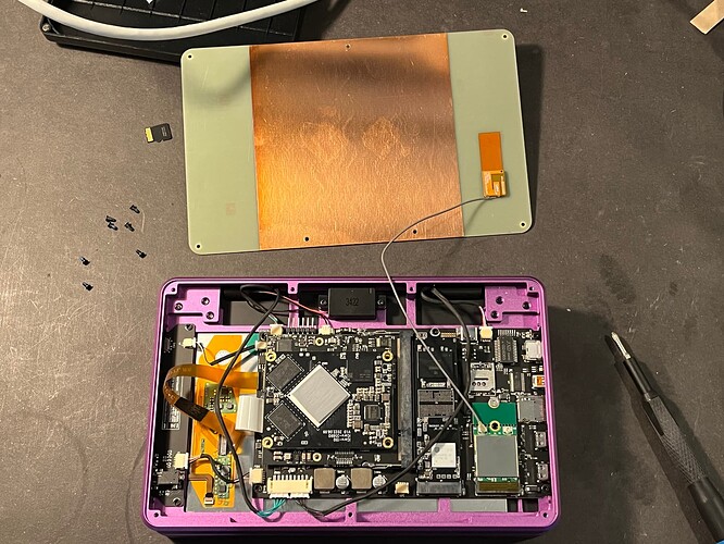

I opened it up to check, looks the way it should (I think) according to the upgrade instructions
