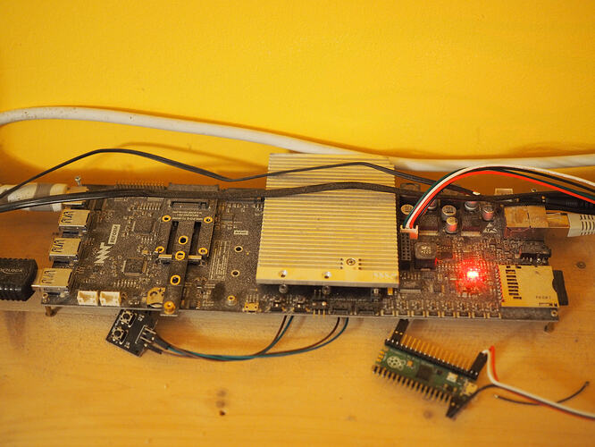

Today marks the first birthday of my Kodi based mediacenter setup called “MM Board Reform” (mister-muffin Reform on a wooden board). This is not ISO grain on the photo below. In the absence of the MNT Desktop Reform aluminum case it has gathered a lot of dust:
The system is running Debian from an SD card (which probably only survives because there are not many writes during normal operation) and under the cooler is the A311D which is perfect for a Kodi based mediacenter setup because:
  • not only do I get hardware accelerated video output but I can also
  • control kodi using an infrared remote of the TV attached via HDMI
To switch this on I’m using a RP2040 board with the following micropython script running on it:
