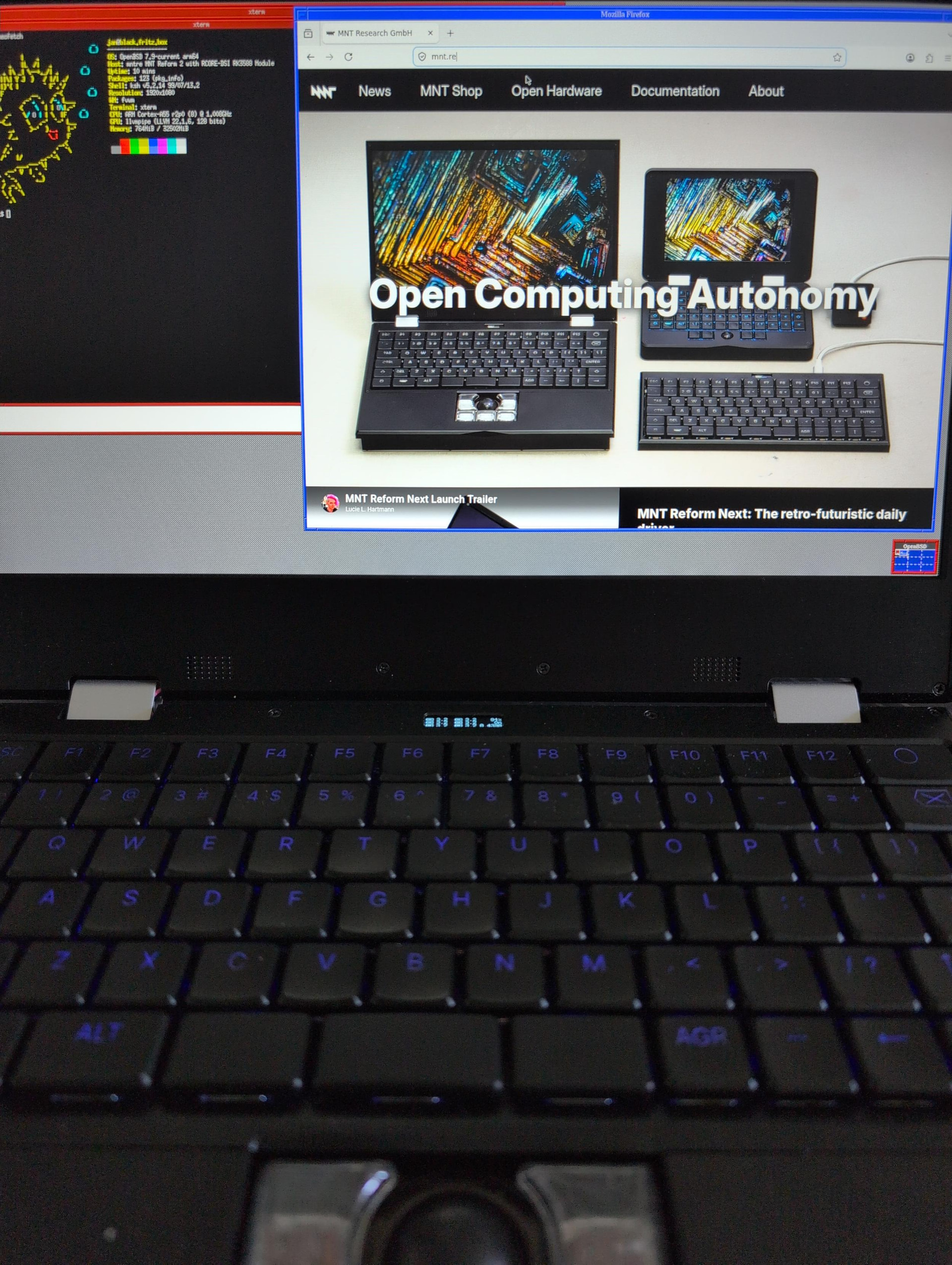

For good measure a picture of my MNT Reform:
