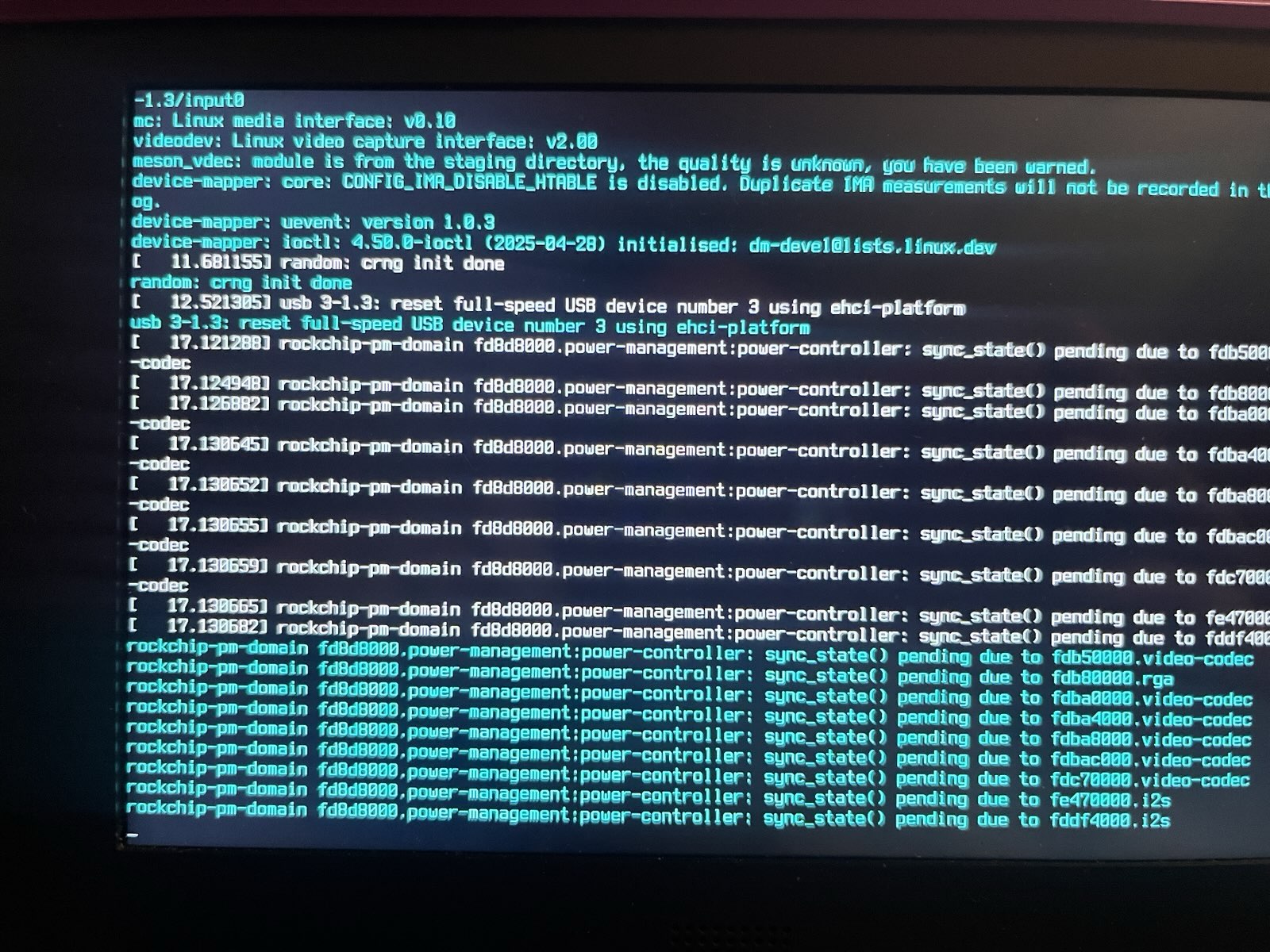

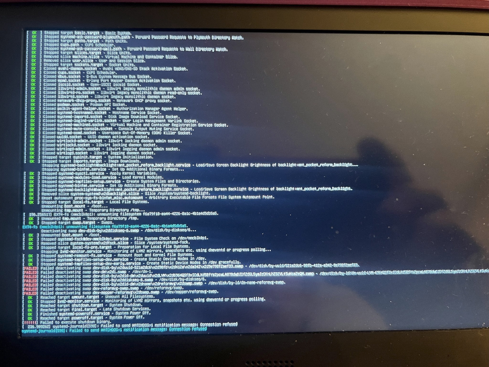

I did try to use dmesg and journalctl to get some ideas about what is going on but I am not experienced enough to know what I should be looking for. There are also errors during boot, see attached - but I am not sure whether this is expected. The systems stops during boot so I can enter the password for the encrypted SSD. Also the screen at shutdown shows some errors.
