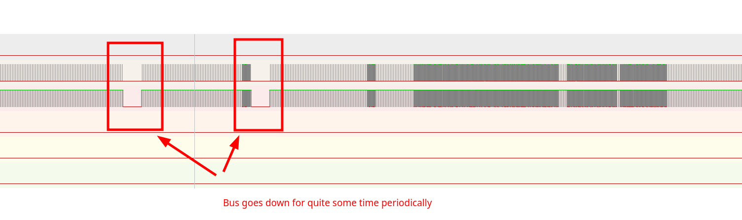

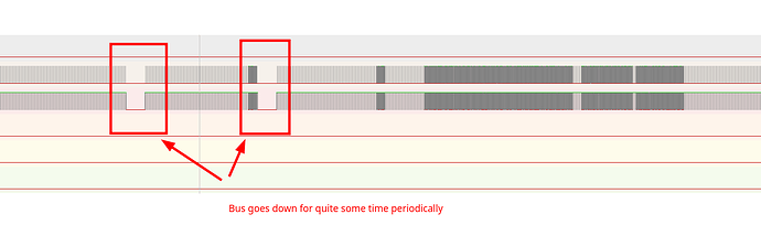

Some Traces (before battery change):
I was commenting with @minute in IRC about the problem, and to double check the cable I crimped a new one to test if there was any change at all.
With the new cable the problem persisted, so either I crimped it terribly (which could be) or the problem lies somewhere else.
I wanted to share here the USB tracing that I captured and saved in a format valid for pulseview/sigrok. (https://app-share.mailbox.org/appsuite/api/share/04f05e2f012695414b67deb126954532a4abbda9afd6c11c/1/8/NDQ/NDQvNQ).
On a small analysis I can see the bus halting for some time periodically, and afterwards there is more activity, I guess is the re-negotiation of the firmware with the system. This happens soon enough after powering on, less than 2m in.
