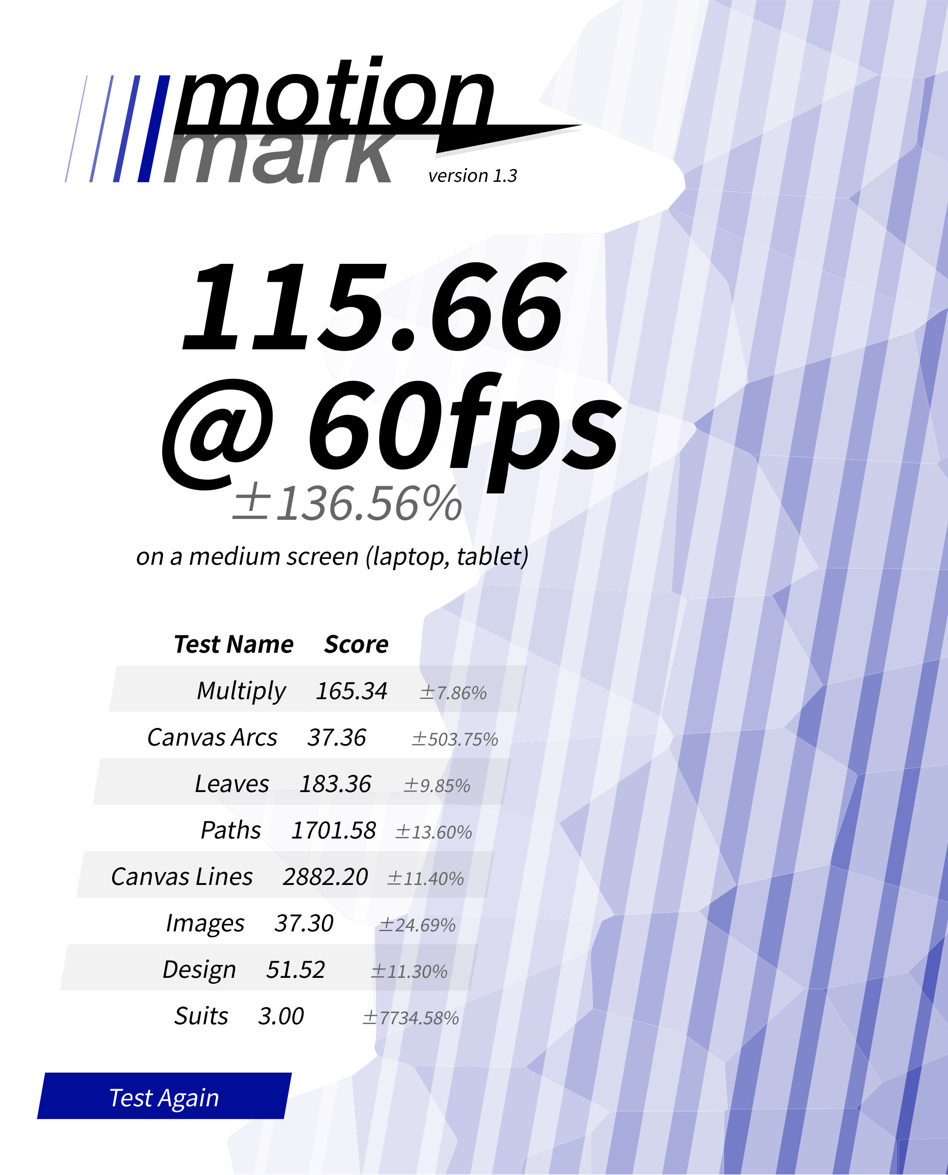

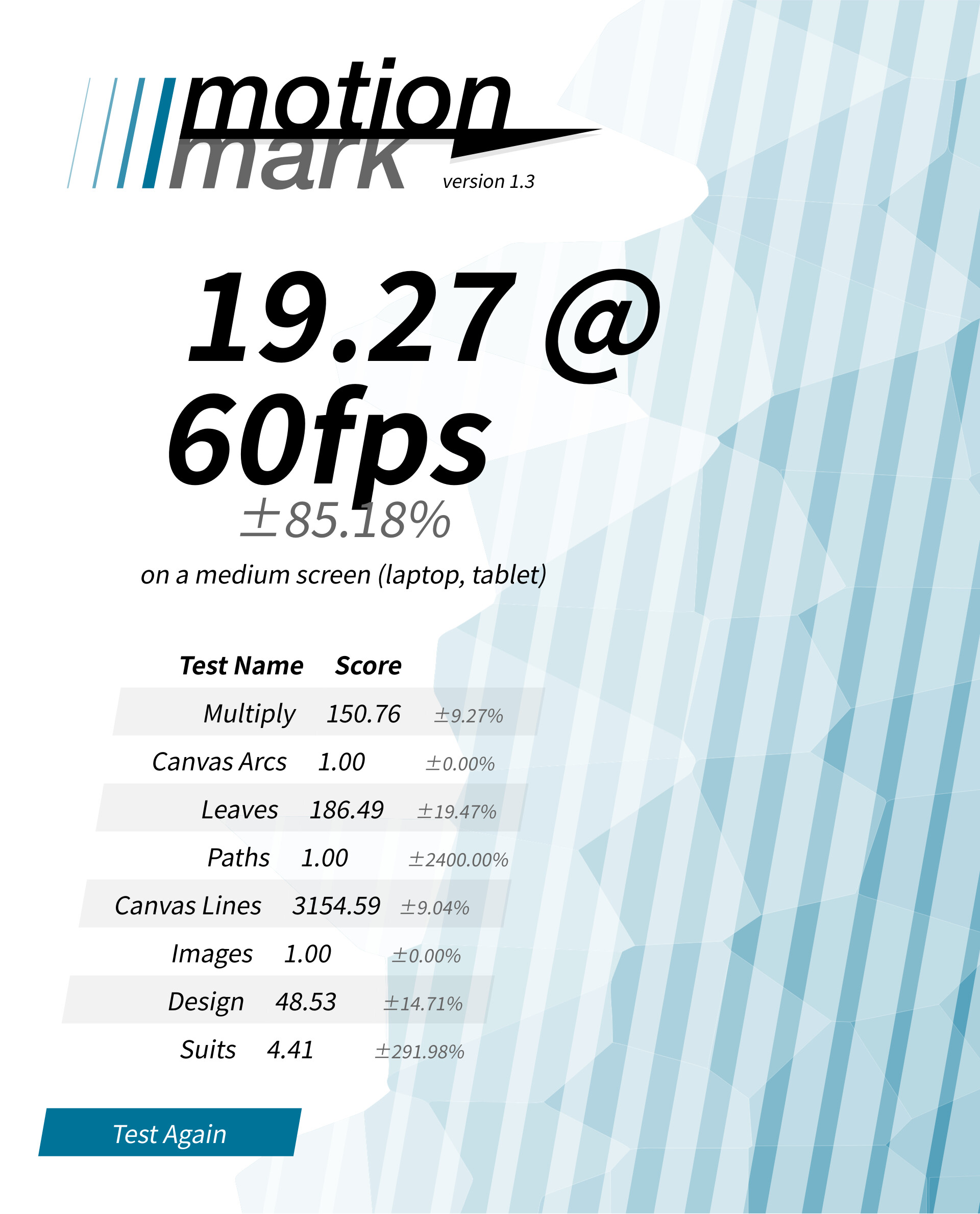

With RK3588 Pocket Reform + Firefox 138/139, I found some sites, such as MotionMark and RP2040 datasheet are unusually slow and laggy.
After some investigations, the bottleneck was turned out to be texture format conversions in Mesa.
I managed to workaround this by applying a small patch to Mesa.
With this patch, MotionMark score drastically jumped up from 19.27 to 115.66!
Also there were noticeable performance improvements on various sites.

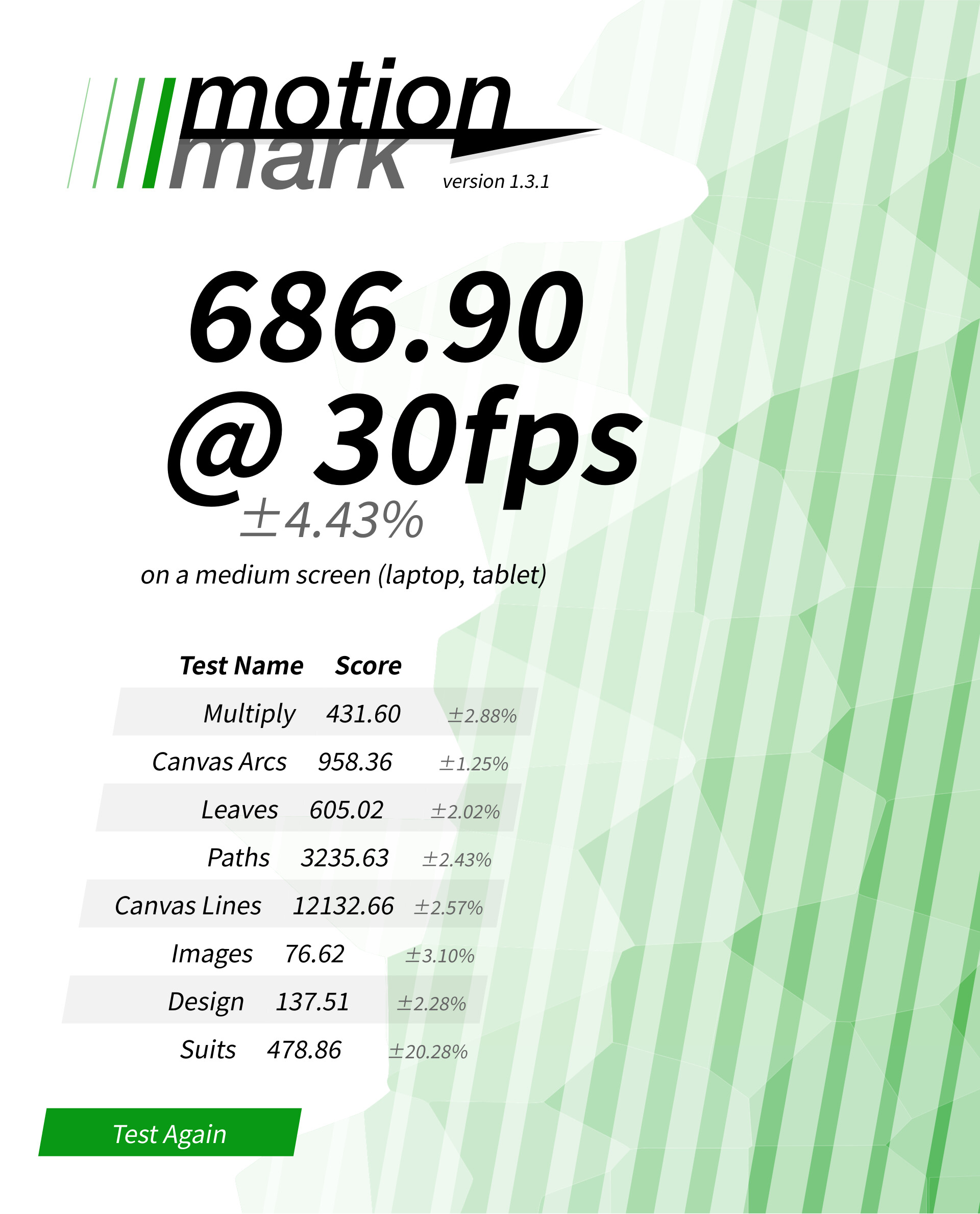

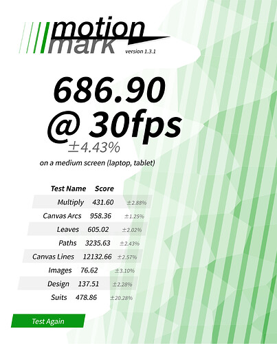

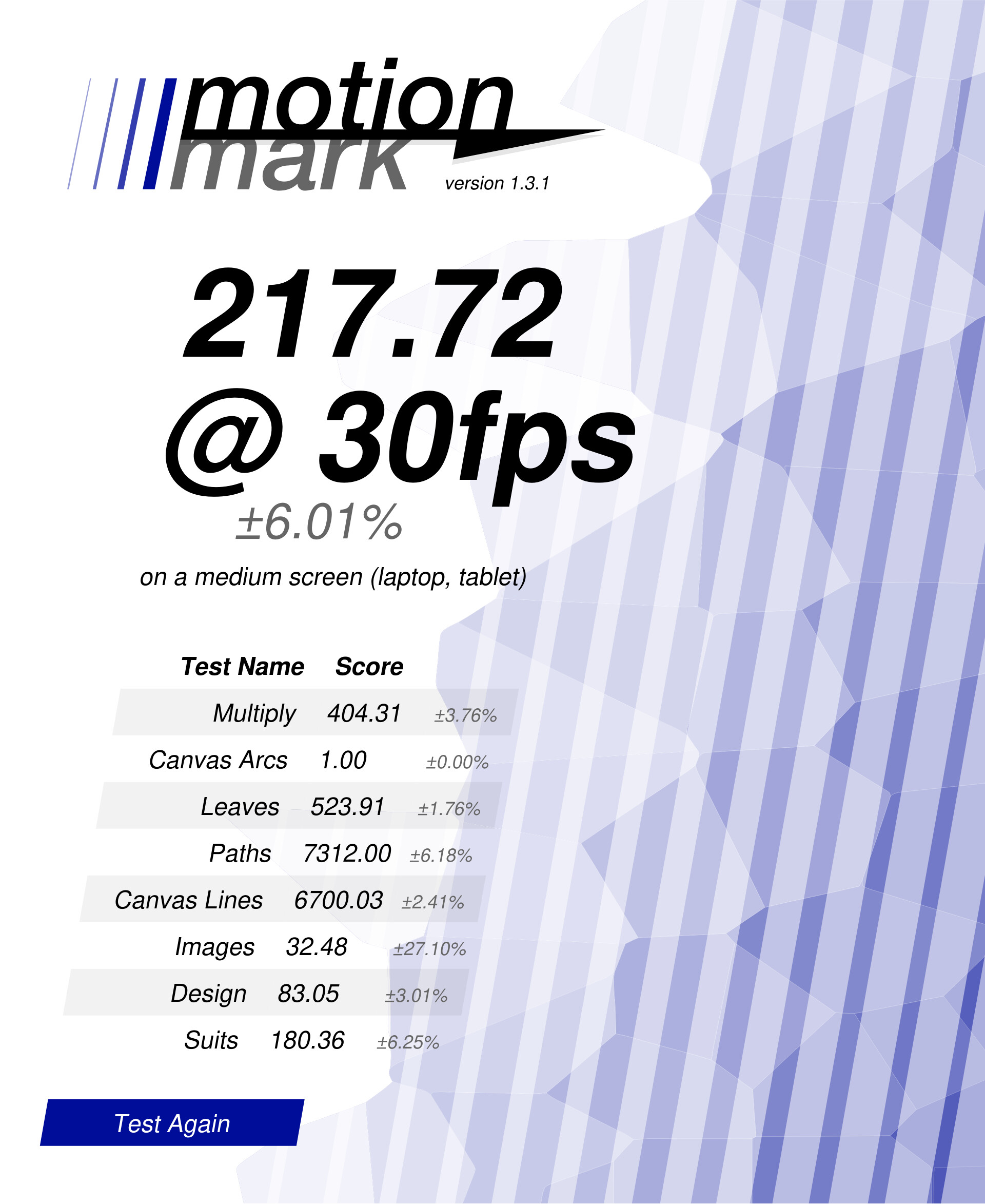

I measured 1.3.1@30fps scores on normal debian and patched gentoo.
Here are results: 217.72 vs 686.90

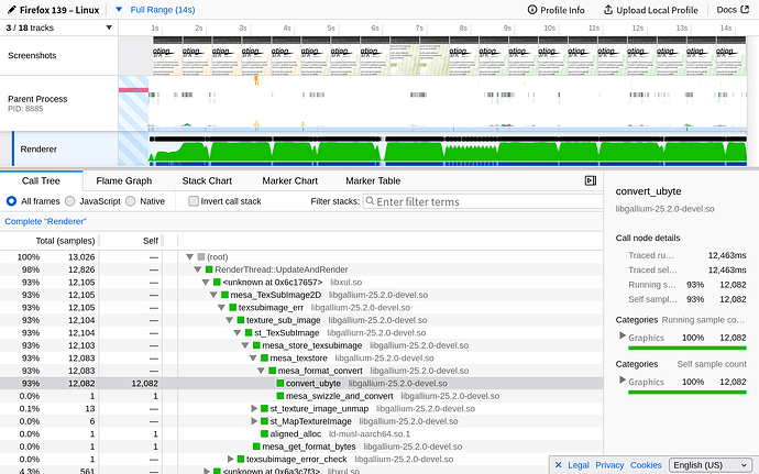

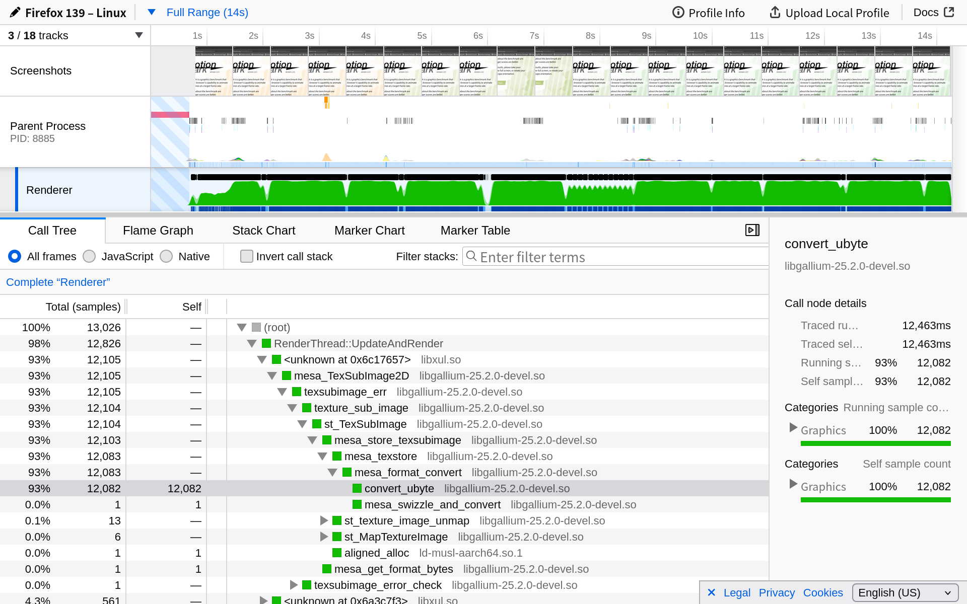

Here’s the rough process of how I created that patch:
  • To begin with, I captured profiles while viewing laggy sites.
  • As you can see, most of the cpu time was consumed in the mesa_format_convert function
  • I put debug prints to mesa, and found firefox calling glTexSubImage2D to upload BGRA image to RGBA texture, causing format conversion.
  • Since the panfrost gallium driver disables blit texture transfer, the format conversion falls to software implementation, which is very slow.
  • So I enabled it with the first patch. This worked like a charm.

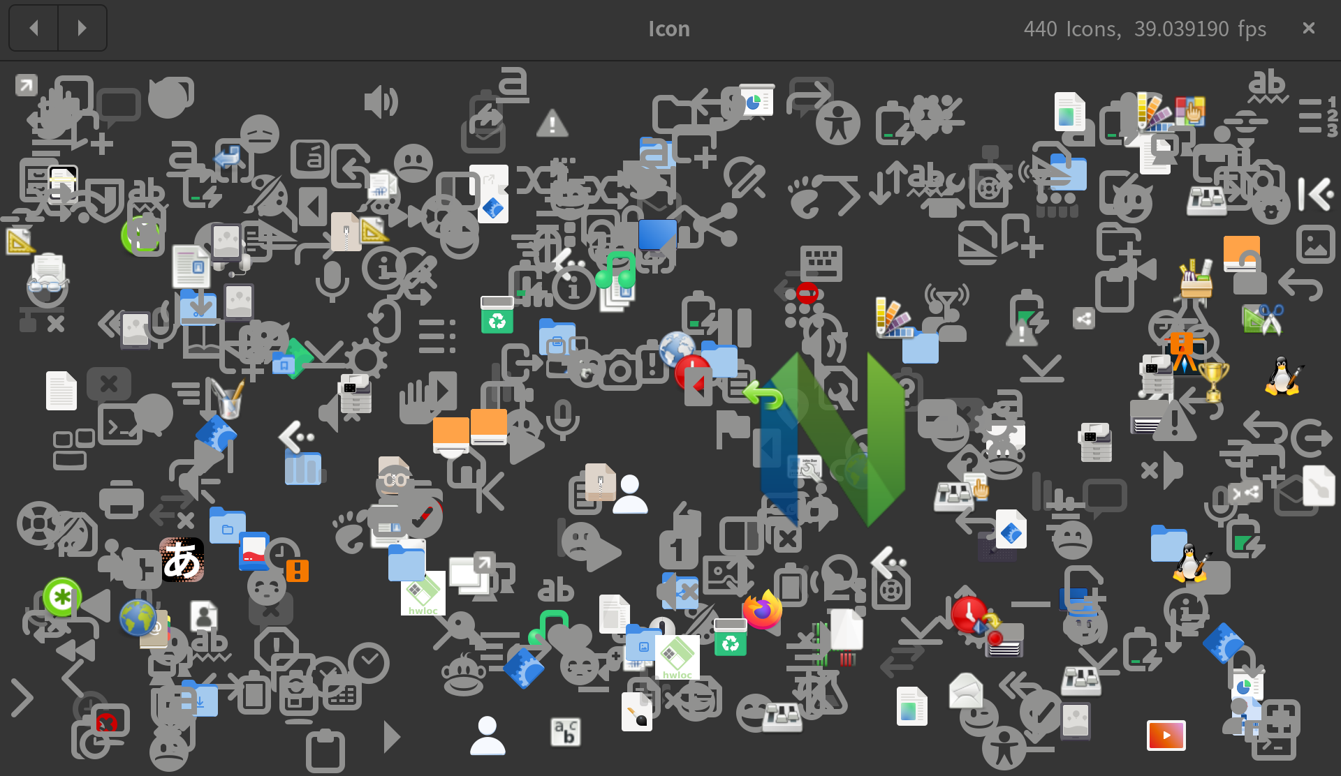

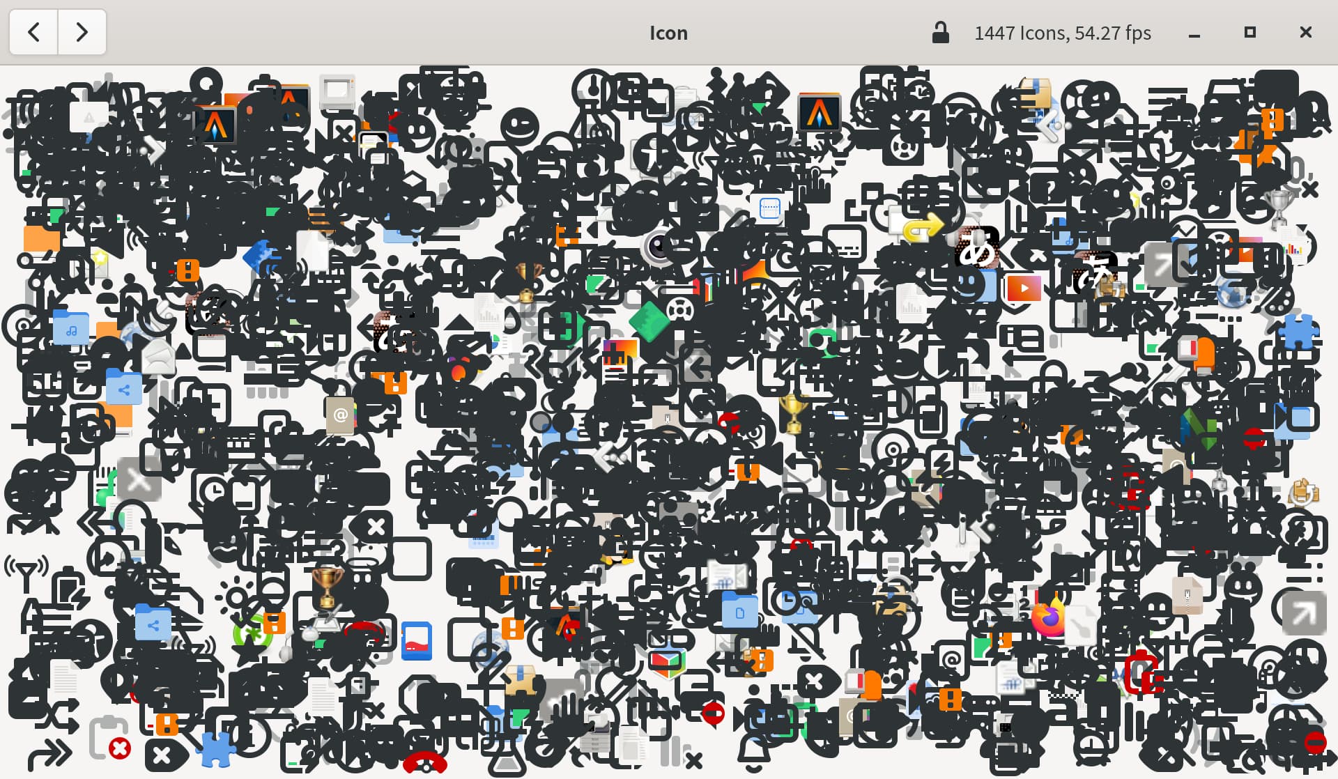

Thanks for the great explanation! I’ve had similar issues for GTK3 apps in GNOME where there were a lot of weird texture format conversions. It wasn’t clear though that this could be fixed in mesa. I tried your patch and indeed Firefox is much faster now, which is awesome, because I really didn’t enjoy being locked into Chromium for performance reasons. I’ve passed this on to the relevant mesa devs and they confirmed this is a “great find” and I guess they’ll do something to fix it.
A tiny update: gtk3 “Fishbowl” demo/benchmark is not fixed by this, so that’s a different, but maybe related problem. If you’re curious, you can see it if you open gtk3-demo and go to Benchmark->Fishbowl and make the window fullscreen. FPS will suffer a lot. The same benchmark in gtk4-demo doesn’t have this issue.
Ok I’ll look into that.
I’ve tried both of gtk3-demo and gtk4-demo, but couldn’t find such an major FPS suffering.
The performance difference between them shown above is understandable,
since GTK4 utilizes OpenGL to render widgets while GTK3 doesn’t.
