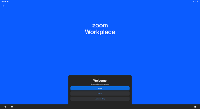

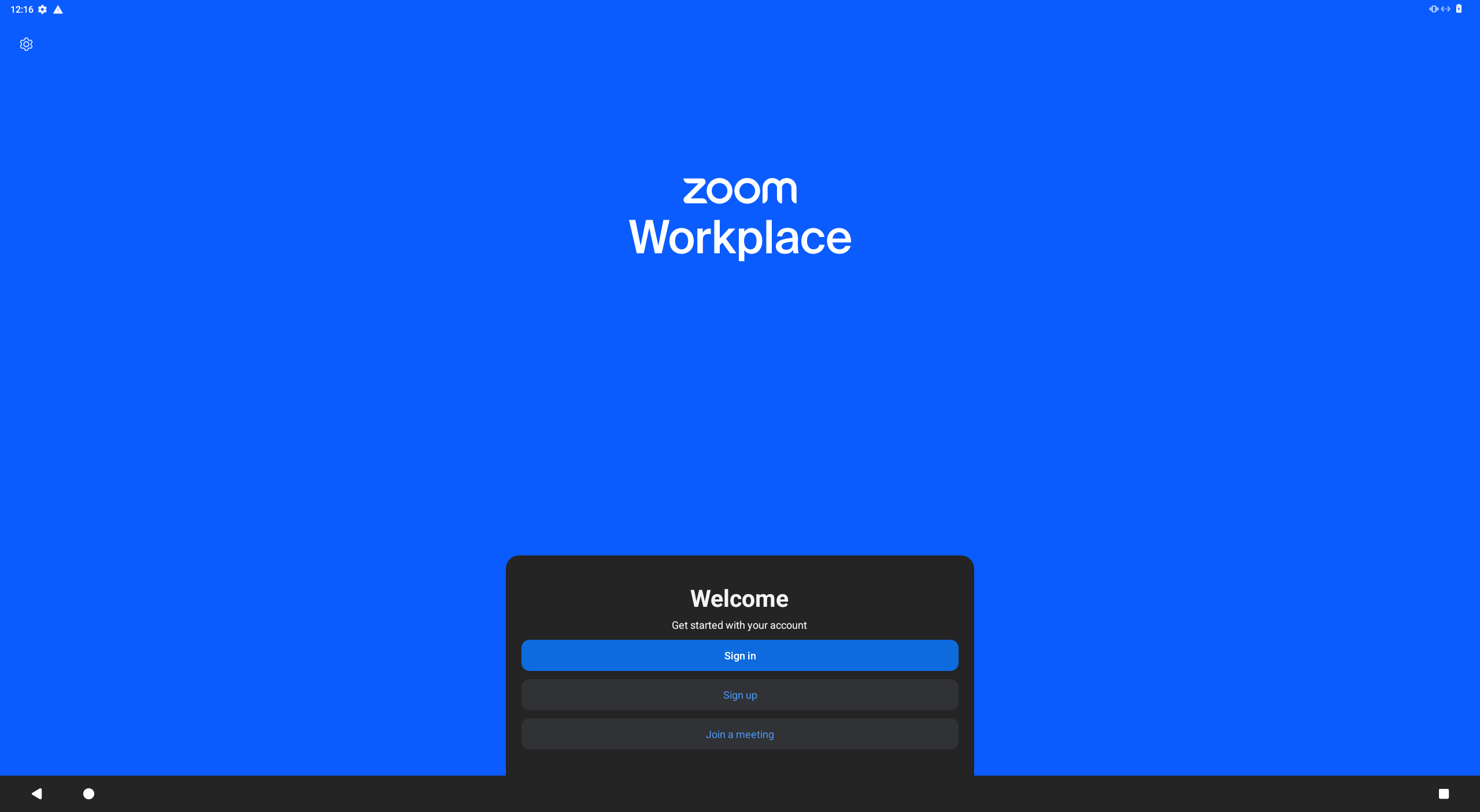

Right, I got further than that by tweaking some BOX64 env vars but didn’t get it to work because of glib incompatibility issues.
But it starts in waydroid (which is surprisingly snappy). I don’t have an account to test though.
