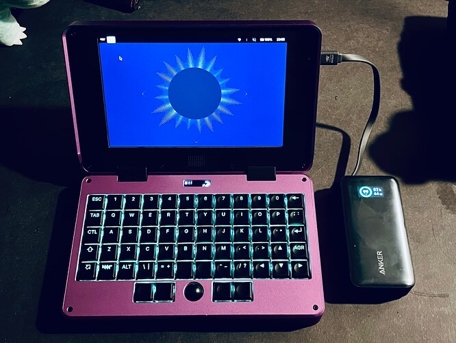

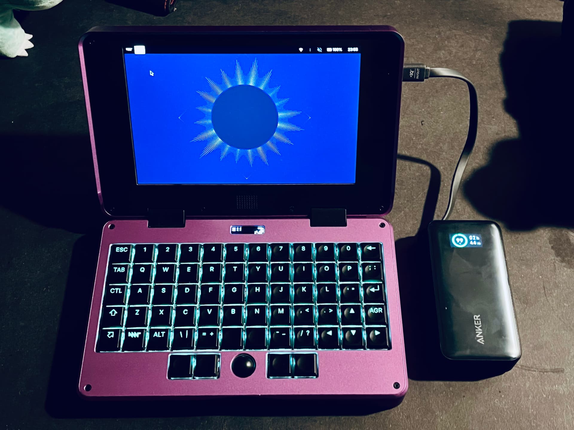

Thanks, the firmware update helped with the charging issue so now this cute setup works:
Nice setup. Thanks for the feedback!
