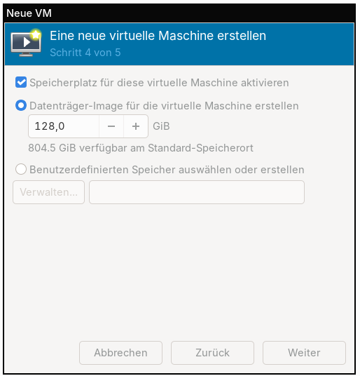

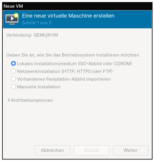

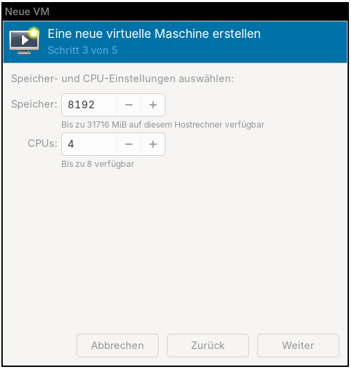

I can also set up a VM:

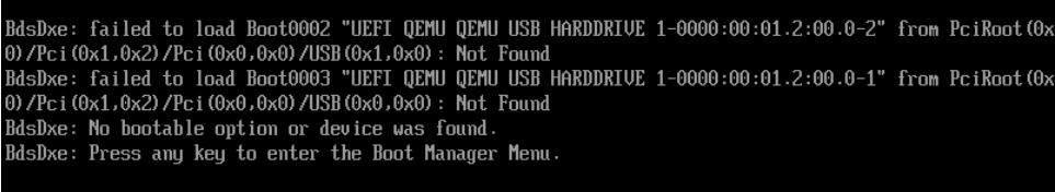

However, after it starts, the message “No bootable option or device was found” appears and nothing happens.

I’m using Virtual Machine Manager 5.1.0.
I created a new VM using the WIN11-Arm64 ISO.
After the VM was created, it booted up and the following error message appeared:

That error is the EDK2 UEFI boot manager telling you that it looked through the boot options and attached devices, but did not see anything with a bootable EFI loader.
A few things could be wrong:
  1. Make sure the VM is actually ARM64, not x86_64 (easy mistake, ensure the VM Architecture is aarch64)

[stephano@daisuke Downloads]$ sha256sum Win11_25H2_German_Arm64_v2.iso
844d9ee8413874b2f1fccad2222222d5bf138fa07511edd22bb4acdd17895ede  Win11_25H2_German_Arm64_v2.iso
You should get similar output to what I have. Especially the SHA checksum should be the same.
I’d be happy to download the ISO file again.
Here are the results using the existing file:
ls -lh
-rw-r--r-- 1 libvirt-qemu libvirt-qemu 7,5G 12. Jul 17:02 Win11_25H2_German_Arm64_v2.iso
micha@mntremk:~/Downloads$ file Win11_25H2_German_Arm64_v2.iso
Win11_25H2_German_Arm64_v2.iso: ISO 9660 CD-ROM filesystem data 'CCCOMA_A64FRE_DE-DE_DV9' (bootable)
micha@mntremk:~/Downloads$ sha256sum Win11_25H2_German_Arm64_v2.iso
You have indeed found some odd behavior here. Well done. :slight_smile:
Since the file is the same as mine, but xoriso seems to think it is a blank piece of media, it stands to reason that something inside qemu is also making that mistake. But qemu doesn’t use the same libraries that xoriso does (for reading optical media), so I’d start with your settings:
virsh list --all
virsh dumpxml "<vm-name>" > windows.xml
virsh dumpxml "<vm-name>" > debian.xml
You’ll need to change those VM names to whatever your windows and debian vm instances are called.
Then send me those files via pastebin or the like. I’ll have a look.
I had no idea I could do something like that :upside_down_face:
But I was immediately reminded of my limitations:
virsh list --all
virsh dumpxml debian13 > windows.xml
virsh dumpxml win10 > debian.xml
 Id   Name   Status
error: Abruf der Domain 'debian13' scheiterte
error: Abruf der Domain 'win10' scheiterte
I’m assuming the VMs have to be turned on for that?!
Try:
sudo virsh list --all
Then you should see something like:
Id   Name        State
 -    <some-vm>   shut off
 -    <other-vm>  shut off
Then just take those VM names and add them to the commands:
sudo virsh dumpxml "<some-vm>" > windows.xml
sudo virsh dumpxml "<other-vm>" > debian.xml
I’m almost too nervous to post the result:
[sudo] Passwort für micha:
 Id   Name              Status
 -    alpinelinux3.21   ausgeschaltet
 -    debian13          ausgeschaltet
 -    win10             ausgeschaltet
micha@mntremk:~$ sudo virsh dumpxml "<win10>" > windows.xml
error: Abruf der Domain '<win10>' scheiterte
micha@mntremk:~$ sudo virsh dumpxml "<debian13>" > debian13.xml
error: Abruf der Domain '<debian13>' scheiterte
