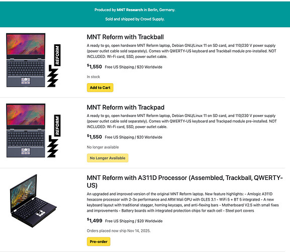

First, when I go to Crowdsupply to buy an MNT Reform, I see the following options (see screenshot):
The top two options seem to be the same up to the choice of trackball or trackpad. My confusion is the difference between options 1+2 and the third one. The third option - “MNT Reform with A311D Processor (Assembled, Trackball, QWERTY-US)” - is described as “[a]n upgraded and improved version of the original MNT Reform laptop”. Does this mean it is an upgraded version of options 1+2, or are they all the same at this point except for the SoM? Relatedly, if option 3 is indeed better than options 1+2, comes with more addons and has a better SoM, I am confused why it is 50$ cheaper.

Hi, I don’t live in the USA and I have not bought my hardware from Crowdsupply but nobody else seems to be answering so here goes what I know from other forum threads and IRC as second-hand knowledge.
Yes. You are buying from a company from within the USA. The tariffs are applied to things you buy from those from outside the USA.
I cannot tell you why options 1+2 are 50 $ more expensive than option 3. But option 3 will give you a laptop that is much faster than options 1+2. I have used both platforms for 2 years each. First the imx8mq (option 1+2) and now I’m typing this on the A311D which, at least for me, is fast enough to do all the stuff that I need a computer for. The limited speed of A311D (and limited ram) compared to the RK3588 usually only comes into play for me when trying to browse “modern” websites with tons of javascript like youtube, twitch etc.
Note, that to upgrade options 1,2 or 3 with RK3588 you need more than just the firefly icore board (which you can buy anywhere). You also need the RCORE adapter board.
