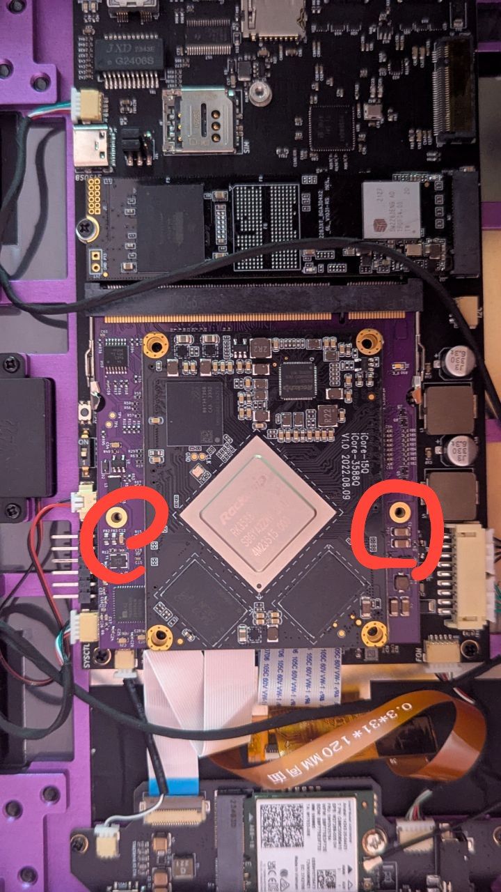

Many thanks to everyone reporting data here. Could you do an experiment: do you have 2 extra little M2 screws? You could borrow 2 from the bottom plate which has plenty. RCORE has 2 gold plated screw holes and there are matching threads on the motherboard. Could you fasten RCORE to these threads (make sure it’s plugged in cleanly and the holes are not misaligned, and don’t force the screws if there is resistance!). I want to make sure that intermittent or non optimal contact of the module isn’t the reason for this.
Can you also check that the two cables on the motherboard going to the charger module (green and black) are as firmly pushed in as possible? And also on the charger module side? (In the bottom half of the device).
Location of the RCORE mounting holes.
