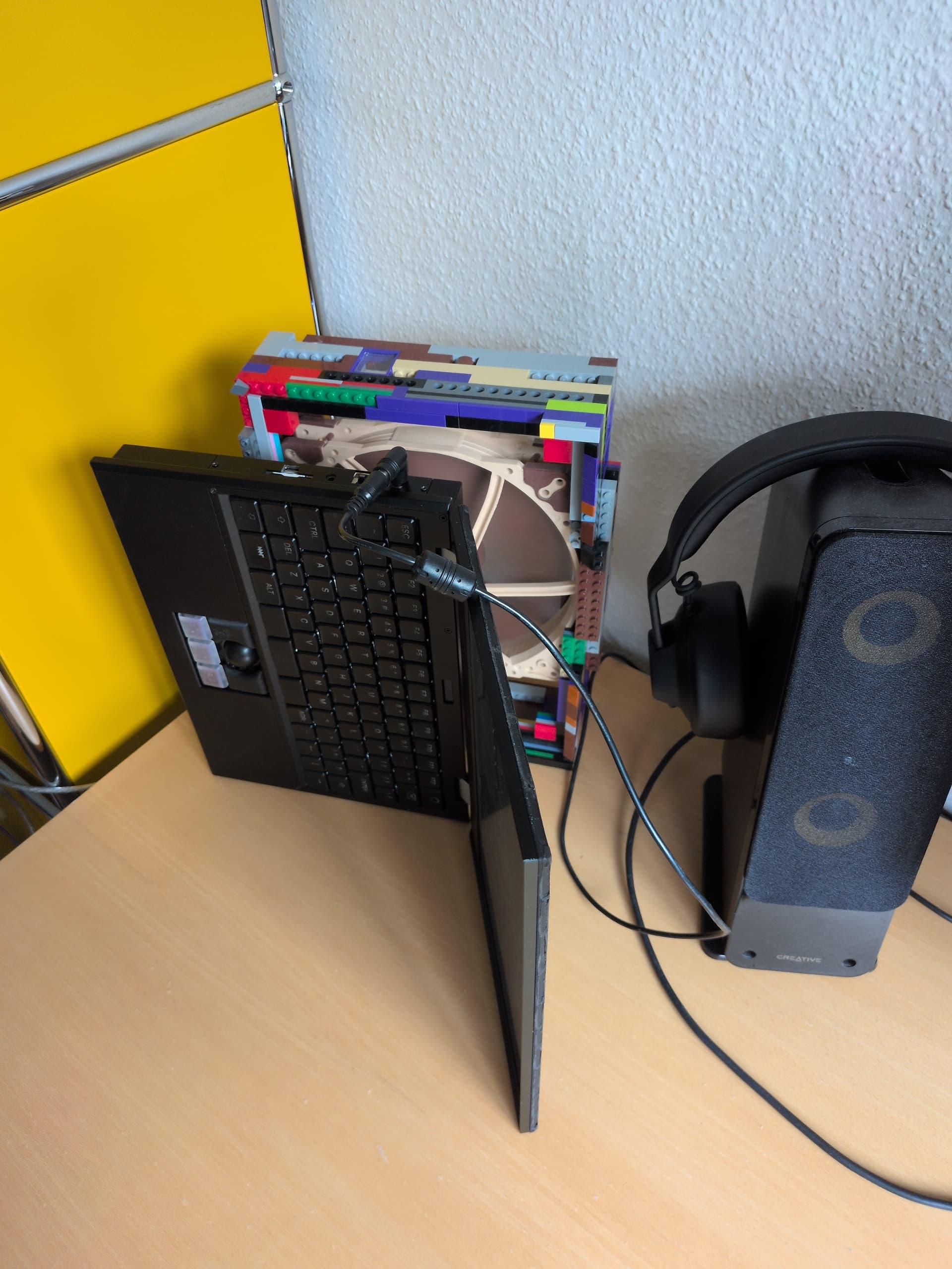

Here is my current set-up for that.

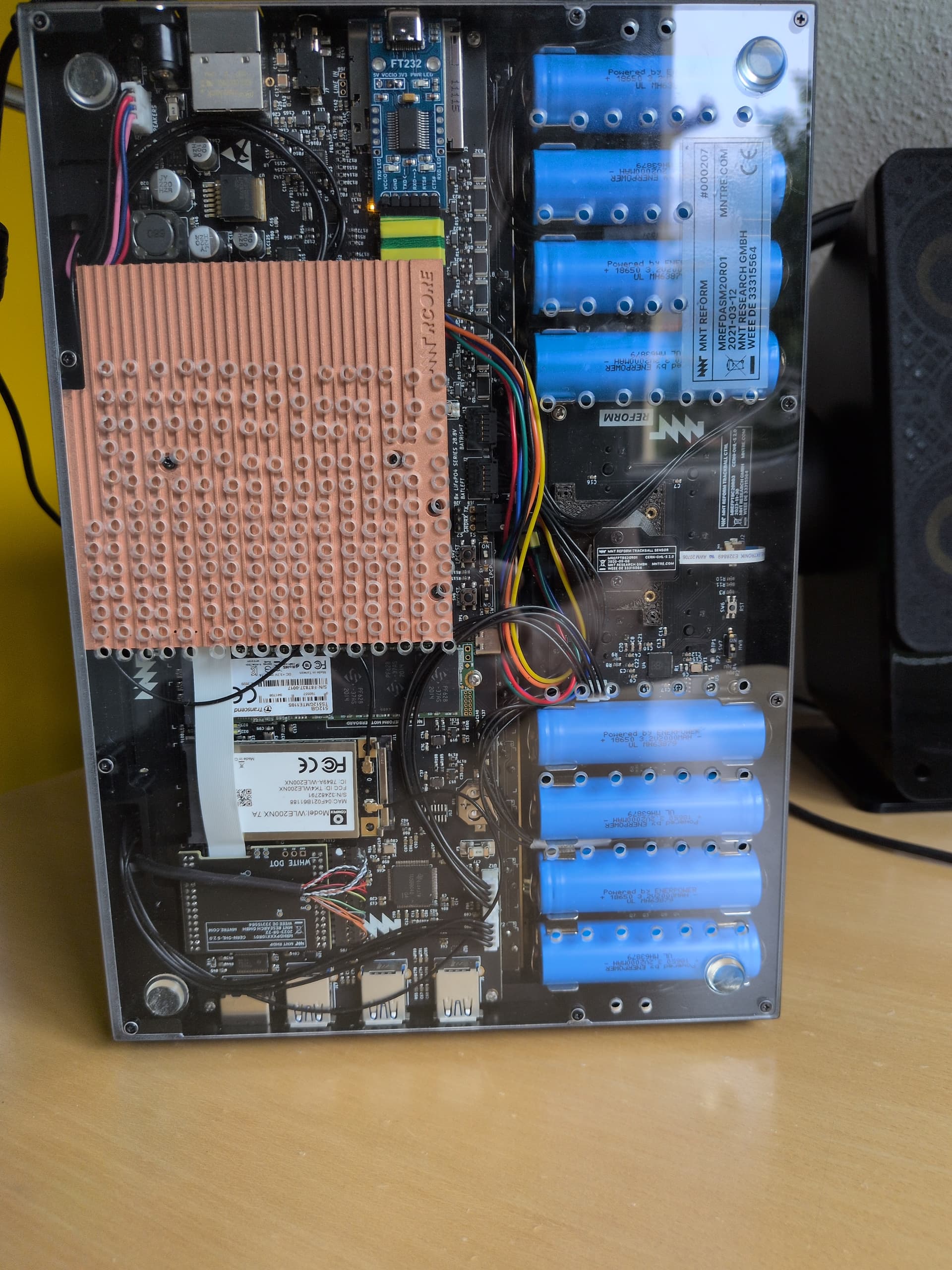

First, as mentioned, I drilled a bunch of holes in the bottom plate.

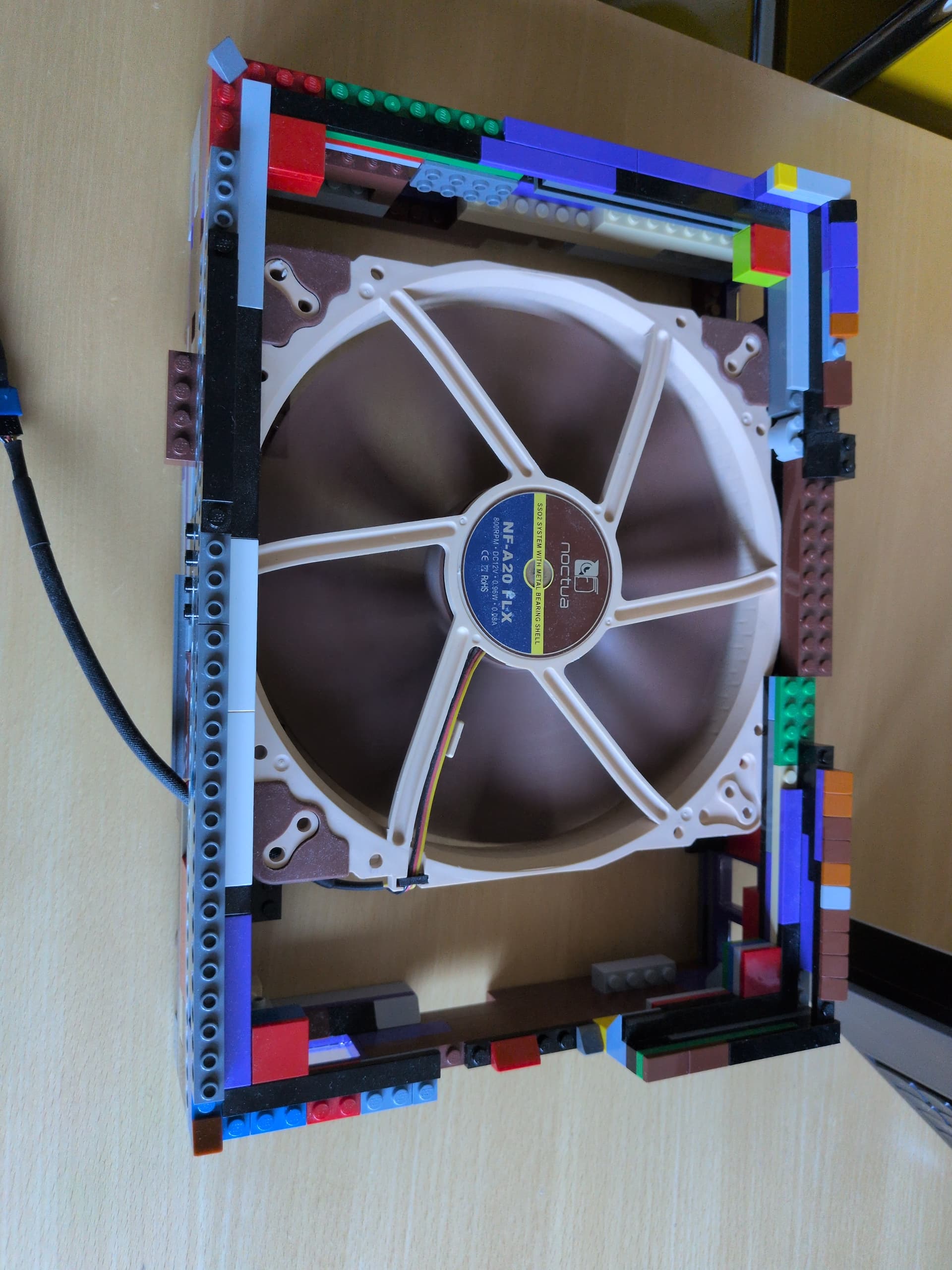

Then I built this stand out of Lego. It has a 200mm fan integrated. I am running the fan off USB, so just 5V instead of the 12V it is supposed to have. That way it is nice and quiet.

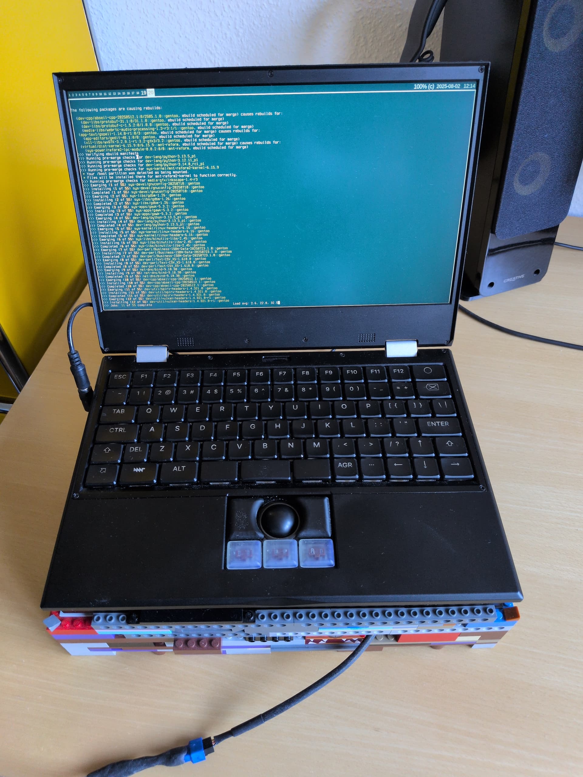

The laptop fits snuggly onto the stand.
But I have the impression it’s better if some air passes over the back of the laptop’s body. So more often than not, I run the setup like this:

Okay, in fairness, I thought of drilling through the plexiglass plate (presumably with the thing on the lathe so the drilling pattern looks somewhat regular. But I’ve drilled through that stuff enough to know that I’ll almost certainly end up chipping the exit side around a few holes.
So at some point, I think I’ll just replace it with a 3D-printed plate, that will include my spacer, and a socket to install a nice, large, quiet low-profile fan with a totally-independent thermostat circuit.

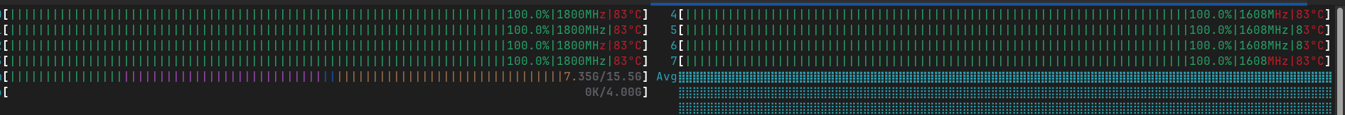

today i compiled the linux kernel on my RK3588 Reform Classic - the device was connected to on 65W USB-C power supply all the time and the battery status reported that is was continouosly charging at ~0.8A.
the cpu cores max out at 85°C, but the bigger A76 cores will not reach their max frequency after some time:
I assume its either thermal throttling or the TDP doesn’t allow a sustained full load.
According to Rockchip RK3588 Datasheet (p30) that sounds about right:
RK3588 Datasheet Rev 1.7
Parameters                     Symbol  Min  Typ  Max  Unit
Ambient Operating Temperature  TA      -20  NA   85   ℃

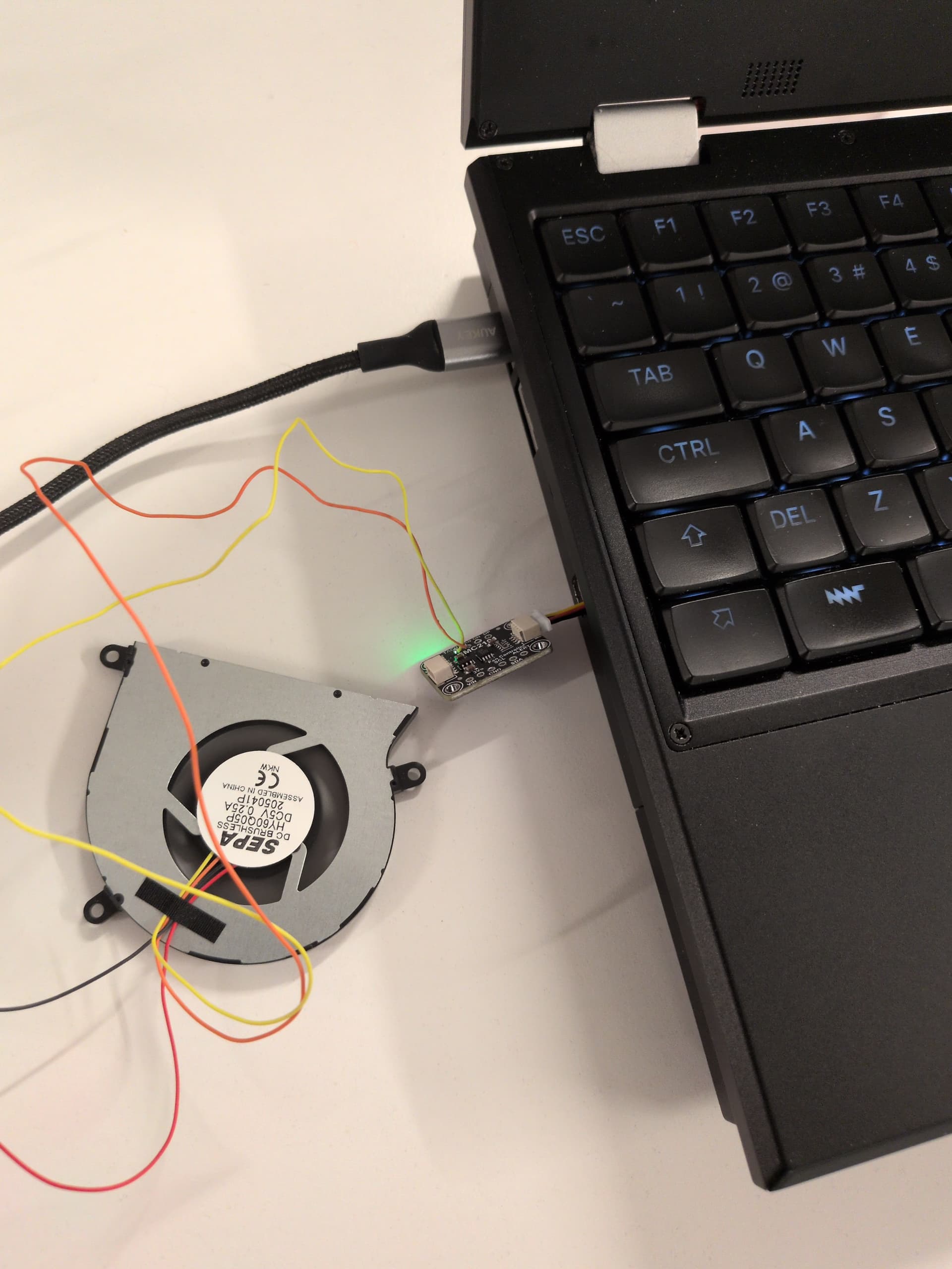

Just a quick update on this in case anyone cares.
I got my 3.0 mb. I’m able to connect anf control the fan using this Adafruit EMC2101 I2C PC Fan Controller via the Qwiic connector.
Up next is designing a mount for the fan and pwn controller.
Plan is to get 5V Power off of one of the USB headers.
