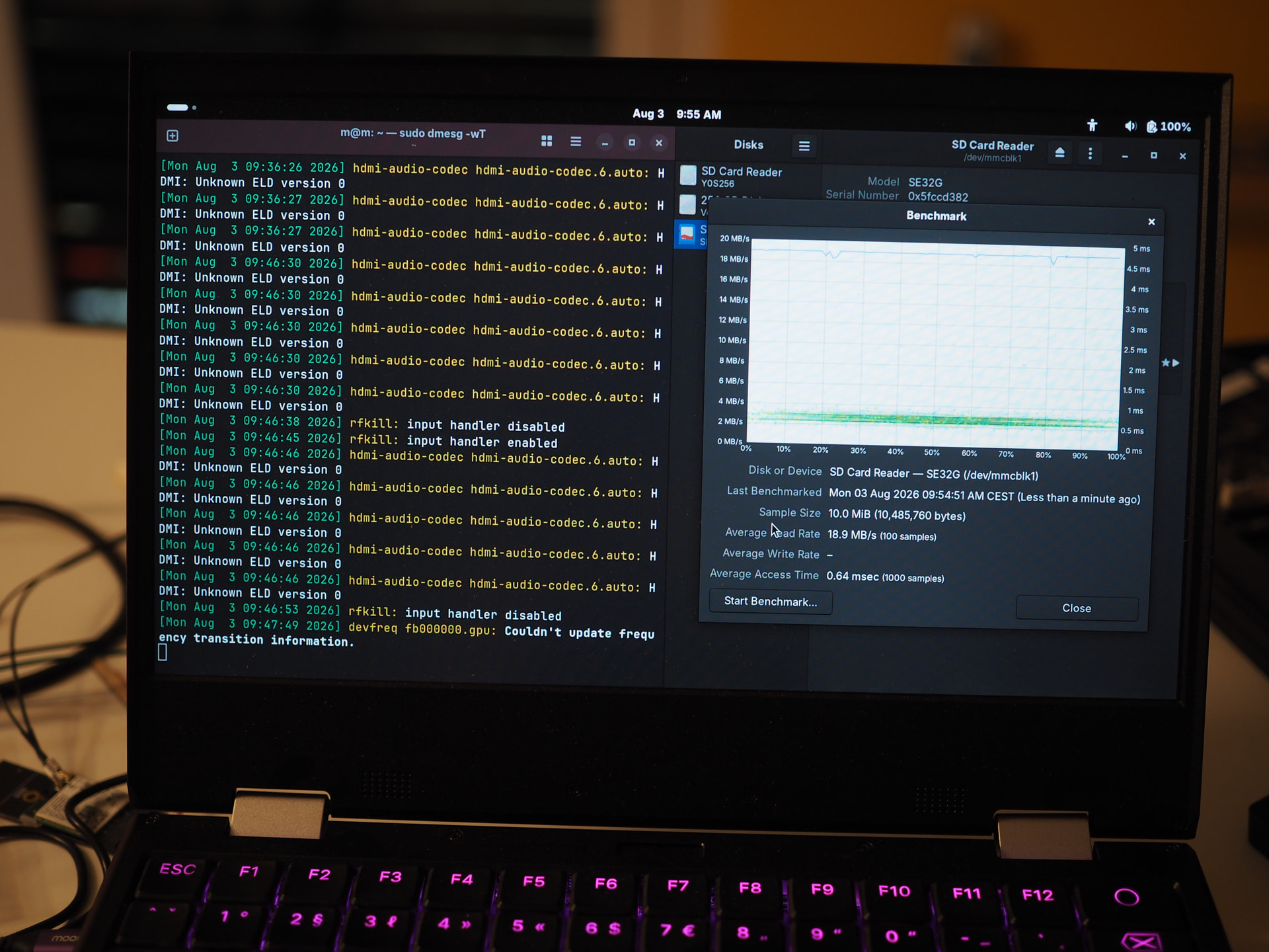

So… me and @meluzzy exchanged our sd-cards. I mailed them mine and they mailed me theirs. Long story short:
  • the SD-card which was broken for them works flawlessly in my RK3588 classic reform with mainboard 3.0
  • the SD-card which worked for me is broken for them with the known output on dmesg
Here is the SD-card of @meluzzy in my system doing the gnome disk benchmark without problems:

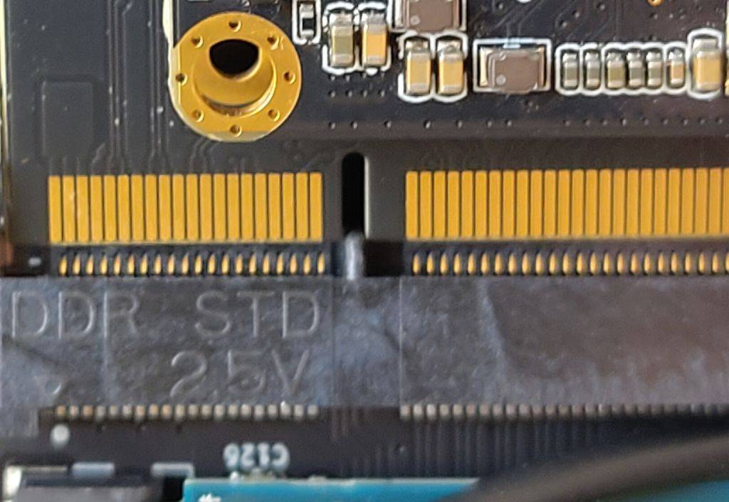

Let me quote what Lucy wrote about this issue on IRC:
15:21 <@minute> josch: ok, many thanks for spending your time debugging that for us :0 hmmmmm it might be
                an alignment issue of the rk3588 module
15:23 <@minute> josch: it just occured to me that meluzzy's issue could be a mechanical alignment issue
                on the rcore in the slot. this usually impacts SD card, but we have seen that mostly in
                pocket QA, but it would manifest in the same way on classic
15:24 <@minute> josch: some of the rcores were manufactured with a slightly "off" (like 0.1mm) outline
                and can be moved horizontally a little bit in the slot. if it's too far off then some
                pins are not connected
15:24 <@minute> josch: it's a PCB right? that goes in the slot. this PCB is cut out with a CNC machine
15:25 <@minute> josch: and this cut was slightly imprecise in one batch
Hmmm I see…
Should I try disassembling the RCore and checking if there is some way of making the pin make contact? If it is such a tiny offset maybe just disassembling it and assembling it back could fix it?
(PD: Btw, my name is also Lucy so it took me a millisecond to understand who was talking to who xD)
I would try that, yes. Since the contacts are tiny I don’t think there is much chance to see where a contact is bad but the process of removing the rcore and plugging it back in will place it in a slightly different spot and that might fix your issue. Note, that the rcore is the adapter board from the firefly icore module to your mainboard via an SODIMM connector. Taking that out and putting it back in is really easy. Removing the firefly from the rcore is a bit more tricky because it sits really tightly using a mezzanine connection (you can leave the firefly icore plugged into the rcore adapter board).
I tried but, no luck.
The offset seems bigger than I thought. I guess this is not supposed to look like this:
You might want to consider writing MNT support about this. Unless Lucie has another idea, it might be necessary to send your unit in for repair under warranty :confused:
Yeah, I will do that. Seems like there is nothing else I can do on my end.
I hope I don’t have to send the entire laptop over. Maybe I can send the R3 board or the card the CPU board sits on? Support will tell.
