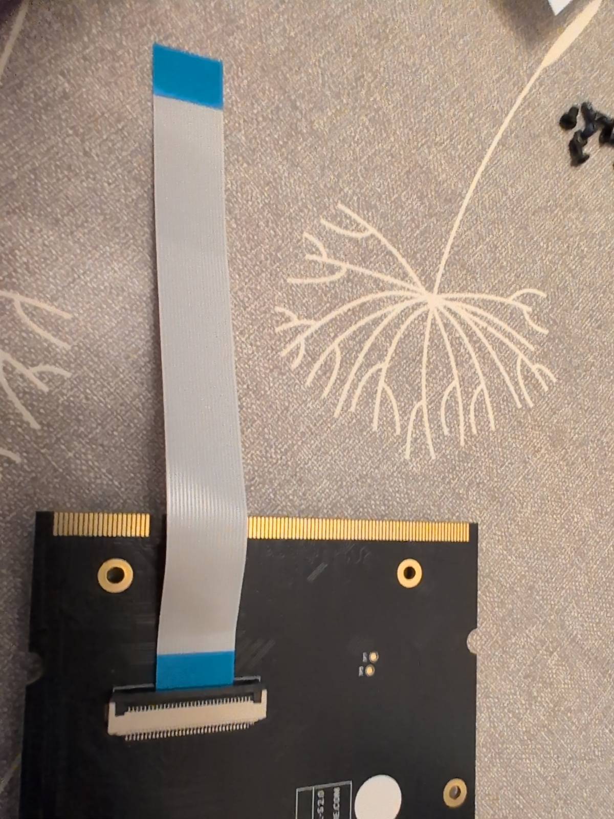

My upgrade kit arrived and I went to swap out the processor, I noticed my cable is narrower and the blue ends are not right when compared to the picture in the instructions, picture attached.
Is this ok, maybe I’m taking things to literally.
Hey, this is not the correct cable for that port. There should also have been a wide cable there for DSI. The cable on your photo is for the WiFi/BT connection. Normally it is preattached to the module, because it goes in between RCORE and iCore. Can you show a photo of all the items that you received in the upgrade kit?
Thanks for the heads up, I’m travelling on business today but will get a picture to you tonight or tomorrow.
Thanks.
Hey - sorry for the delay my end, got busy travelling, also I confess this was my fault, the cable was tucked in between some layers of the packaging so I did not spot it, the kit had everything I needed and I just wanted to update to say I love my RK3588 upgrade.
